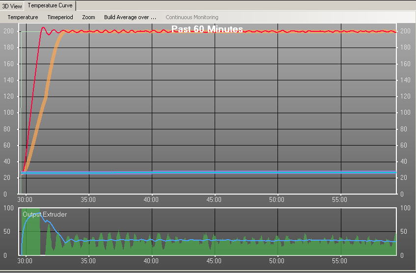

It takes 10 to 20 minutes for the full swing of temp's to stabilize. I use repeiter host, it has a built in temp monitoring real time chart with graphical display, highly recommended to use that for PID tuning, you see exactly what is being reported back from the firmware. No to mention I use the host program to send the proper G code for to start the auto config routine in firmware, wait until done, then use the data display window to read the results sent back from the firmware.rellik1000 wrote:Yeah,I tried autotune a few times,the values were pretty close each time,the temp would swing +/-20°,then system halt with "Thermal Runaway" error.Chip Luck wrote:The Configuration.h file Ultimaker default PID when used on my 3DP-12 HIC i3 was very un-stable. After running auto-tune (you can see the changes in the file) mine is now rock solid. Interesting...rellik1000 wrote:Just a quick thanks Chip

Again, strange. My config holds within 1 degree once stabilized. I assume you ran, and re-ran the auto-temp configuration using the proper g code as shown in the Configuration.h file and then edited the returned values and re-flashed the firmware? Very interesting indeed.

M303 E0 S200 C8 used to obtain auto tune values.
After a second look it does appear to vary closer to 1-2 degrees after 20 min or so using Ultimaker values.
The auto values never even make it that far and return "thermal runaway"after about 10 min or so. I never had to mess with the PID values with my first printer it just worked.

Again, interesting as mine did what you describe temp's swinging all over the place PRIOR to running PID auto-tune, mine then calmed down afterward the configuration change. Interesting, very interesting..rellik1000 wrote:M303 E0 S200 C8 used to obtain auto tune values.
