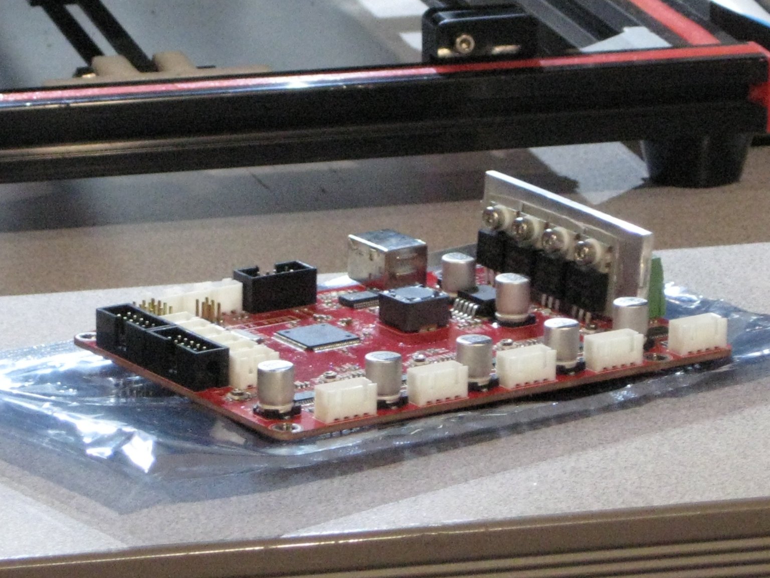

After the initial post, I went home and at my control board to see what it looked like. Well, it definitely wasn't pretty.
I ordered the new board and have been extremely happy since. It is smaller than the original board, but the screw holes are in the same place, so it can easily be swapped out. To give an idea on the size, the screw holes are in the 4 corners of the board.
When installing the new board, I realized just how much damage had been done as I wasn't able to unscrew the negative wire for the heat bed. The cable had started to oxidize too. I ended up having to cut the wire. Here is the final result of the board being removed.

The smoothie board looks great, and I definitely want to look into that. But...it was a little too much for me to consider at the time...especially when I'm looking for an immediate replacement. I'm looking into building a printer from scratch in the next month or two, so I will probably get one then. I can provide feedback on the board then if you're still interested.
As for the board that I got as a replacement, I'm super happy with it. I can definitely tell an improvement by how well the printer works, but that could also be because I was forced to upgrade the firmware...

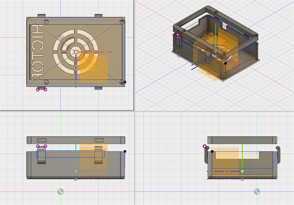

After purchasing my 1st Hictop 3DP11 I noticed that the mosfets were getting a little to hot so I added a heat shield (Heatsink).
Using the heat shield TO220 Heat sink Mounting Kits. The mosfet on my board that was getting hot was for the nozzle.
Contents included in kit (1 of each)
- Insulator
- Shoulder Washer
- Flat washer #4
- Hex Nut
- Pan Head Screw
- Lock washer, No. 4
I have also add a fan Bezel to cool the controller mounted in a snap together case.
Did not place holes for fan, drill where you want or modify before you 3Dprint to include the fan mounting holes.
I mounted a 60mm Fan drilling just 2 holes you may want more.
