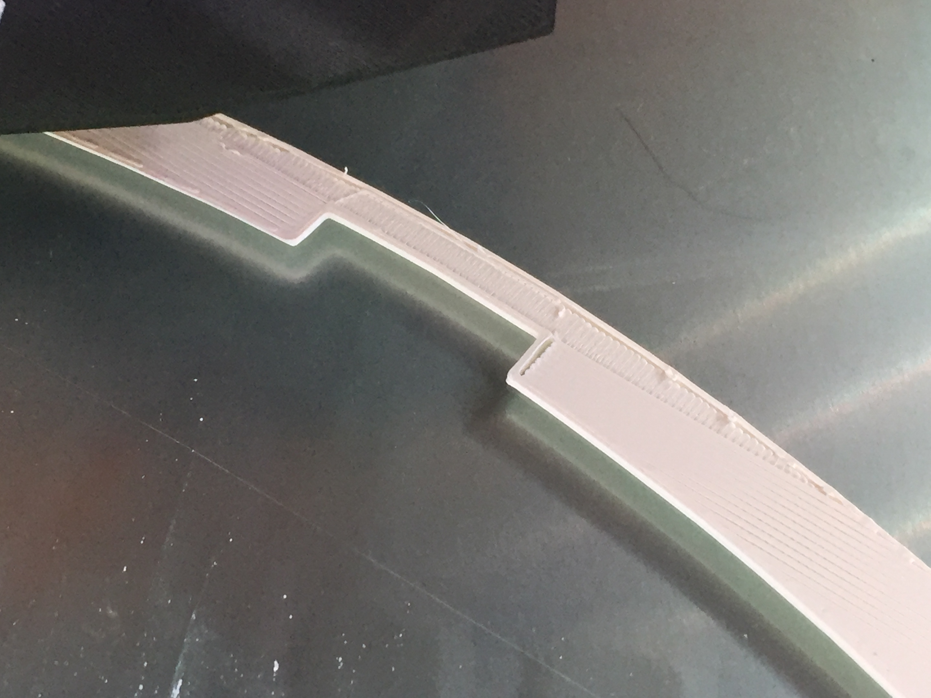

I wonder why this print on my UMO keeps missing this one lone spot.

Seems to me to be a combination of back lash and slight underextrusion. Check the overlap settings of your slicer. Cura?

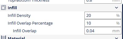

Here what it is, by default in Cura 2.3.0
Again, interesting that it was only that one spot

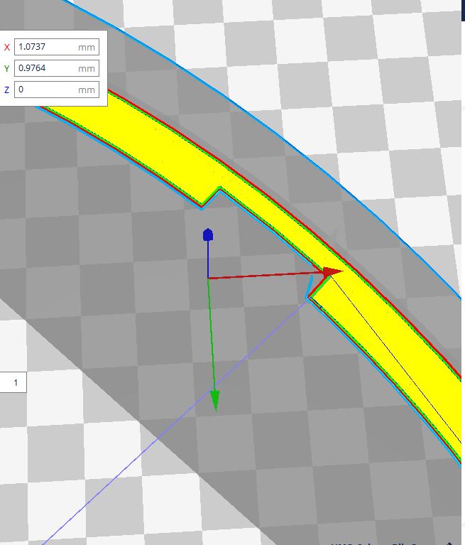

Here's a layer 1 screenshot with coasting on

Re: Missing spot
Post by Dim3nsioneer »
Repetier host and gcode.ws show the difference between print and travel moves.
