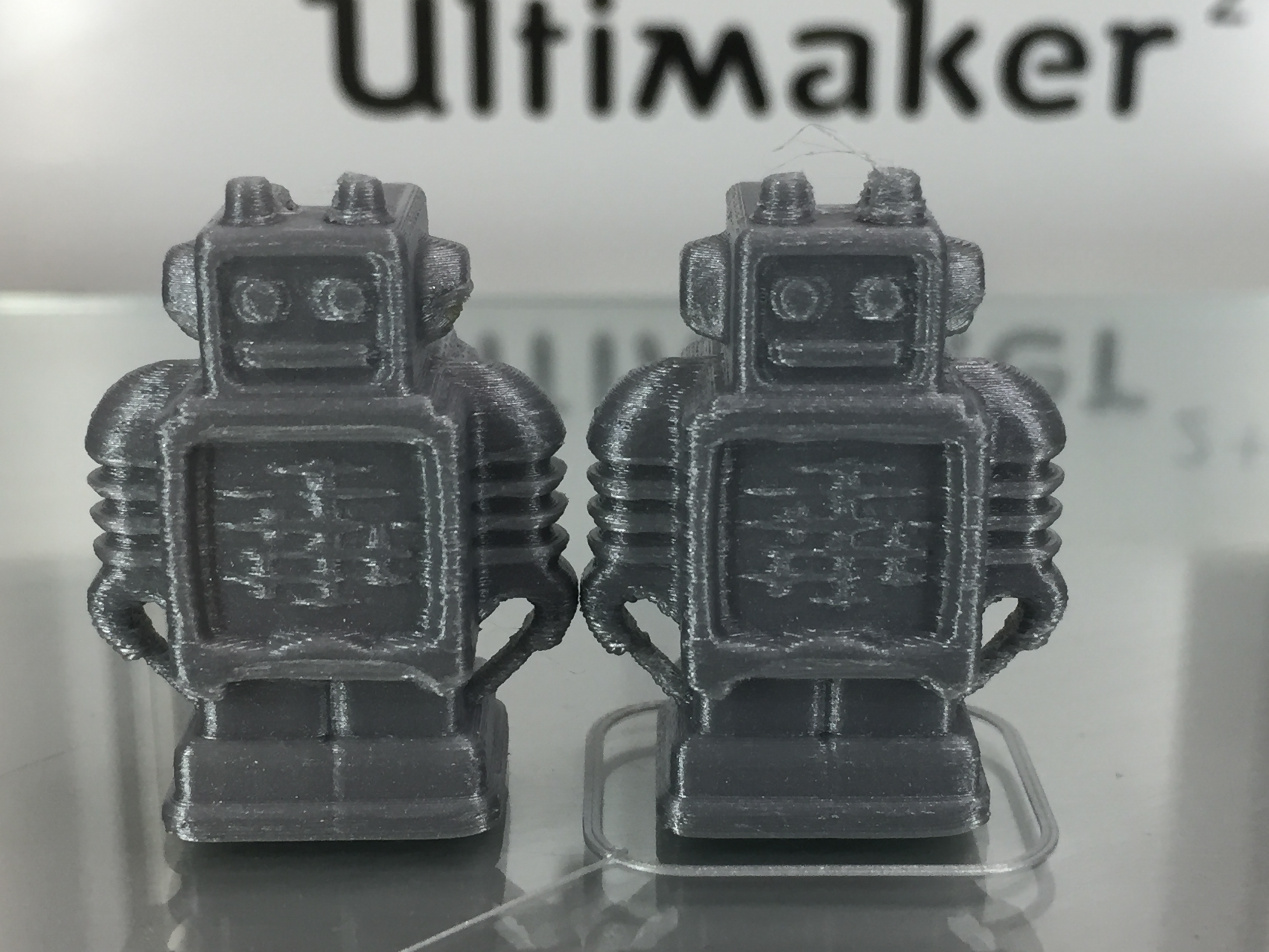

Ok comparison on my Ultimaker 2+
Standard 0.4 nozzle on left. Ruby on right. See any differences?
Same temperature on both? That could explain the excess of pressure on the ruby. Also that's the old ruby right? I have some from the latest pre-final ones and they print amazing. I should do a robot test to show...
I did find that with my ruby nozzle before I sent it back that i had to print 5'C hotter,
But there looks to be slightly better definition to the chest markings.
Although the left ear (it's left ear) has problems at the bottom!

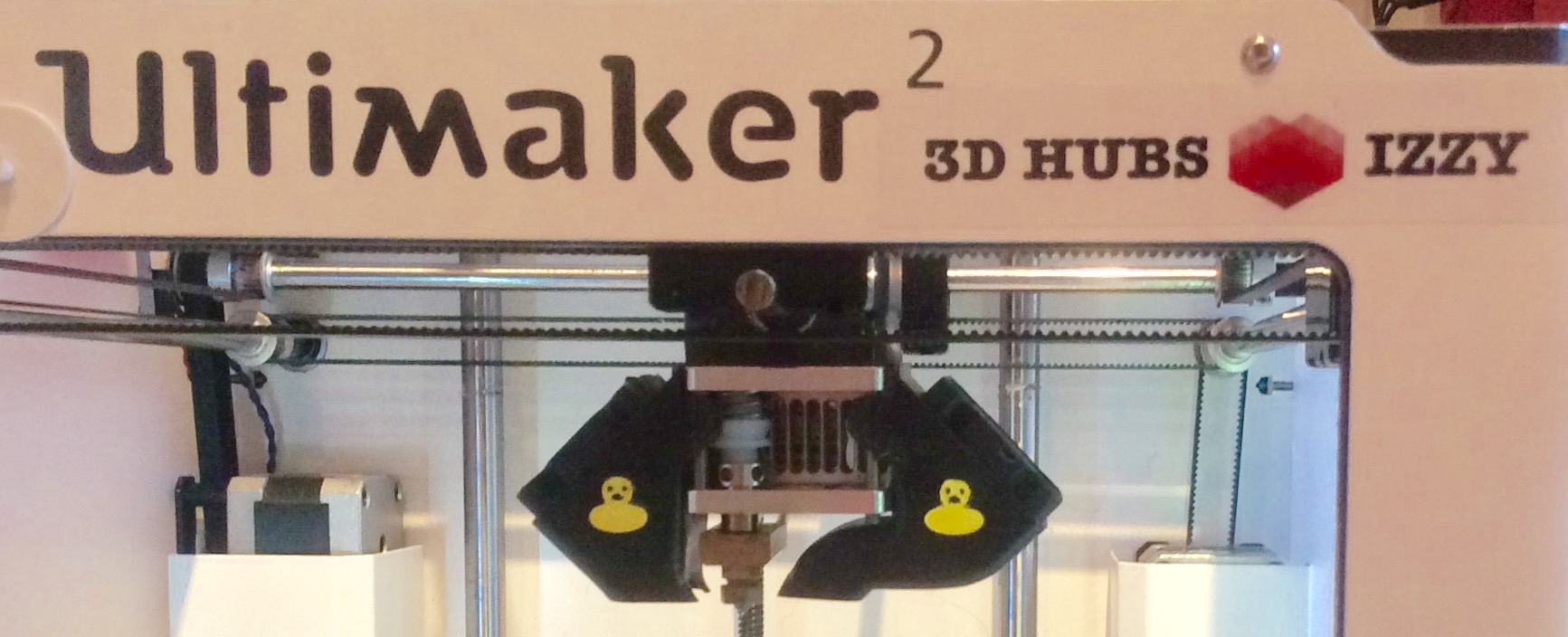

Prepare for an advert!
Have a try of my improved fan ducts available on YouMagine https://www.youmagine.com/designs/um2-fan-duct-v2.
Improved air flow reduces back pressure, can be rotated and removed out of the way of the heaterhead without dismantling for easy access, and can be adjusted in the height position.

Clearer lines, less fading of belly
