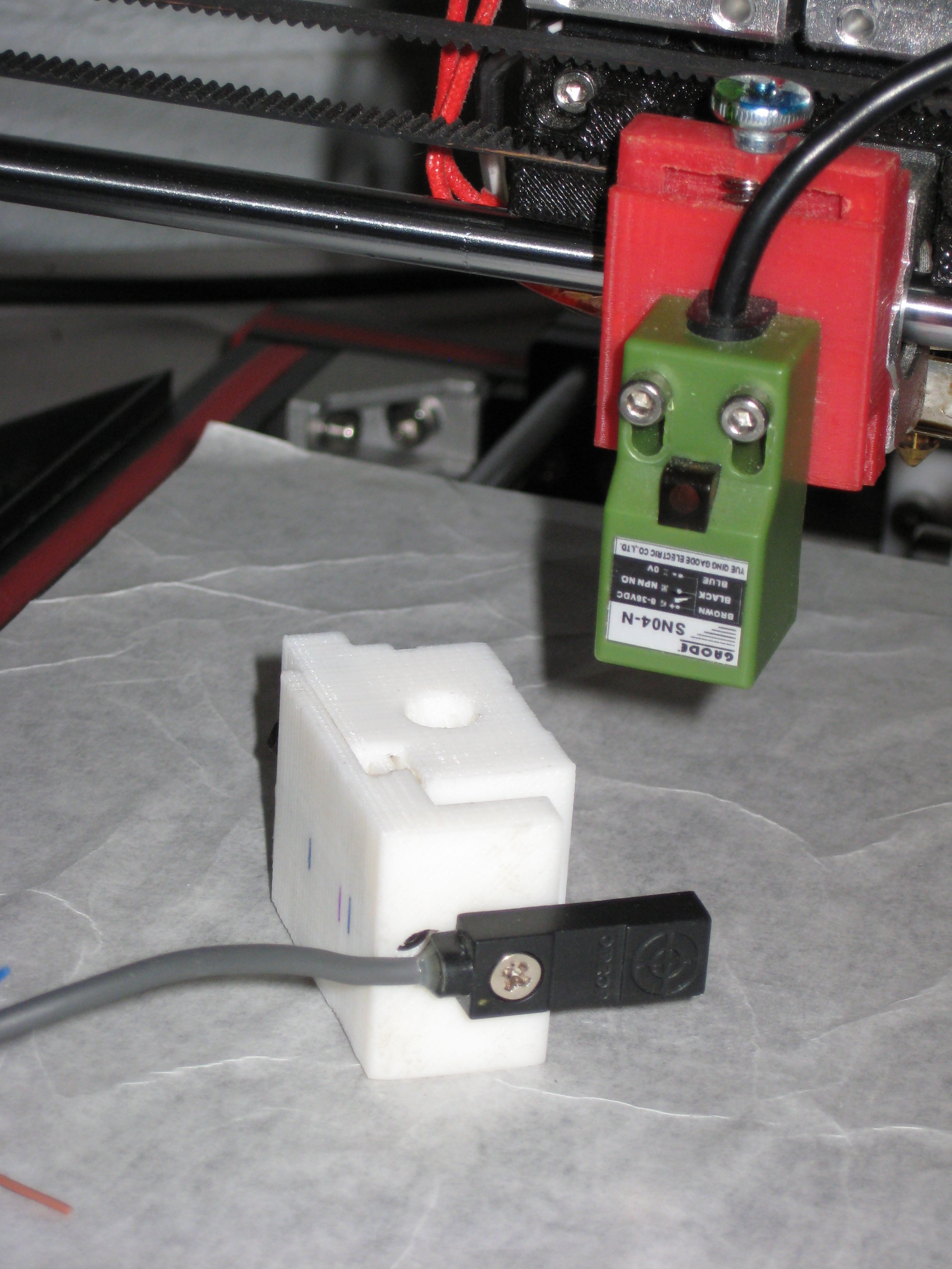

Printed thingiverse SC8_Bushing.stl bearings on the Y axis, just now starting work on the X Axis.
Included attachments of modified mount for the Front facing Proximity sensors with adjustable height.
Replacing the SN04-N sensor with a smaller one that I will mounted under the X axis bottom bearing, the SUNX GL-12F x 10 Proximity Sensor. The 7.1 X 12 X 27.4mm Dimensions make it easily mountable under the X axis bottom bearing attached to the rear of the Bearing with 10mm adjustable height limit, with influence of surrounding metal at a mere 7mm and sensing direction on the shortest dimension I should be able to mount 20mm behind nozzle. By far I believe this style senor is the best for the Hictop Aluminum 3D Printer.
Other Sensors to think about be sure to get correct Sensors for your 3D printer.
4mm sensors
TL-W5MC2, GX-F12A this is suggested sunxsensor replacement sensor.
2.5mm sensors
GX-F8A
sensor_mount.stl
(32.89 KiB) Downloaded 1602 times
Sliding connector.stl
(25.18 KiB) Downloaded 1488 times
Re: [SOLVED] - HICTOP I3 CALIBRATION ISSUE
Can you post pictures of your new mount in action? I downloaded the STL files and want to compare them with two I found on Thingiverse.
Posts: 1493
GrueMaster wrote:Can you post pictures of your new mount in action? I downloaded the STL files and want to compare them with two I found on Thingiverse.
Have not mounted it yet, but I took a Picture Of what I have (New Mount is White).
You can see that the New sensor will have a closer proximity to the nozzle.
Please Note: that the signal for the TL-W3M (NC Contacts) needs to not be inverted (false) in the software.
Where the software for the SN-04N (NO Contacts) is inverted (true).
Have tested the sensor having a 3mm detection should work after calibrating the sensor height.
After Adjustments and calculating center of the sensor will be behind 15mm.
NOTE: This is a thingiverse Mount I modified by henryarnold
