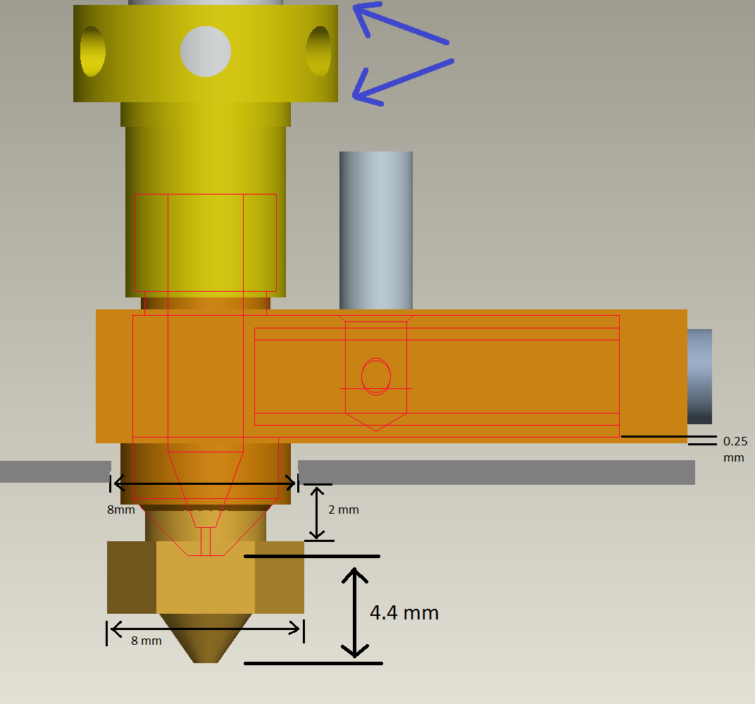

In fact, I was not aware at the time when I designed the Olsson block that that the STEP-files were public, so I measured up and made my own drawings of all componentsNeotko wrote:Also to what point selling an olsson is legal since is based on fitting the design on um files (I bet that at some point anders used the UM step files to fit it).
So, to what extent is ok to use open source stuff and sell stuff with it? Specially since Anders and Carl never shared their files (UM posted the olsson block step files when he did publish the um2plus bom).
You can see that in my picture that you posted earlier, the heat break for example is missing the chamfers that you will find in the UM-drawing: And if you would make a section of the original UM2 block STEP-file from Ultimaker it most likely would not be identical with the one in the picture (red lines).
Interesting that a STEP-file of the Olsson block has been published, I was just wondering if they did that the other day but forgot to checkNeotko wrote:So, to what extent is ok to use open source stuff and sell stuff with it? Specially since Anders and Carl never shared their files (UM posted the olsson block step files when he did publish the um2plus bom).
I don't see any problems with using the STEP-files to design additional components even if I did not do that so far, isn't that exactly the whole point with releasing the files? To lower the effort required to create accessories?
And the vast majority of Ultimaker users neither have the tools or the skills to manufacture things like an Olsson-block, so if I would upload it as a Non Commercial Share Alike I am not helping them, they would just immediately ask where they can buy it.
Uploading it that way rather than selling it actually blocks development, since no workshop will make a single block for them and since they can not make 100 blocks and sell the remaining ones then.
The drawings that Ultimaker are releasing are not very useful by the way. As it is just STEP-files they are difficult to work with if you want to modify anything, there are often details missing and the don't hold any information on tolerances for manufacturing.
So as soon as I want to modify anything, I simply make a new drawing, and I often find it easier and safer to just measure up the object in real life rather than taking for granted that the STEP-file from Ultimaker is correct.

Regarding designing, making new CAD-files from the components of the UM2 hotend is not terribly difficult, I think I only spent a few hours measuring and drawing all the components.
As long at things are symmetric and have simple geometries it is easy.
