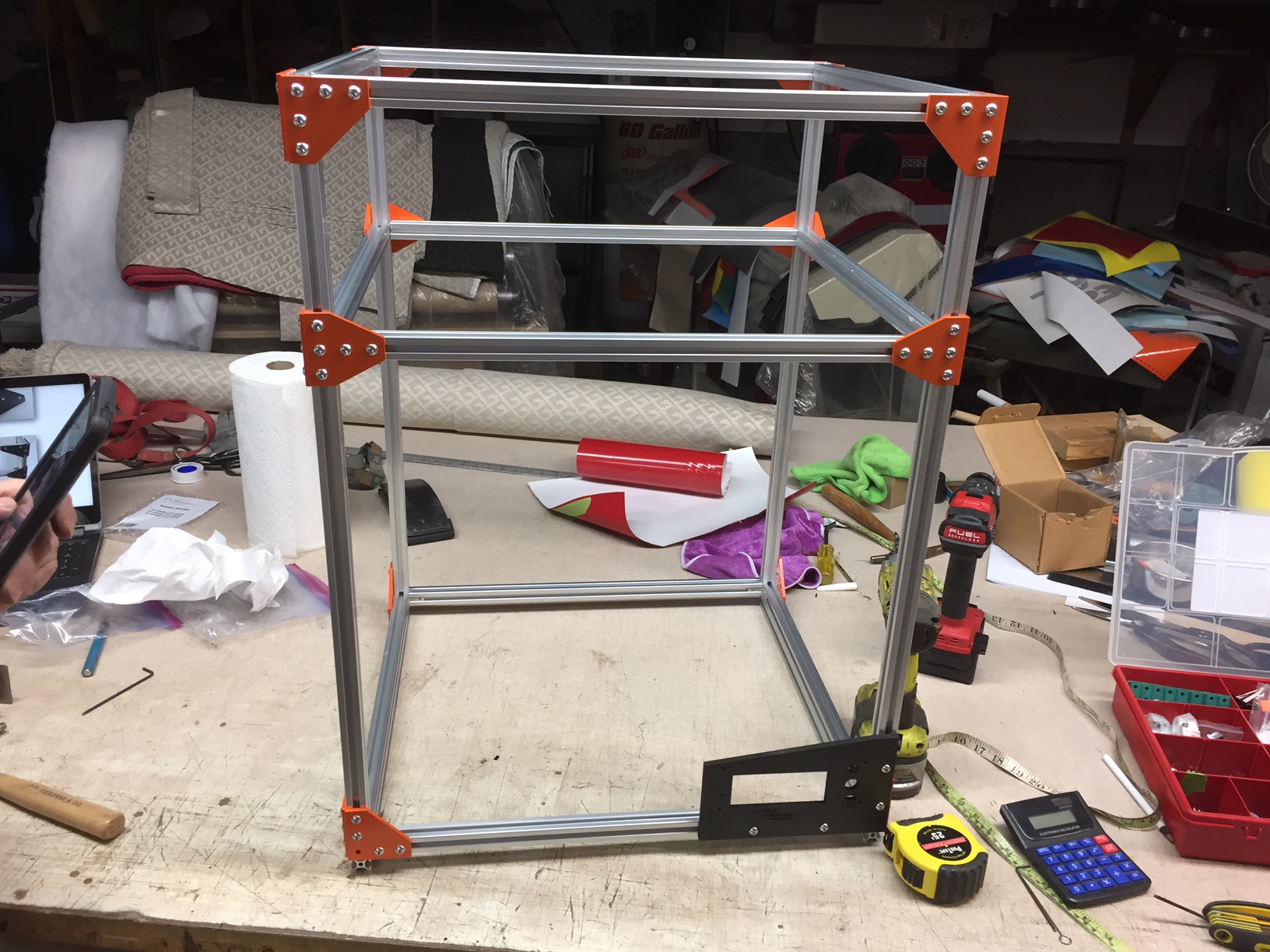

I've had a fun weekend
I've discovered two Ultimaker 3's running is a pretty big power draw...I think they are the source of some of the flickering lights and power anomalies I have had while they do a print job! The power specs on the website show the power requirements are the same but in reality, I am starting to think it's much higher. It's that or I need the Ghostbusters to eliminate the ghost!
I also had some time to piece together the frame of the Folger Tech FT-5 with my friend, Fred. The instructions are pretty bad and the bags and bags of accessories are just stuffed in large bags. A lot of time is wasted sorting through bags of screws. On one hand, sure, it's a cheap printer kit. On the other, it would be nice if they did what the Ultimaker kits do...everything is individually bagged with a label stating what is inside. And the directions are poor, at best. Again, it would be nice if they used drawings (again, like the Ultimaker instructions) versus low res photos. We wasted a lot of time scrolling back and forth trying to figure out what the directions were trying to describe and the end result.
Despite all of that, we got something done.

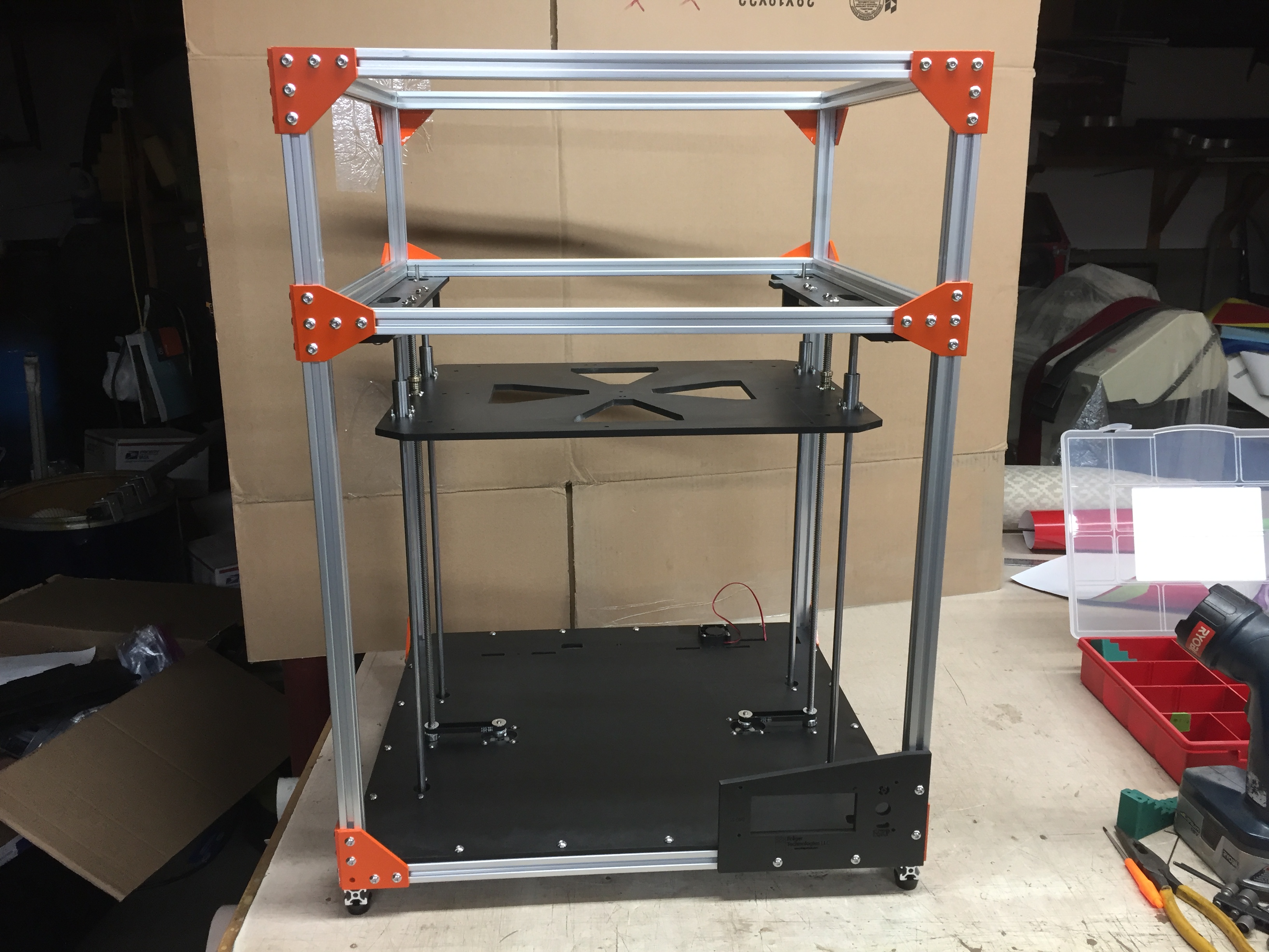

Although I would really prefer aluminum to replace the melamine pieces, for now, I am building with what is included (minus the 2020 corner and T pieces). Waterjetting the pieces like the baseplate and such would cost as much as the kit.
I am leaning towards just building it stock for now, then upgrading as I go. Perhaps gain some experience on this build, upgrade...or maybe buy another and have that be with the Duet Wifi, touchscreen, etc etc
Right now, I just really need a large printer making large pieces

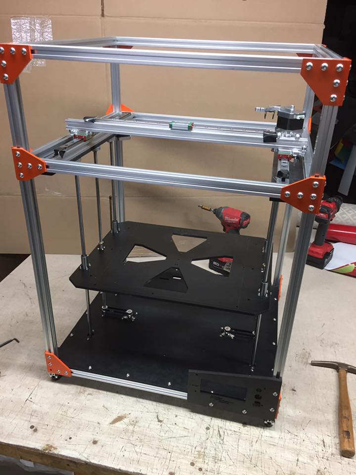

A bit more progress

The gantry setup was a lot more complicated than it should have been! I can't tell you how many times I zoom into the pictures in the instruction guide, hoping for better details.
Anyways!
A few curves thrown at me tonight since these pieces were replaced by some of the 713maker versions. I kept having to check what the 713parts were in relation to what they replace. (I wish, for quick reference, there was a picture with a label on what each aluminum part was) While I eventually figured it out, the story of this build seems to be wasting a lot of time searching for detailed information.
The roller bearing on the top of the gantry (that will be home to the print head) is grinding very badly. The others are super slick and smooth
https://youtu.be/g1WytuycDFo
But despite that, I shoved forward a bit more progress!
Anyways!
