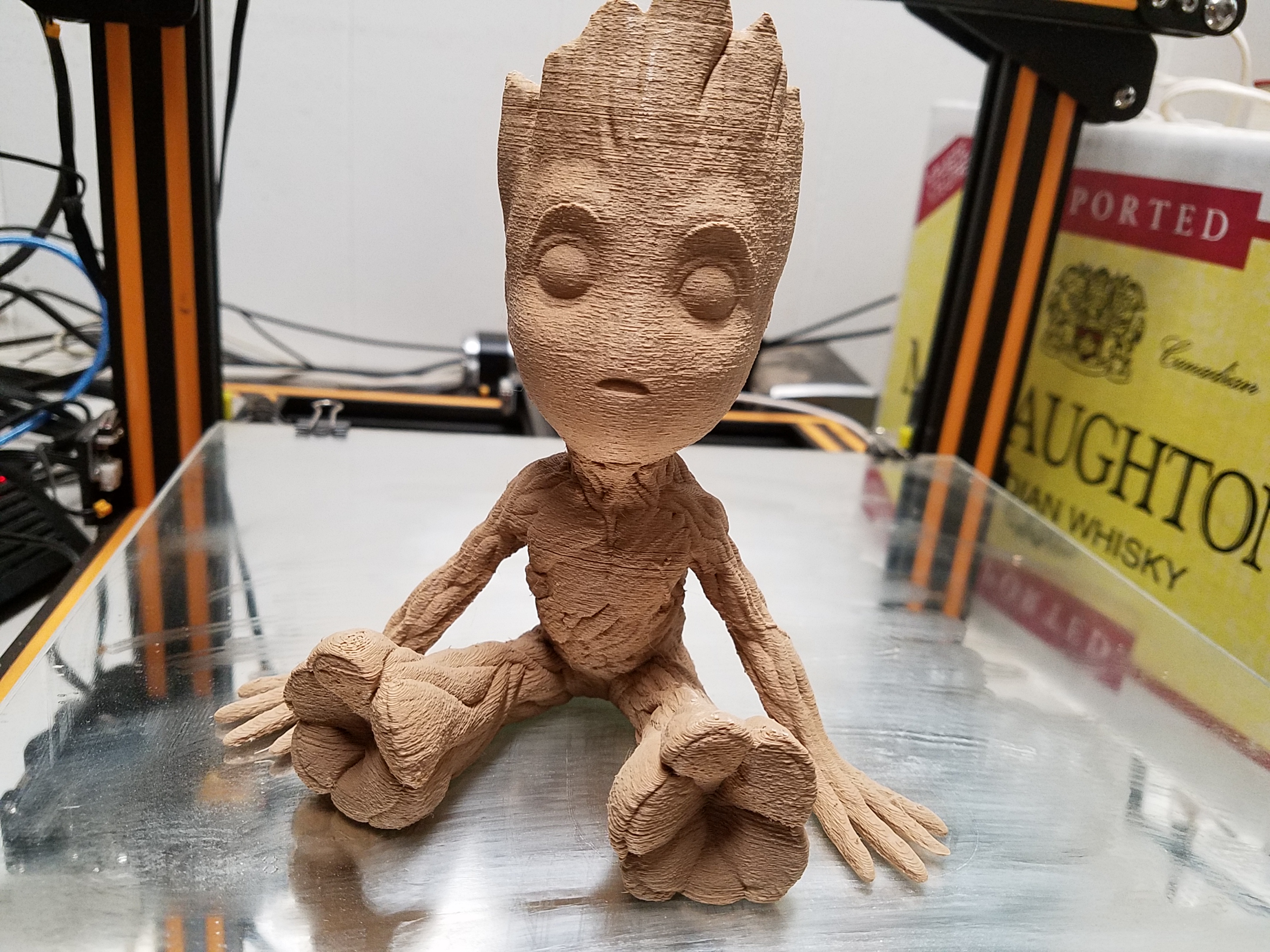

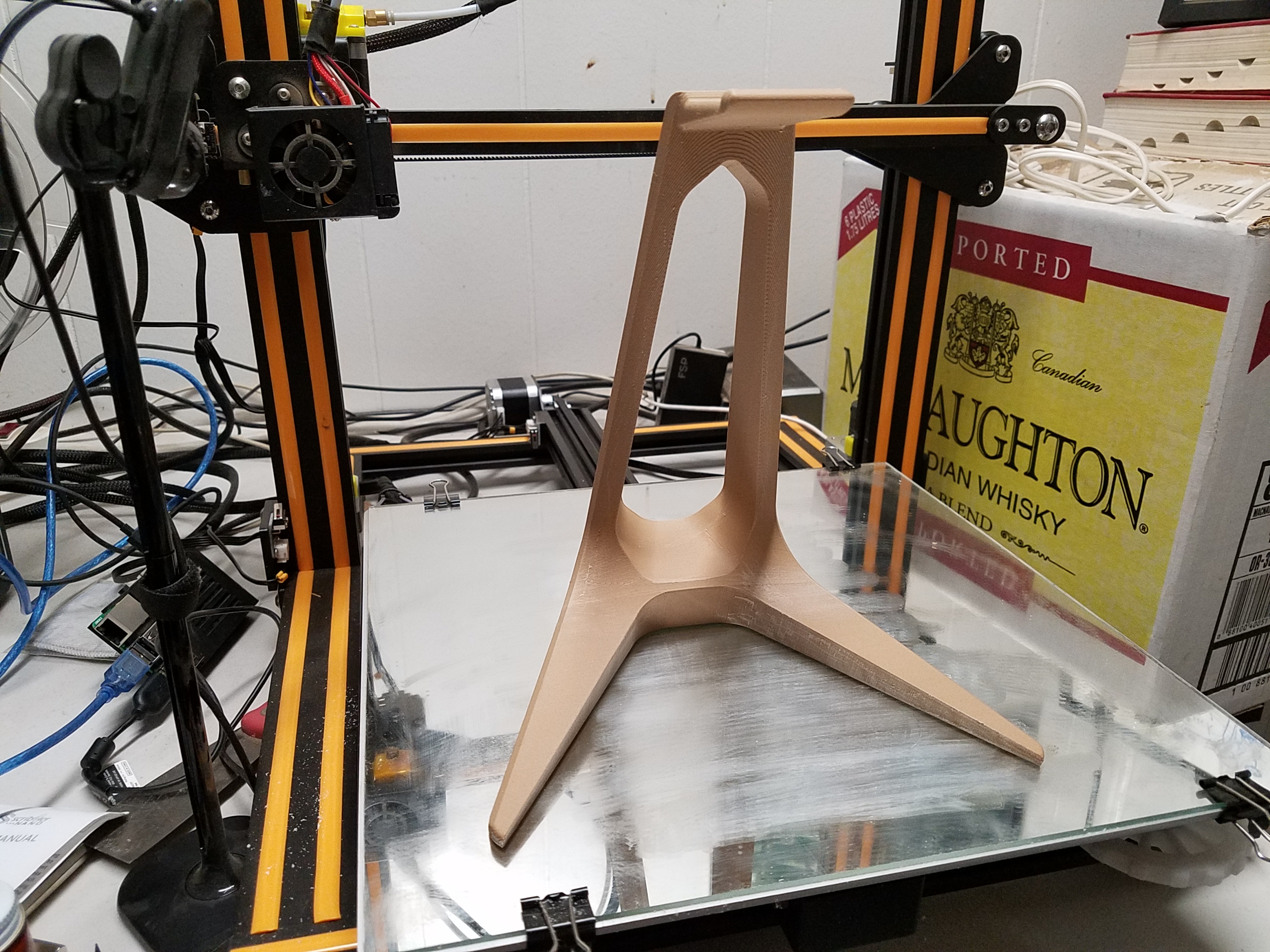

Re: Best wood-fill filament?
I printed a headphone stand and Baby Groot this weekend using Hatchbox Wood filament. Looks great. I didn't even run a test print after loading the filament.
