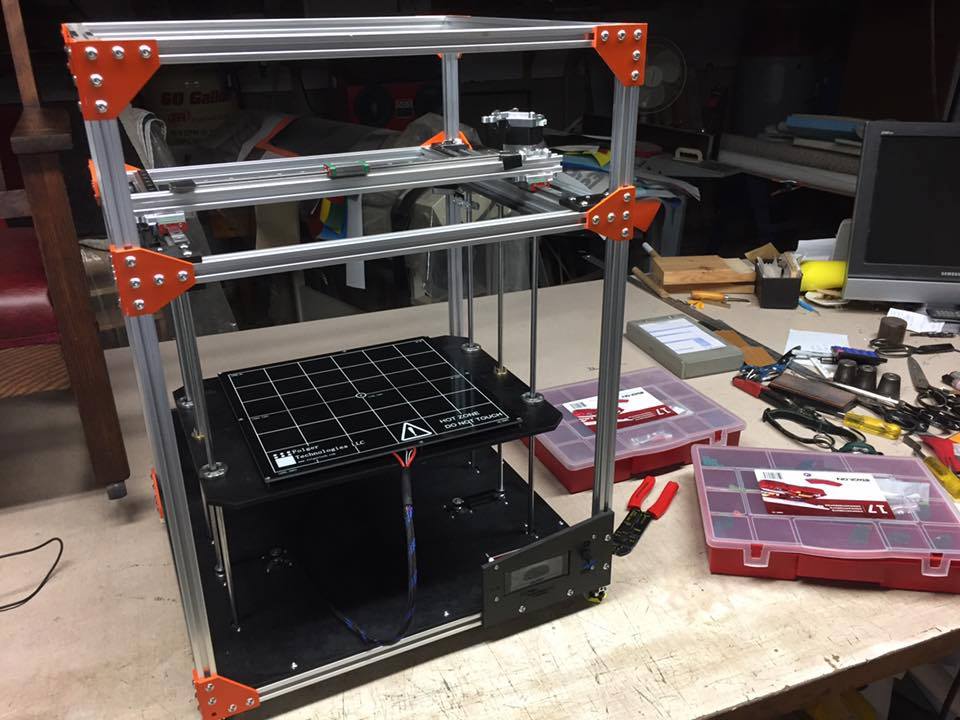

Xeno wrote:Here is my setup now, I just installed the Aero and still am deciding how the fan duct should look :)
Checking out the corner pieces you used...interesting
And you have the rail flipped forward instead of vertical?
Xeno
Posts: 105
Re: Paul's FT-5 Build
Post by Xeno »
The corner pieces are extra support because I made my FT5 larger, I wanted to minimize frame movement.
flipping the rail forward is the best method to loose any wobble, I loose a little bit of Y-size but it is worth it.
and more easy, I would have to shorten the rail to fit underneath.

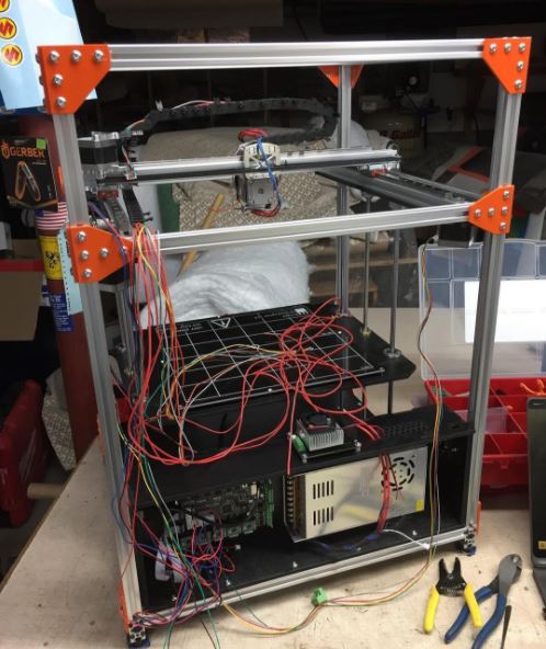

Here's where I am now...now on to wiring!

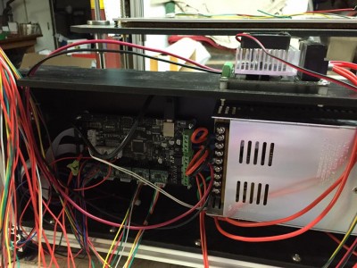

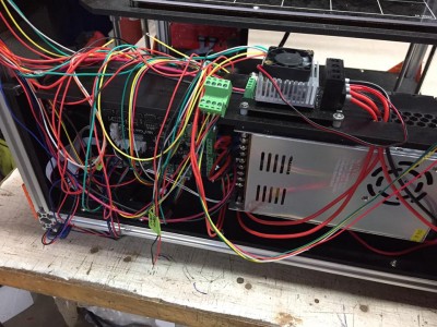

So not too much to add to my build status...lot's of wiring!
A few notes on that progress pic...
* Again I curse the instructions for making some steps harder than they need to be and some steps just really need that one last step, to affirm you are doing something right!
* I used the provided silicone wiring harness to extended the pancake, aero fan, thermisistor, hot end and so on to the rear. I added a 2 wire length for a future part cooling fan. I really wanted to use the Igus chain flex but given I would need additional connectors (Dupont style it seems) already on the harness, why not. I figure if the ehternet guys are fairing ok with their wiring, the silicone should do good too.
* I purchased a MOSFET and installed that on the top piece of electrons box, using some 1/4" plastic stand offs I bought at Lowe's. There was conflicting information on the Fugatech video about if this would work on the shipped aluminum bed. He uses a silicone bed and what came with his kit a year ago is different than what I received in March (and to date).
* I ran out of silicone wire and purchased some more. Also, since I am plugging many wires into screw down connections, I thought back to the Duet Wifi documentation I have been reading. They advised using Bootlace Ferrule connectors on the wire, then inserted into the board connections. I read a bit about those and think it's a great idea. I sourced a crimper and 800 connectors on eBay for under $30
* One of the builders posted some before and after print pictures of without direct stepper driver cooling and with. It's an impressive image and showed great gains in details if the drivers have a steady cooling airflow on them. Following his lead, I have purchased a 120 mm case fan. I'll cut a large hole in the electronics rear door for it. That'll be a lot of airflow in there!
* A few mysteries I need to resolve are the esteps for the pancake motor/Aero/Titan combination, the PID tuning and a good part cooling fan solution.

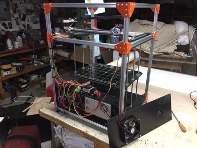

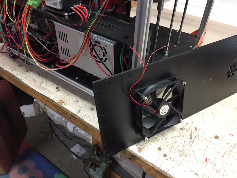

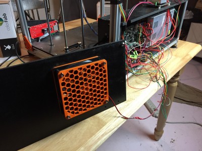

A bit more progress...
* Corrected pancake motor wiring, an alert fellow builder caught that!
* Made use of the bootlace ferrule connectors and crimper for the 14 awg wire. I found I had to trim the connector a bit to not stick out of the screw down connectors
* Got the JST connector on the thermosistor, so that's now plugged in.
* With the instructions being so poor, I am back pedaling a lot, seeing what I have missed. There doesn't seem to be steps that show what cable to use to plug the X motor in. We used the including wiring harness and connectors, but the connector won't stay in place on the other end....rather frustrating.
* Using a 4.5 inch hole saw, cut out a hole in the back panel cover for the 120 mm fan. The electronics will sure get a lot of air, being about 2 inches from the fan itself! But if a stepper overheats...it's by God's will !
* Still need to connect up the Z motors. I am starting to wonder if I have all the connectors I will need!
A few pics...

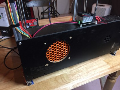

The Ultimaker 2+ has been busy printing pieces for the FT-5! These grill pieces for each side of the 120mm case fan
