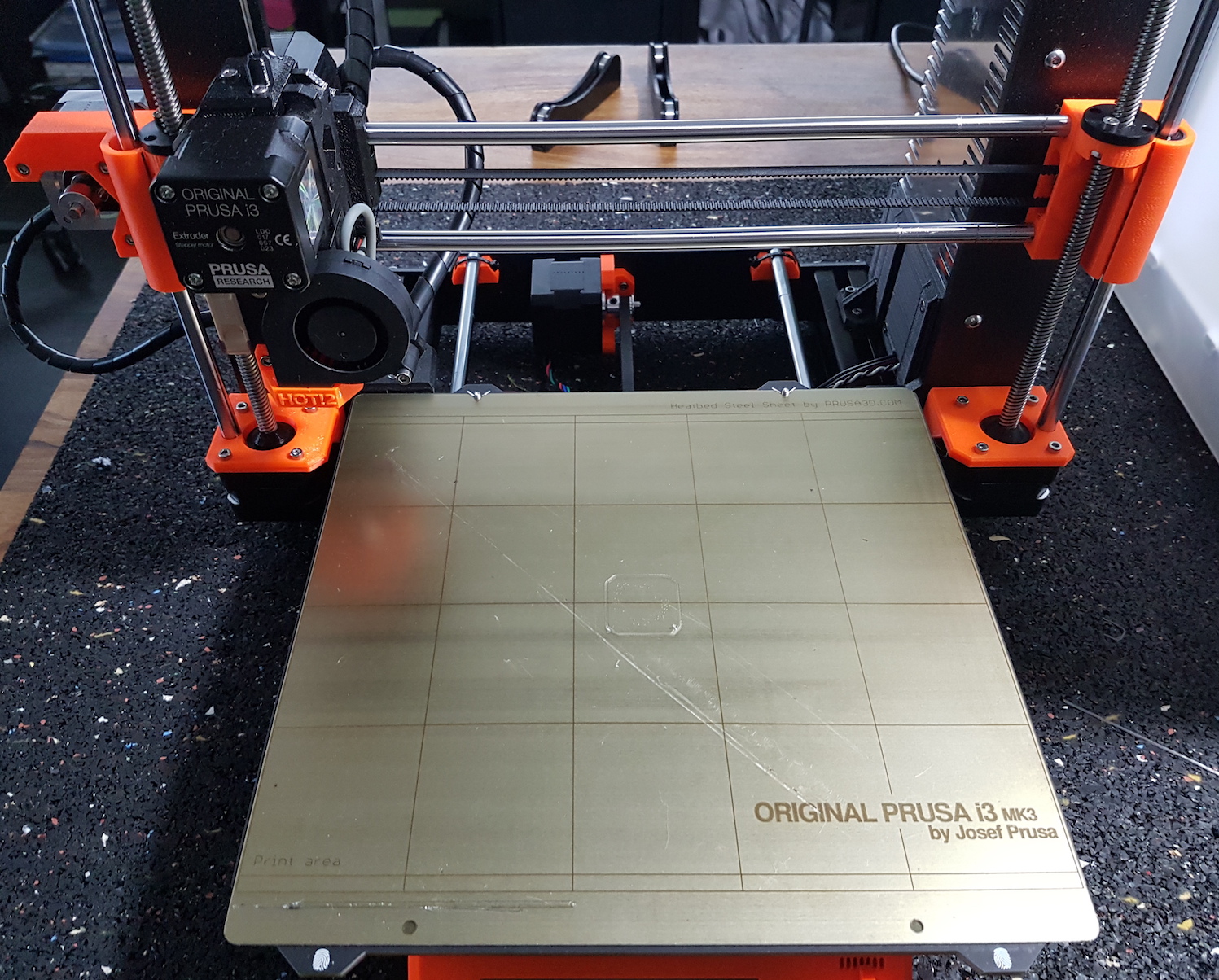

I spent quite some time 3d printing this weekend. My Prusa MK3 arrived on Friday.
Initially I was really happy with it, it seems like top improvements all the way (filament detection, the detachable heatbed-cover, collision detection on the steppers, extremely silent).
Noticed fairly quickly the carriage belt wasn't running really smooth, it tilted back and forth (
Managed to fix that somewhat by moving the pulley on the stepper, but it's not perfect (this is something that should've been picked up during assembly, it was literally scraping particles of the belt).
Since then a component in the PSU started vibrating. 15 minutes after that stopped it was replaced by a pretty loud hum.

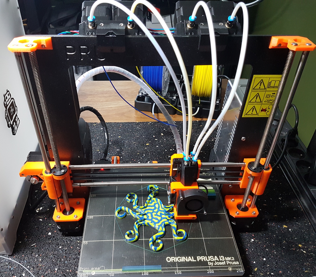

Meet the #prusa family:
MK2S-MultiMaterial:
MK2S-MM
MK2S-MM
MK3:
MK3
MK3
MK2S will normally be getting the heated bed and filament sensors upgrade as well shortly, as soon as they start sending those out.
(Ow, and between the 2, you can see the sides, is my trusty old UM2 that became a UM2+ a while ago)

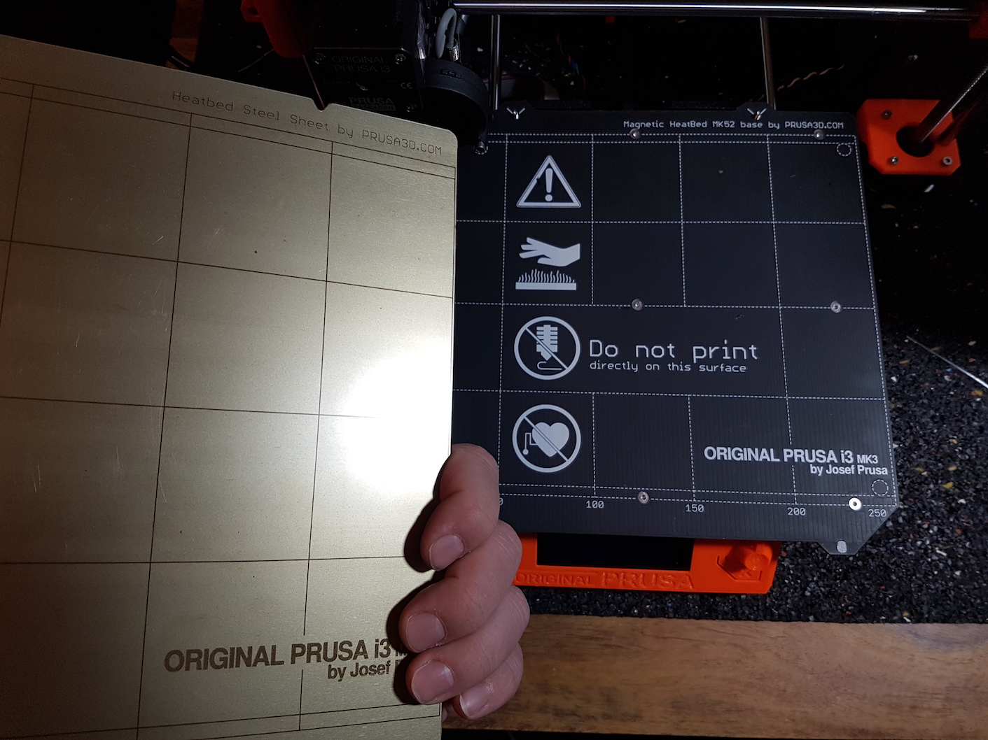

I like the PEI sheet itself and the quality it gives, but on the MK2 you actually need to disassemble the complete heated bed assembly, put the thing in the freezer for an hour, break off the PEI sheet and then use limonene to peel the glue. All without breaking the heated bed. (like I said: nightmares)
The new magnetic attachment means you just take of the entire plate, exposing the actual heated bed. So they made the PEI a consumable.
There are different ones: You have regular sheet metal with a PEI sheet on both ends, or PEI treated metal in 2 finishes. One is really polished but not very scratch resistant, the other is sturdier. Depends on what you want. Think they even have "regular metal on which you stick whatever you want".
It's pretty cool... If you want to continue printing without cleaning, turn it around.
If you don't want to wait until everything cools down until the print comes lose: buy a second sheet, replace it when the print is done and continue printing. That is something I really like... Waiting for that bed to cool down between prints is a b*ch :)
If the print doesn't come loose, bend the sheet a bit.
You do have to watch your fingers though, those are some really strong magnets and it pinched my thumb pretty bad the first time because I didn't expect it :)
