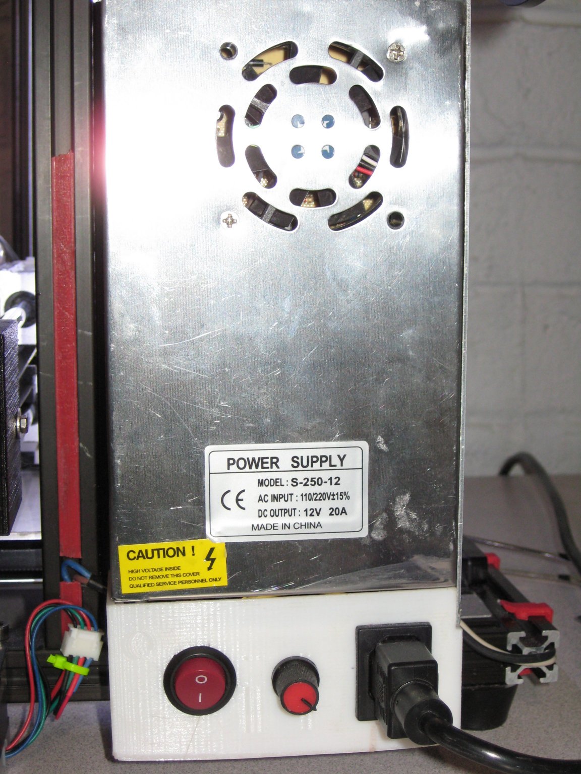

Oh! You need a power switch this hard wired power cord is for the birds.
I dissembled a bad ATX supply took the Power cord connector and used in a 3D Printed Power Supply connection Cover.
You need wire large enough from the power supply to the controller, the stock wire is nowhere large enough.
The 2 wire Power Cord Supplied is another wire that is inadequate, use an old 3 wire Computer power cord.

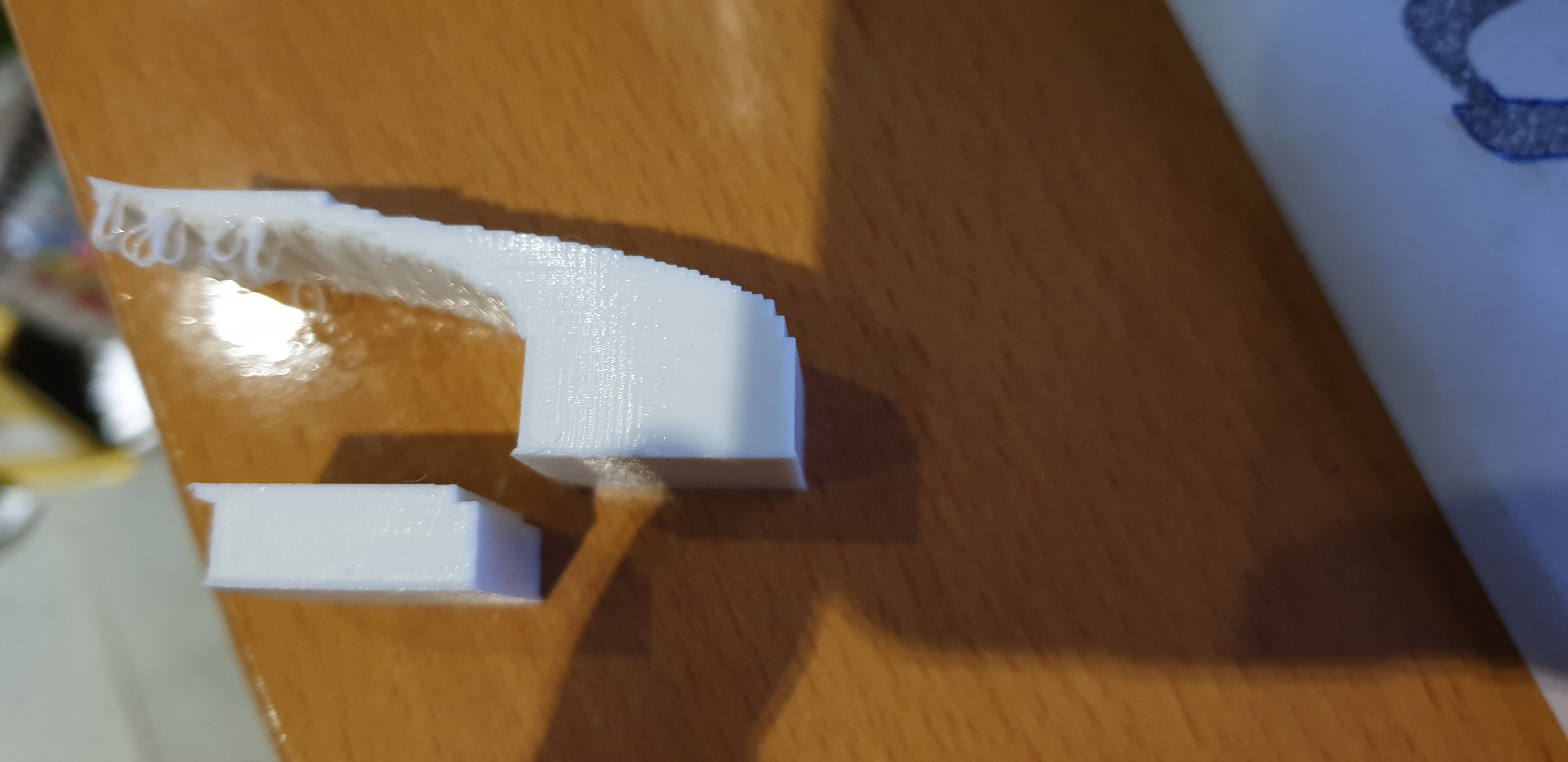

Thank you very much for the files I changed the z-stop and then complied it and it seems to be working but when I am printing the stepper motors seem to be able to get overloaded and stop causing the print to start stepping almost the same as a belt slipping but I know it is not the belts as the tension on them is perfect and if I move a axis like Z and place my index finger on the Z threaded rod coupler with very little pressure it will cause it to stall.
Is it possible to change the voltage in one of the firmware files as I have never changed any of the voltages on the control board and I have never seen it do it before.
From what I did let it print of the test cube on the 1st 3 layers it has never looked so nice and precise, I can't wait to see how well it will print when it is running smoothly

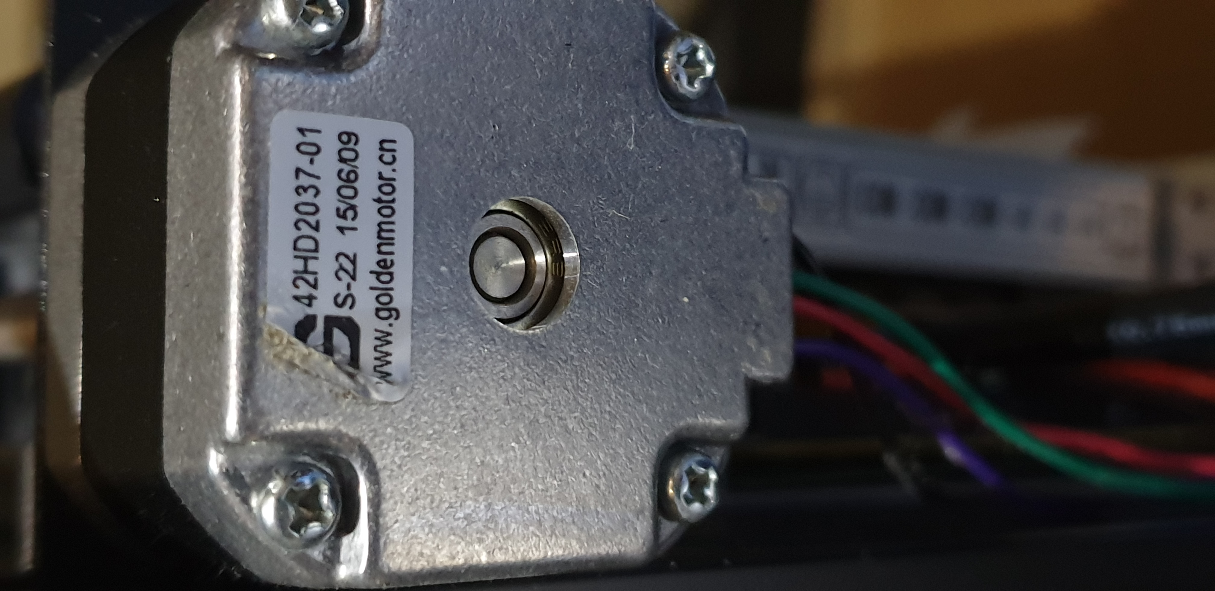

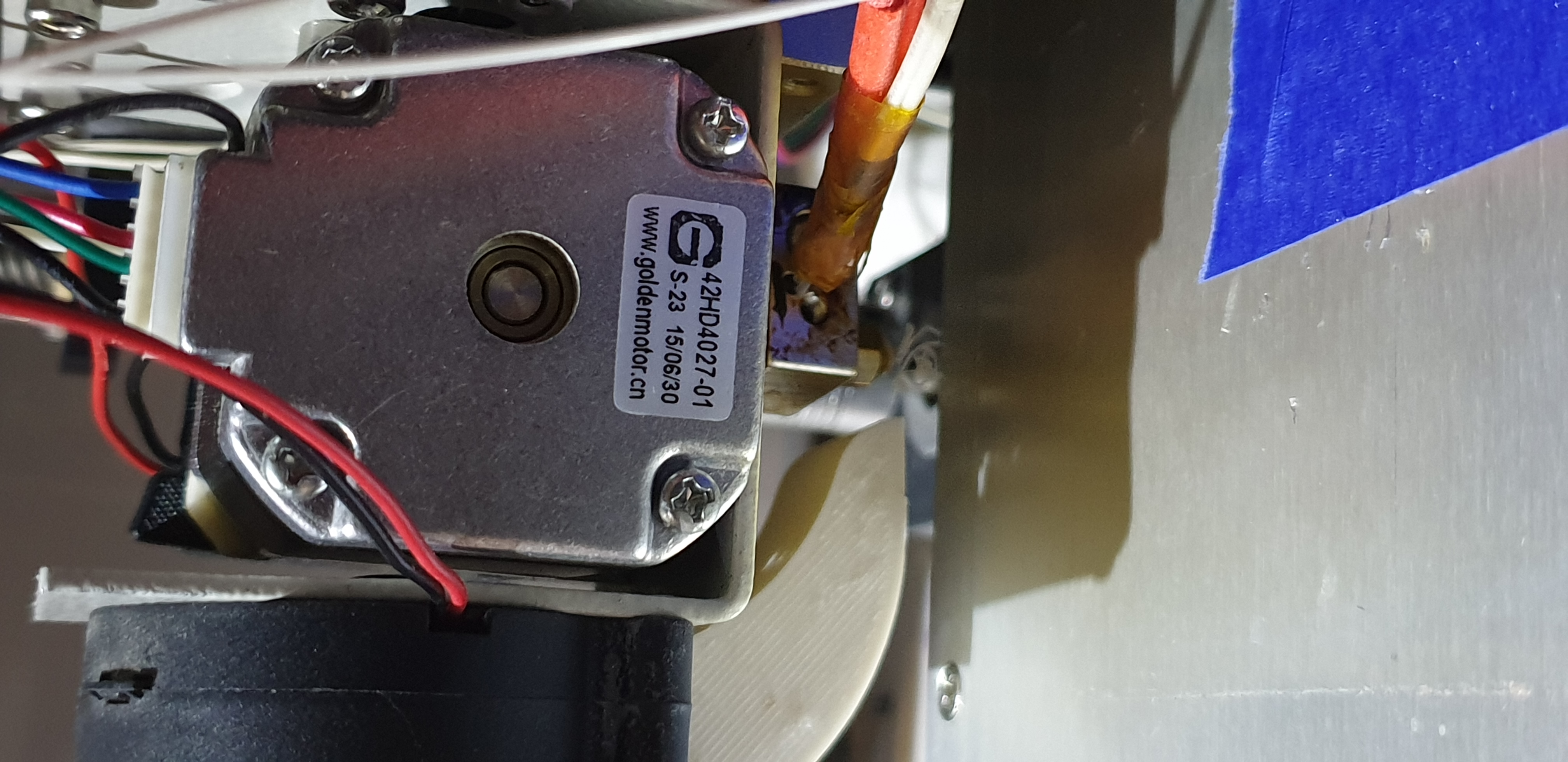

I would measure the Stepper motor current. Now I have given you a video too watch.
Before you adjust the V-Ref voltage measure them write them down on a piece of paper and post them too me.
Here is a You-tube Video
Now before you adjust I have different settings for V-Ref.
If you have www.goldenmotors.cn steppers 42HD4027-01 and 42HD2037-01 Adjust the current to .700 for X,Y, E0 and E1
Z-Axis steppers remain the same as video.
Max www.goldenmotors.cn steppers is 1.2 do not exceed this number on your steppers.
If your steppers get hot during normal operation reduce V-Ref.
If you have any other stepper motors post the part number will look them up
My 3DP11 came with golden motor steppers and the 3DP12 came with some other date code only stamped stepper motors.
Which I determined are a lower torque stepper with a lower V-Ref of .500.
I purchased both my 3D Printer's used as the previous owners could not get them assembled or 3D Printing the way they expected.
So who knows why one did not come with the manufacturers approved stepper motors.

I have set the voltages to what they were meant to be and set the Z to 1.07 as the video said 1 - 1.1
I also re-tensioned the Y - Axis belt just to be double sure that it was tight enough and checked all the drive cogs were definitely tight which they were.
I have tried to do another test print but I am getting layer shifting still, I can't seem to work out why it is happening for the life of me.
As you can see from 2 different prints it is not doing it at a certain height so I am a bit confused as to what to do now. The only thing I changed on the Y -Axis was the bearings which I replaced from old rattling hictop standard ones to the igus drylin RJ4P-01-08 which I have in the X-Axis too and they are not causing any layer shifting on that axis.
If you have any suggestions on what to do I would be very grateful.

Take a Photo of the E- Stepper from the right side and a photo of one of the Z Steppers from the bottom and Post.
You should have plenty of torque as not to easily stop the stepper in motion or turn the stepper while holding torque.
Do not get me wrong you can stop it and turn it though is should not real easily done you should feel the torque.
HICTOP Nema 17 Stepper Motor Bipolar 1.5A 57oz.in 500mN.m
On Hictop Web Page are 42HD6021-03 1.5A 57oz.in 500mN.m
My 3DP11 are 42HD4027-01 56oz.in 400mN.m Min X,Y,E and 42HD2037-01 280mN.m Min for Z
Have no ideal what are on my 3DP12 as they only have date codes. My Best Guess is ~46oz.in. 900ma

When the motors are engaged I cannot move them which makes me believe that the belts are tight enough and not slipping and that the motors are holding ok.
Here are the 2 photos that you requested.
