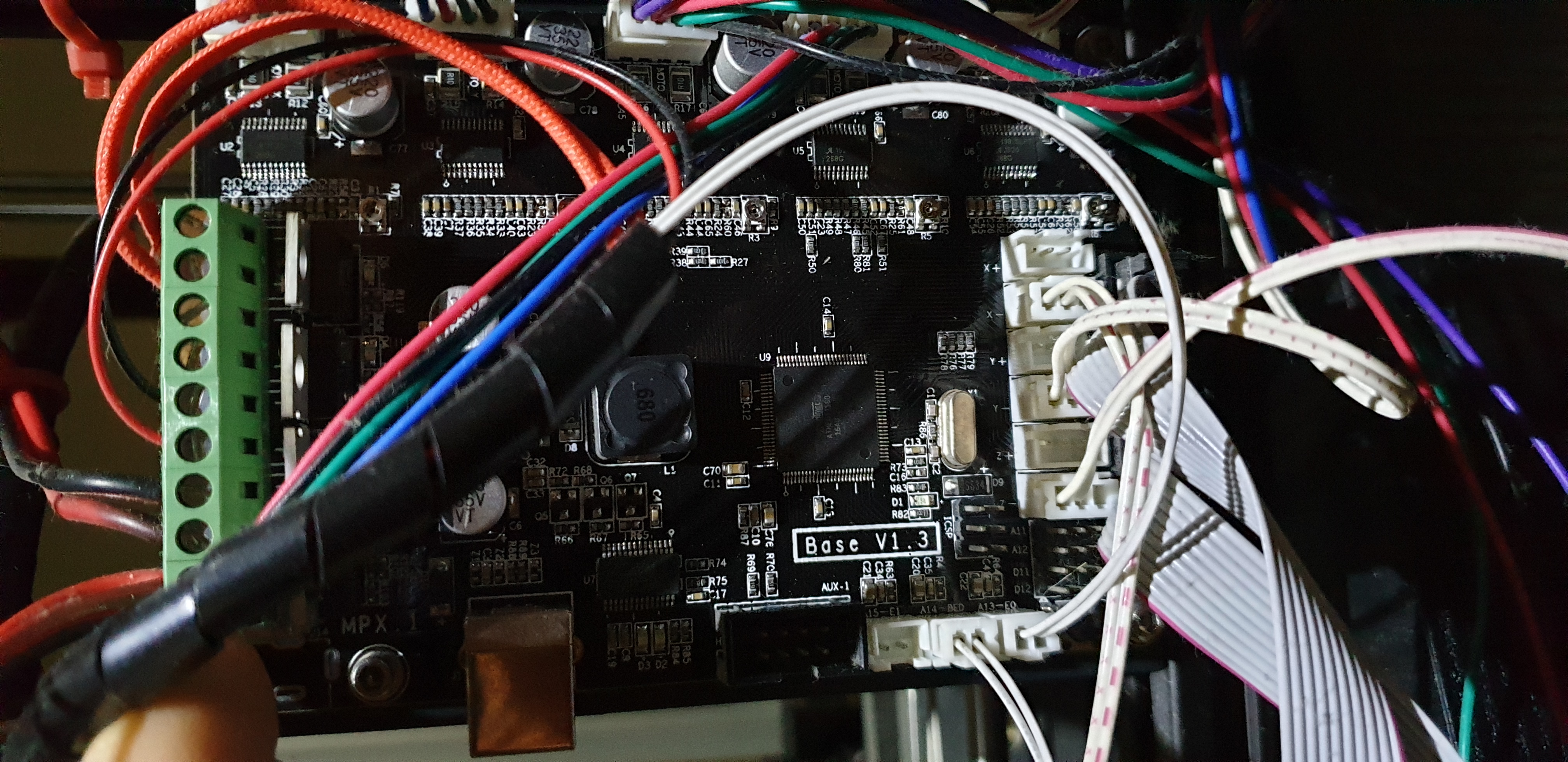

I am not sure if I have the correct board for the latest Marlin firmware, how would I check to see if it is the correct board ?
Controller
Controller
Not sure if it makes much difference but my PSU is 12v 20Amp

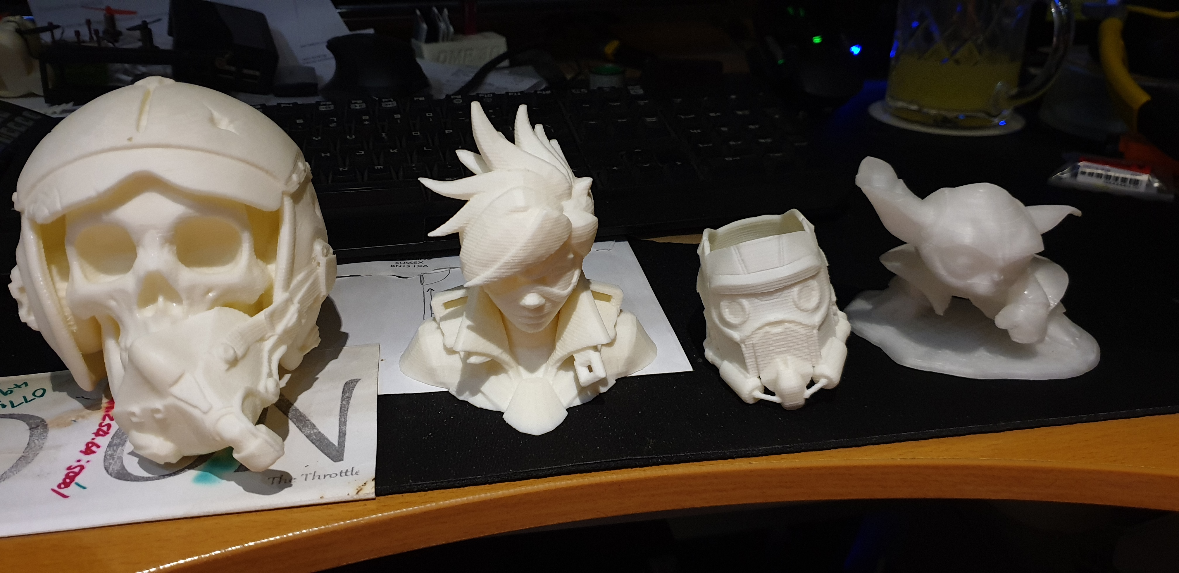

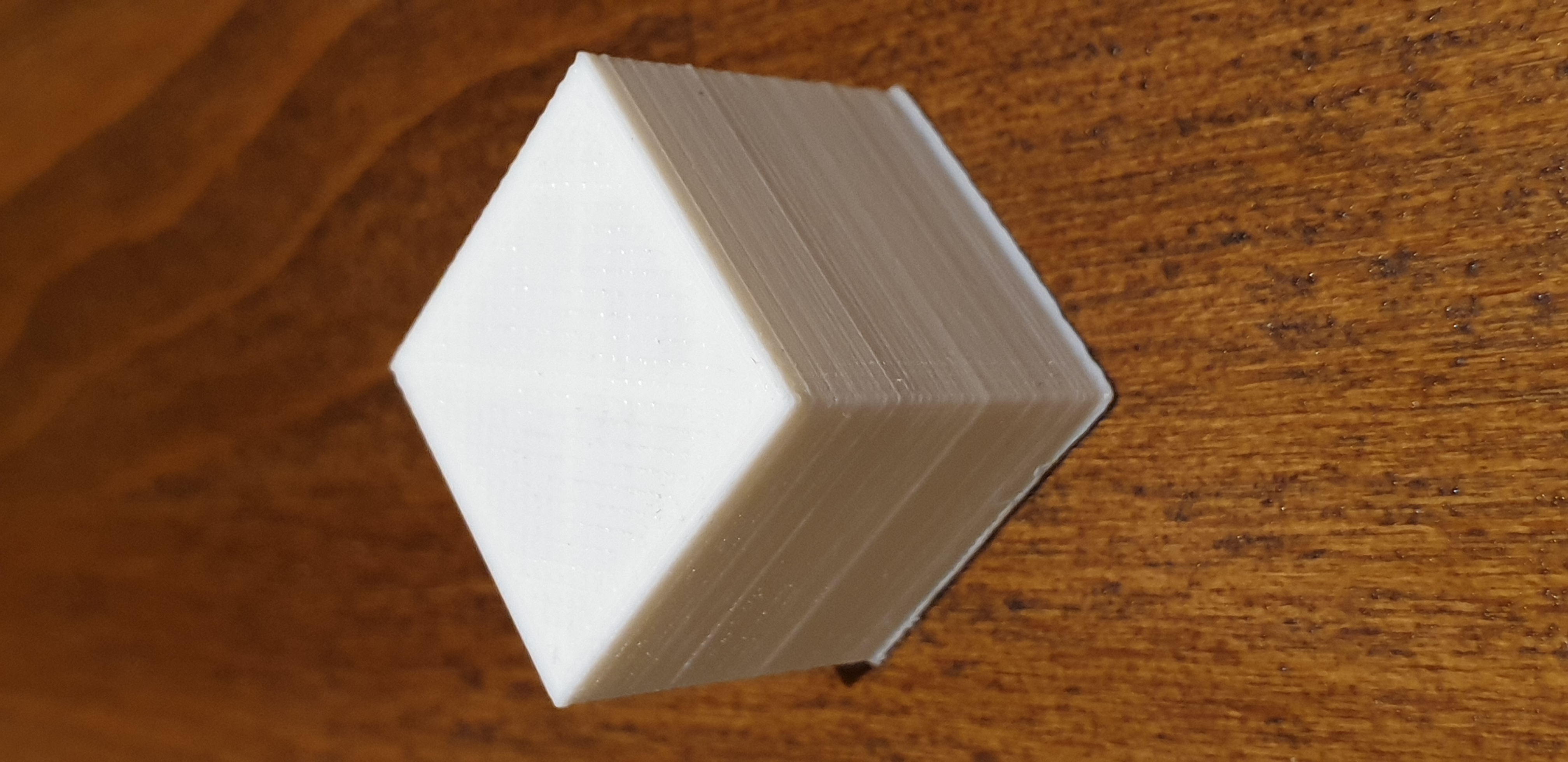

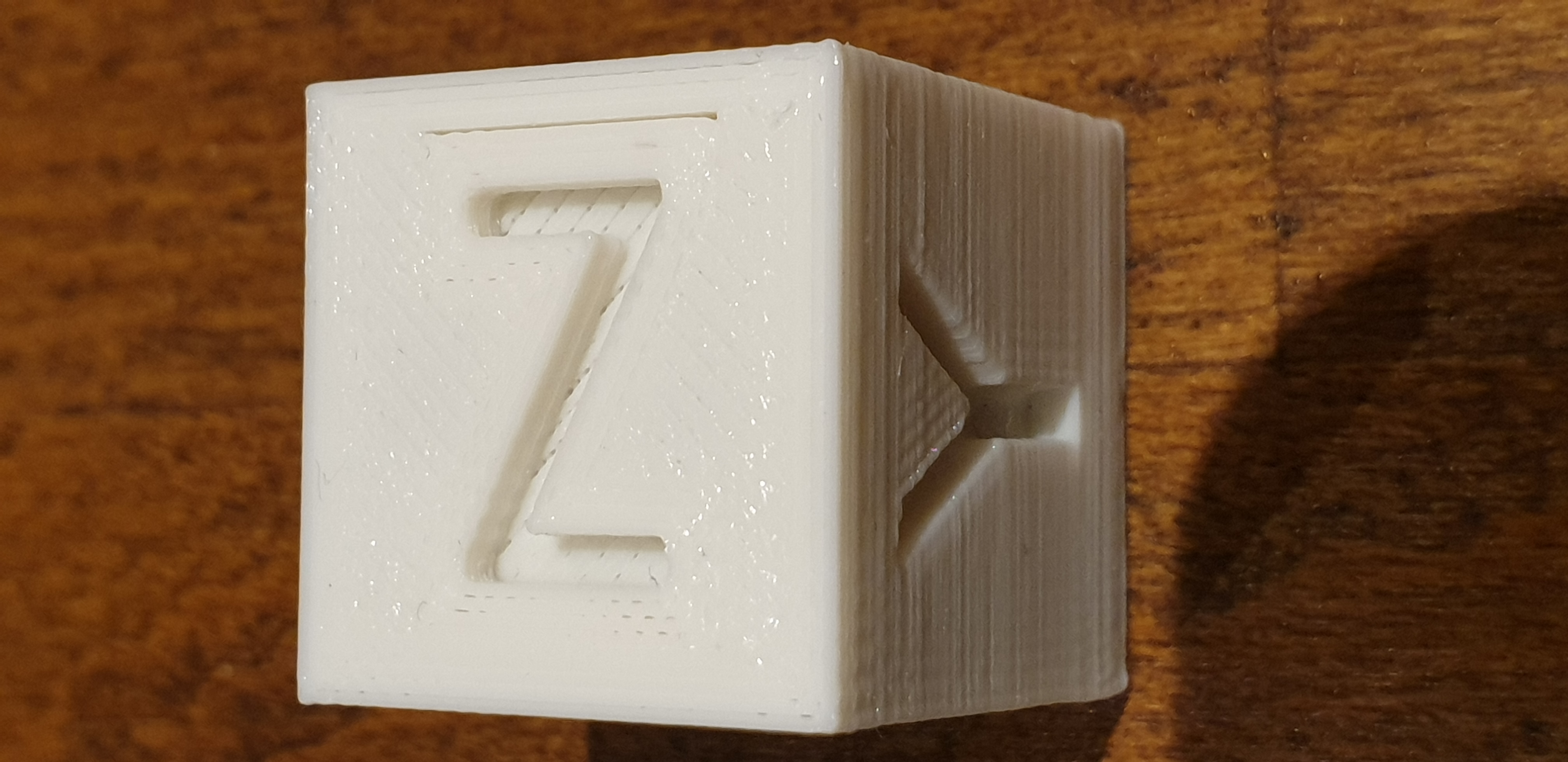

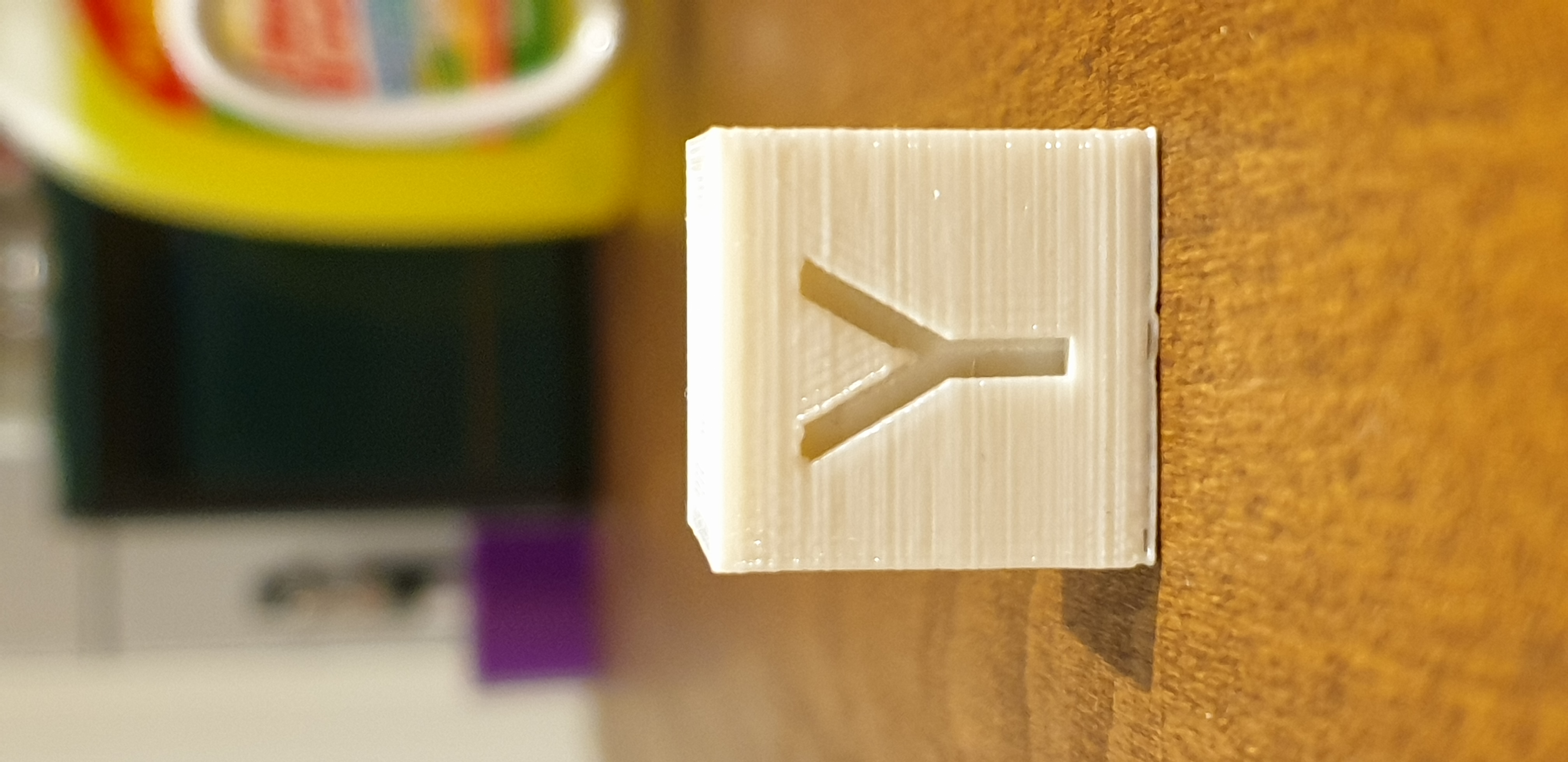

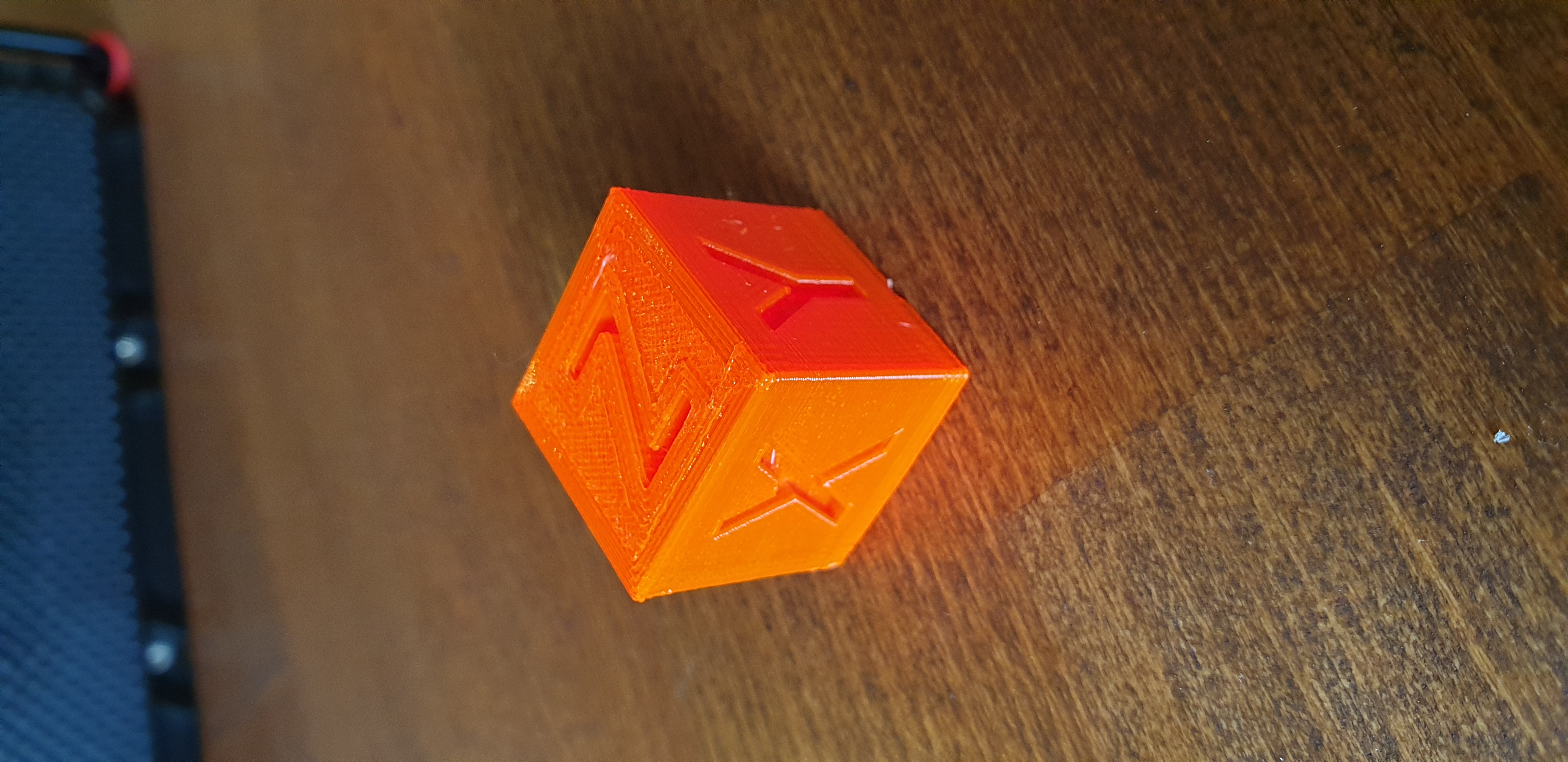

Some of the prints I managed with it.
3D prints
3D prints

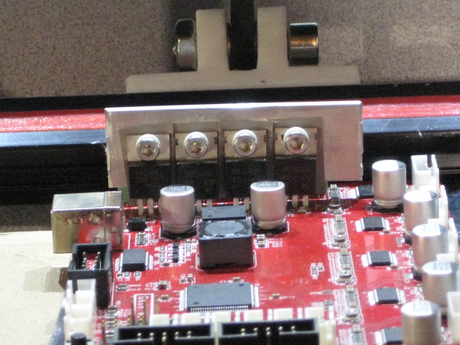

I have loaded the Firmware on Base v1.3 M, MPX.3 and MPX V1 with no problems.
I have both supplies the older S-250-12 20Amp Power supplies and the newer 24V S-360-24 15Amp Power Supplies.
The Controller does not care, Though I have added a aluminum heat-sink bar to the controllers for added protection.
Using a transistor mouting kit

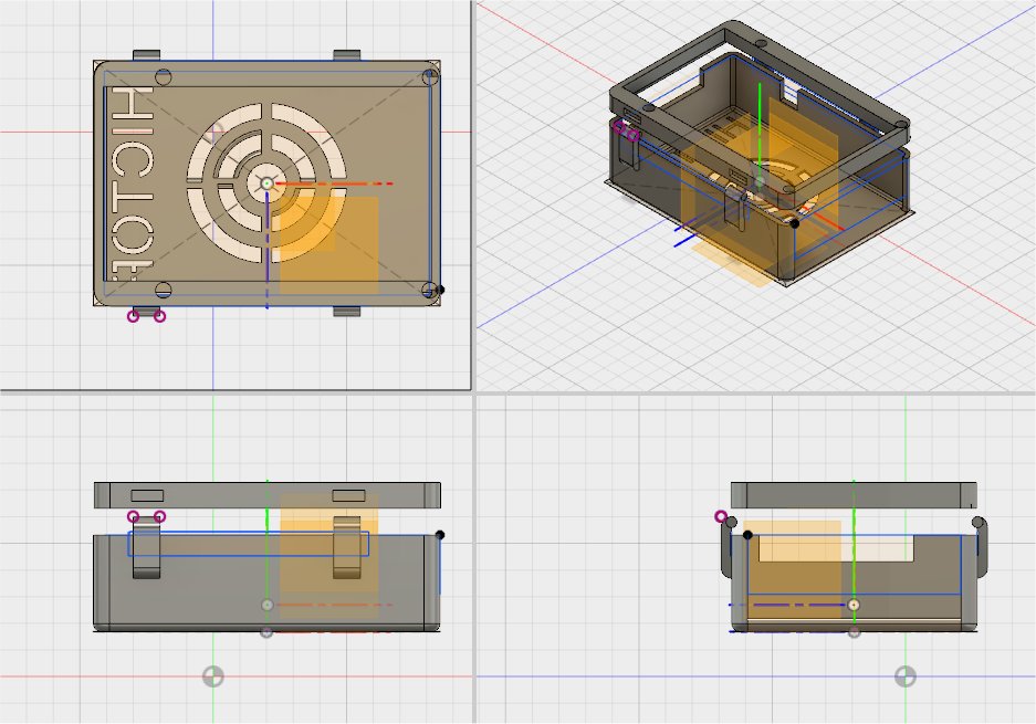

I designed a controller case with a cooling fan. that is available for download on this forum.

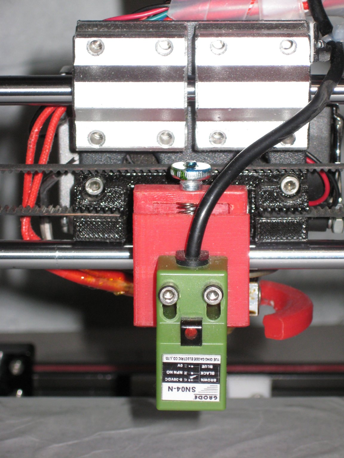

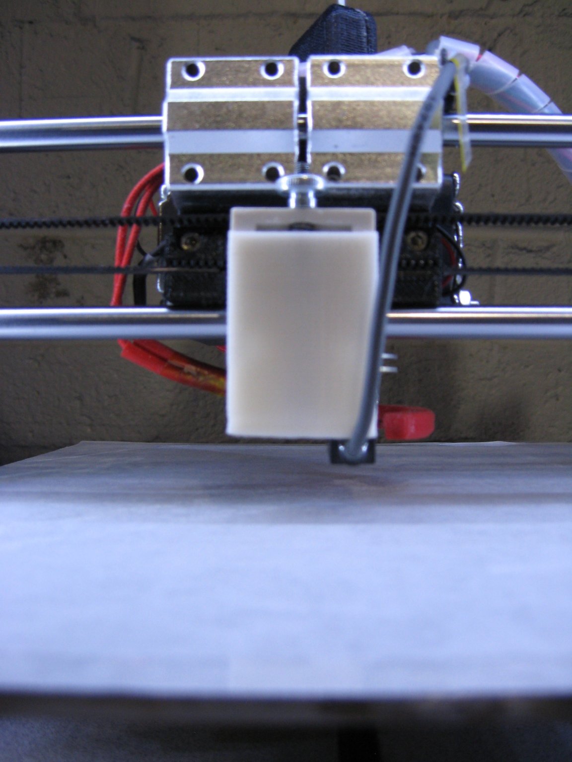

The 3DP11 will be much easier to use after you upgrade to a Proximity sensor.
Original SN40-N On a thumb screw adjustable mount.
New TL-W3MC2 On a modified thumb screw adjustable mount.
This is my preferred low profile Sensor

I would suggest 3D Printing an adjustable SN04-N mount this makes it so easy to get the nozzle to that perfect 1st layer height quickly.
https://www.thingiverse.com/thing:1258415
No firmware changes are required to add the SN04-N proximity sensor to your 3D Printer, need only plug the sensor into same Z-end-stop.
The SN04-N wires as shown.
Signal, Gnd, 5V
Black, Blue, Brown

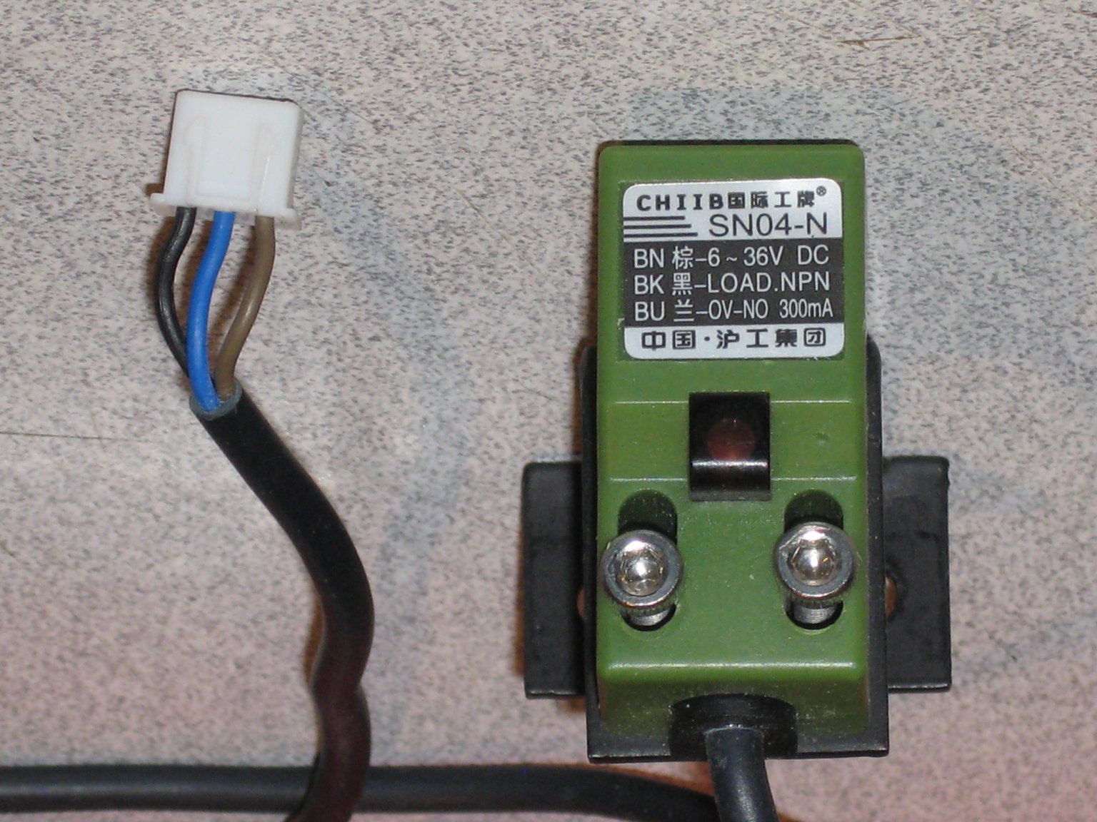

Thanks for the link to the mount I was wondering which one to use, Any idea what type of plug that is as I think mine is arriving bare wires and no plug on the end. I think it looks like a 2.54mm JST XH but I cant be sure as I can't seem to find answer on google.

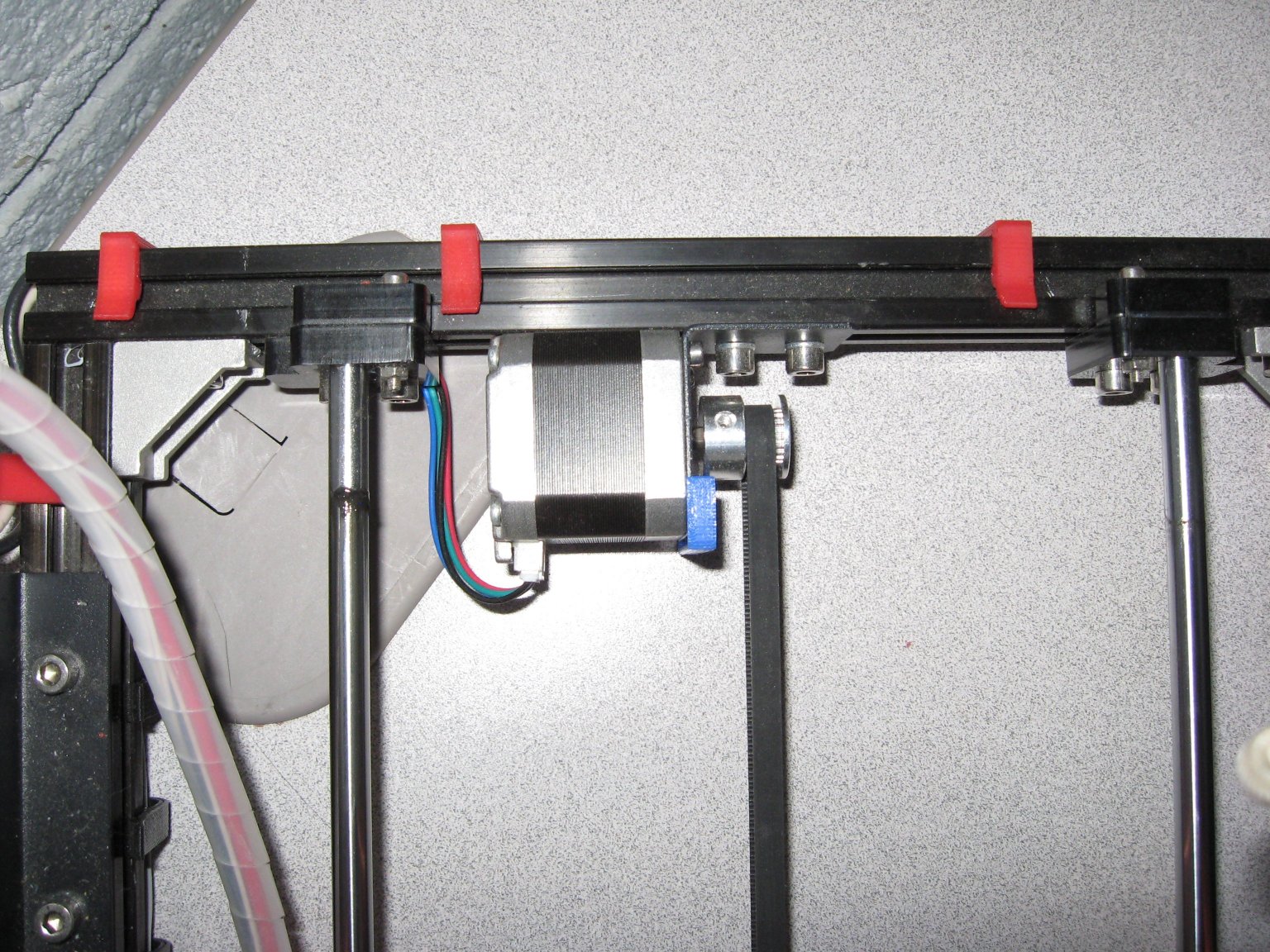

Looks like somehow I added the Wrong Stl file on the other page below is the Y-Endstop stepper mount End stop rest.
I have a Y-Axis tough Plate that mounts on the rear Stepper motor.

Thanks for the links any idea what the plug is on the SN04 ?
Posts: 1493
Re: Need a bit of help deciding on upgrade or new
Yes it is a 3-Pin JST-XH2-54mm Socket Connector I also listed a box set, I do not have a crimp tool for the box set so purchased ones with leads, and shrink wrap to the Proximity Sensor leads. The Proximity sensor shown in previous post was made by Hictop. Did not post Proximity sensors I made as not to confuse you. Wire colors are different from the proximity sensors

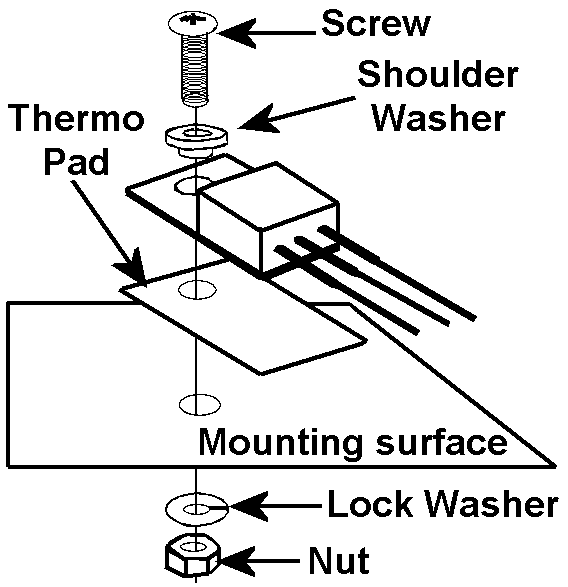

To give you a hand up Here is a correct way to install the Power mosfet.
https://3dprint.wiki/reprap/electronics/heatbed_mosfet
