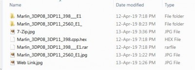

Here is what I do when I create a new Marlin File. "Save As" to a different directory In your case chose " Marlin_3DP08_3DP11_2560_E1_ "
This way you can keep all your changes in separate file folders indefinitely, an in the name you note that it is 2560 lead-screw.
1st - You need to compile to see it their are any errors.
2nd - You can create the Hex file and or Upload from Arduino IDE or using the Hex file the same way yo uploaded to other hex file.

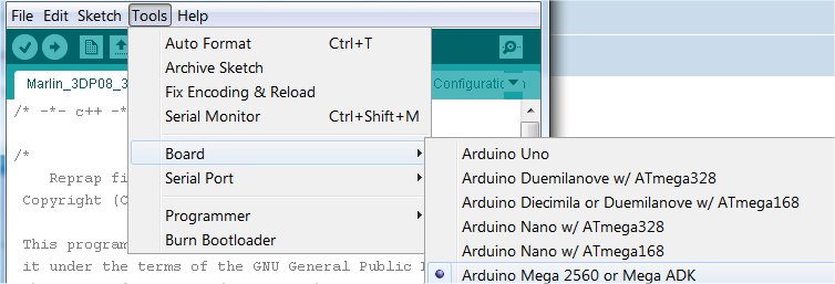

Re: Firmware for Hictop 3DP08
This step slipped my mind.
You have to select Board> Programmer Arduino Mega 2560 or Mega ADK
You have to select Tools > Programmer AVIRSP mkII
