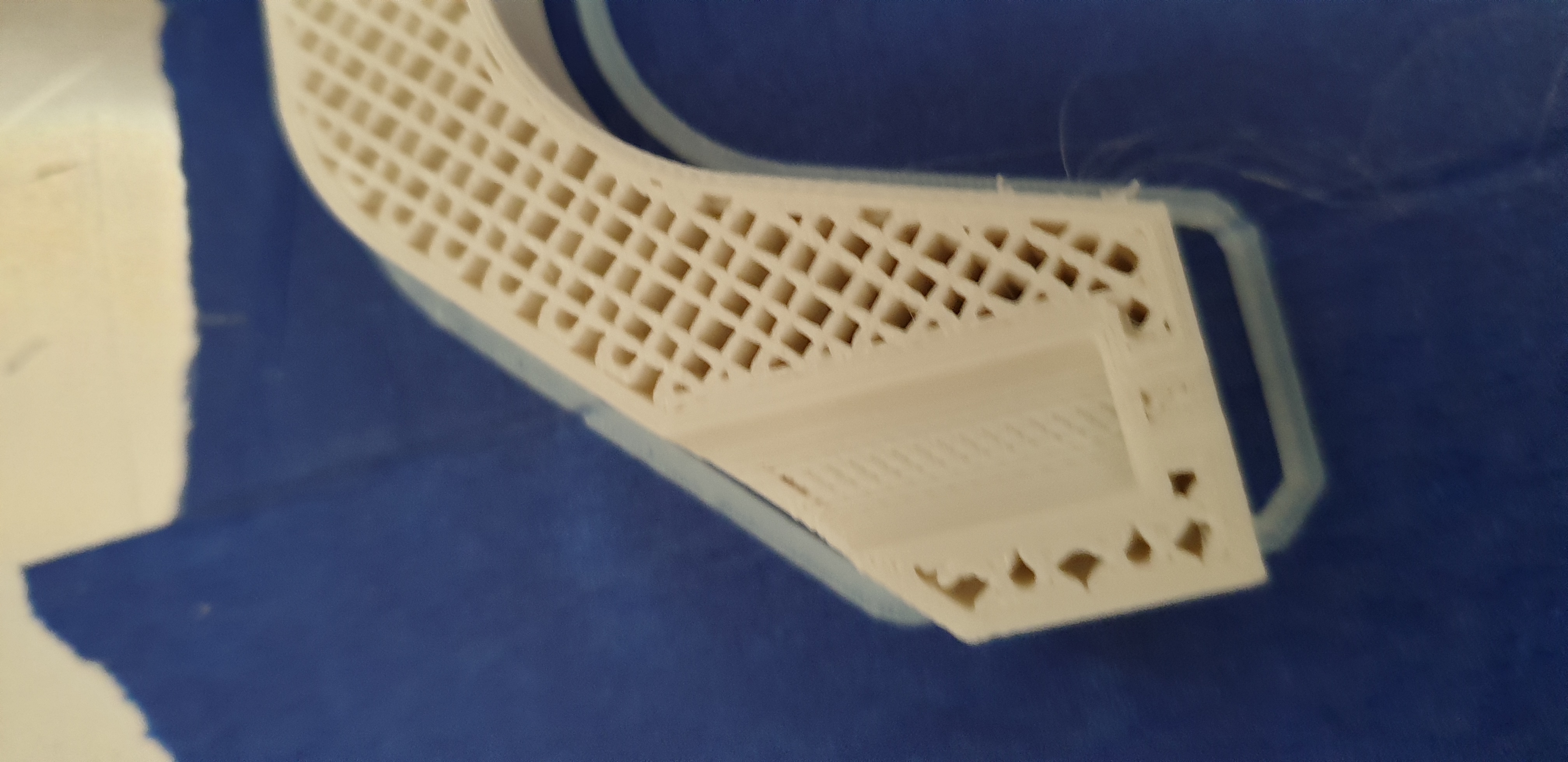

I was just printing another handle out and it started layer stepping again

Is it layer shifting on more than one Axis.
I would slide the Y-Axis with power off is should be smooth and easily moved.Slowly move the Bed too both extremes.
If you are feeling any change of tension you may need to adjust your Y smooth rod holders.
Random height layer shifting can be caused my V-Ref.
Check your Steppers and Driver chips to see if they are getting hot as over heated components can cause layer shifting
You may have a little too much V-Ref back it off closer to the suggested .800 on your X, Y, and E how about .780

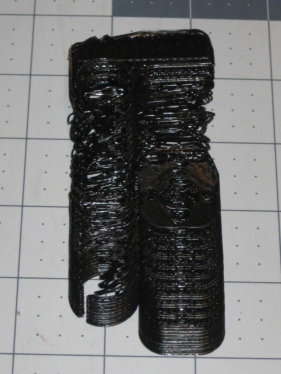

I know what you are going through. I am having layer shifting because I believe I bent one of the rods or maybe both.
My 3D Printer came with the really cheap bed carriage made out of thin sheet metal and bent at 90 degree angles for strength.
Any pressure on the carriage causes it to deform making the carriage warped, causing the front, back, right, or left to be off level.
Any way I was pressing on the carriage to re-level it when, I believe I bent the smooth rods. Tried to make them true again I do not know.
If the bed is not level the leveling screws will hit the smooth rod holders, causing them to stop instantly make quite a horrible sound..
I will need to purchase two Aluminum carriages and two 410mm smooth rods. This is half the price of another 3D Pinter.

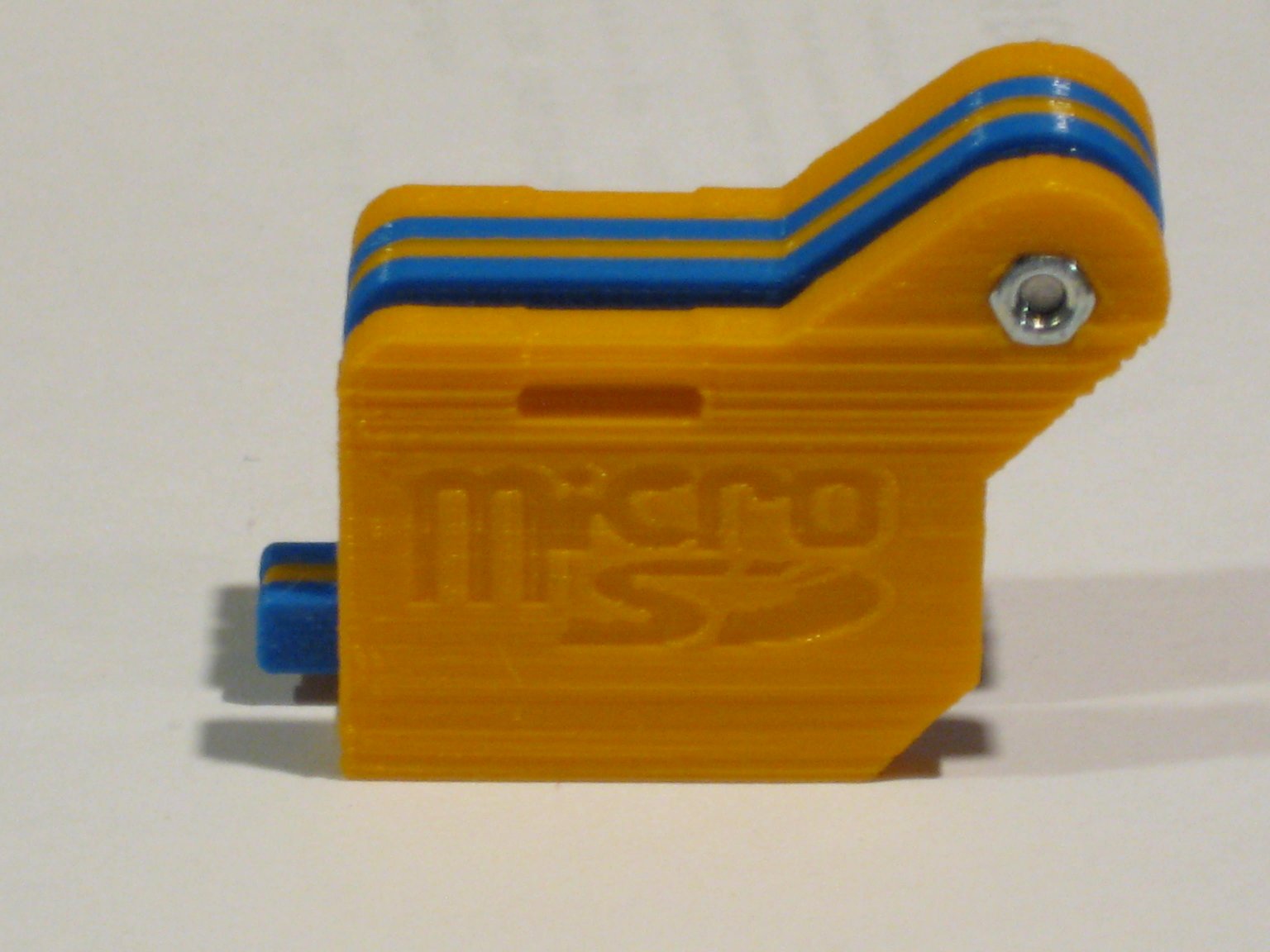

The First image was because I was told that my stepper motor V-Ref was too high so I lowered it.
The Molded Right lead-screw mount broke was 3D Printing a replacement below.
The second image is caused by tension of the Y-carriage bearings, And this is crazy it has a smoother travel than Printer without layer shifting.
And it only layer shifts on rectangular of square side of the model being printed. Rounded Models have no layer shifting.
Again this sounds like V-Ref Current settings or Jerk settings ect....

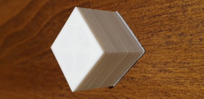

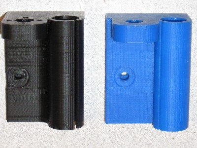

And a Side by side of my Best adjustment since layer shifting began
Black is 3D Printer with layer shifting
Blue is its Twin Printer without layer shifting.
You can see the layer shifting on the Black model though it is very minimal.
Will try Marlin 2.0.x Junction Deviation from low though high settings to see if it can be further corrected by configuration alone.
There has always been line on the model they are caused by internal changes of the model themselves,
like cavities leaves a darker shade line during the transition between solid and hollow will figure this out one day.

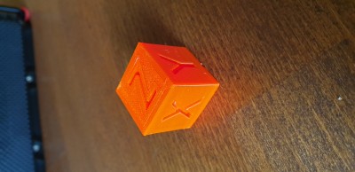

When I measured the calibration cube the results were
Y - 19.89
X - 19.90
Z - 20.13 I would like to try and get these values to be as close to 20 as possible but I have never done the tuning before so I have no idea on how to do it.
I did read something about it but the way it was explained has me confused to say the least, i do remember reading something else that made more sense on how to do it but for the life of me i can't find it again.
I think it was a wiki page but I cannot find it. It explained that if a value was lower then you had to either increase or decrease the steps or something like that.
Is this something that you could either help me do if you dont mind or point me in the right direction.

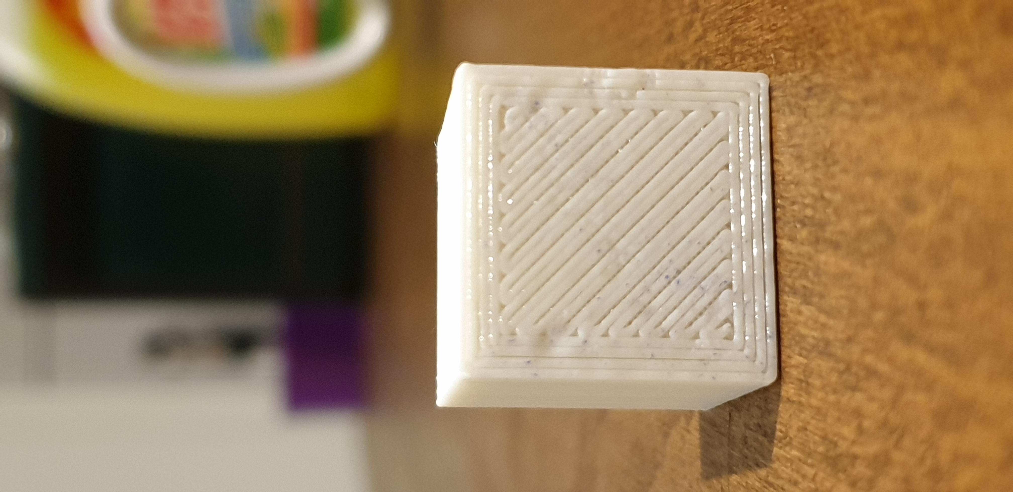

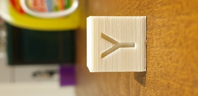

Z - 19.99
X - 20.03
Y - 20.08
Pretty happy with that result, still waiting to do the upgrades as the parts haven't arrived from the slow boat yet but I will do them once they arrive.
