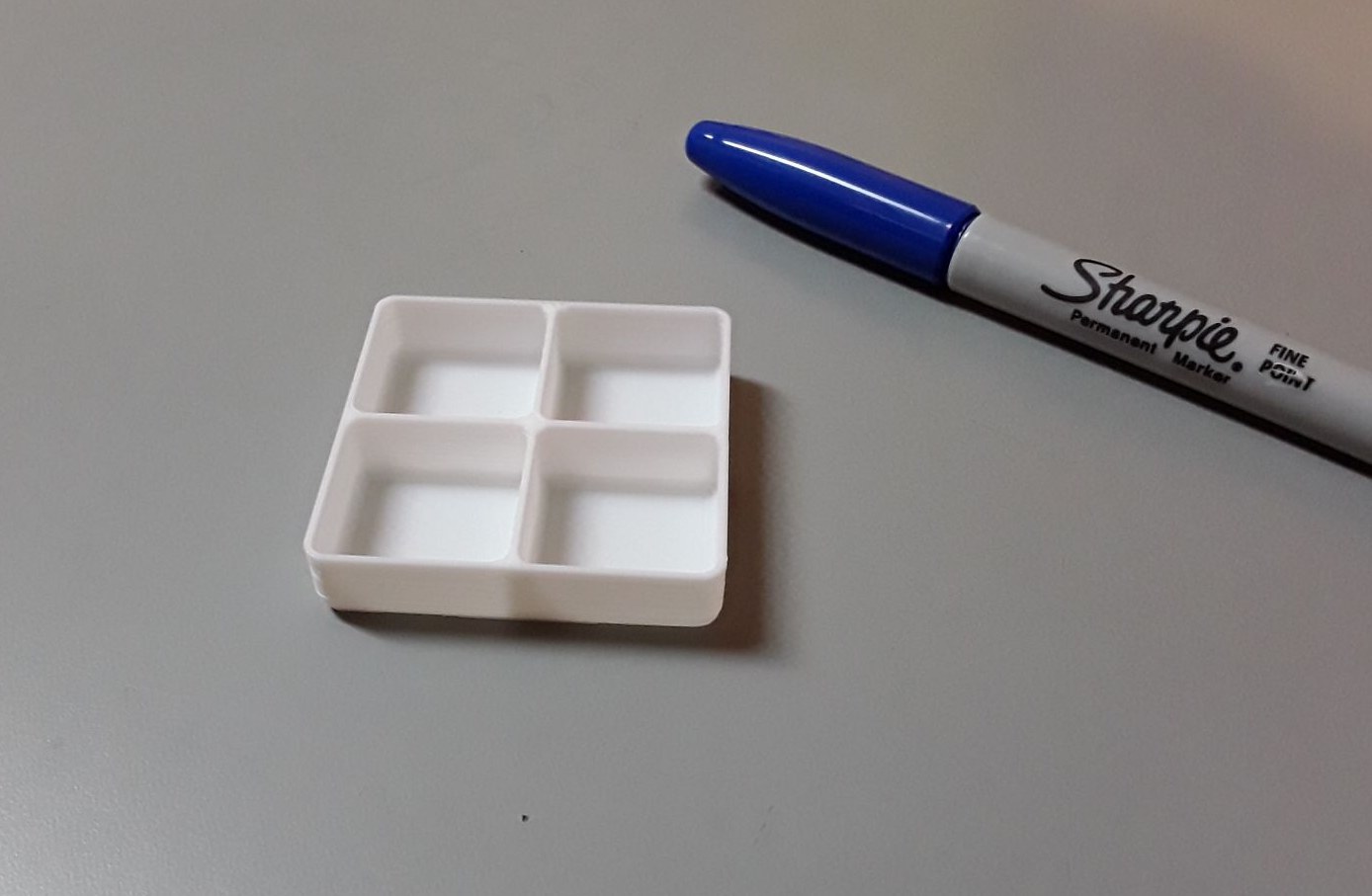

Here it is...my first print on the CR-10 S (Sharpie for size reference).
It's not much, but it seems like a good start.
