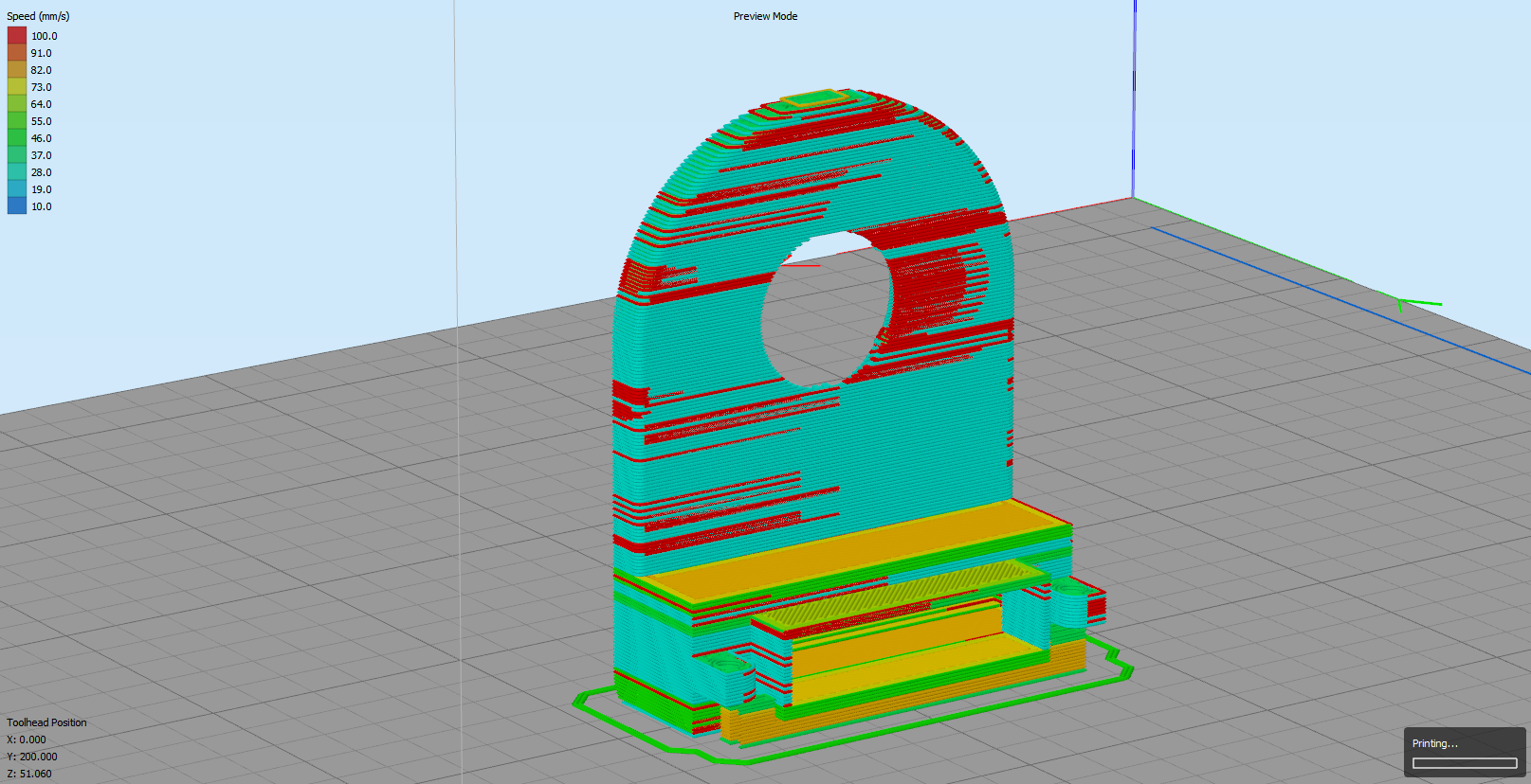

Good evening,
I'm playing around with my slicer setting and can't figure out why my printer speeds are so inconsistent between layers that are the exact same. Lowering or adjusting my speed does not clean up the model at at all. It simply changes which layers are inconsistent. Thank you in advance for your help!!

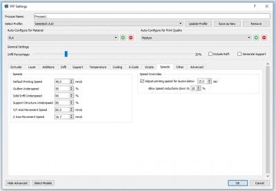

I'm curious what your Speeds tab looks like

Running V4.0.0 currently. Attached is my speeds tab. I can upload all tabs if it would help?

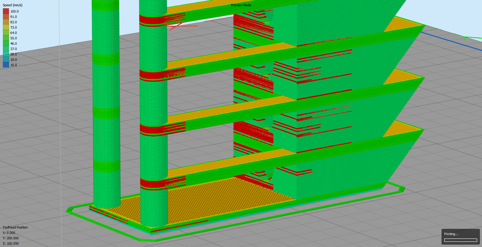

Well here is mine, this is is the one from S3D (they made it)
You are going very fast in a lot of spots
