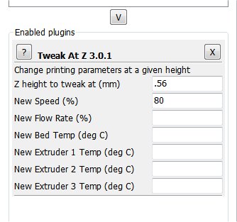

Tweak at Z ;Plugin
;change at layer height two
print speed 80%

I have different startup print speeds.
I use 32% because normally when printing the skirt is when the fine tuning of the layer height occurs.
I will adjust the 1st layer height using Z axis baby-steps until I see that perfect layer height adhesion.
After I see that the initial layers are secure and laying flat, then the speed can be adjusted.
This speed adjustment depends mainly on the complexity of the shape, like this Velociraptor Business Card.
I will print the entire 1st layer between 32-46% then Tweak at Z plugin changes to normal print speed 76%.
Mr SNG
- Posts: 74
Re: Marlin 1.1.9 Setup Problems
So how do you tweak Z when the machine is printing?
