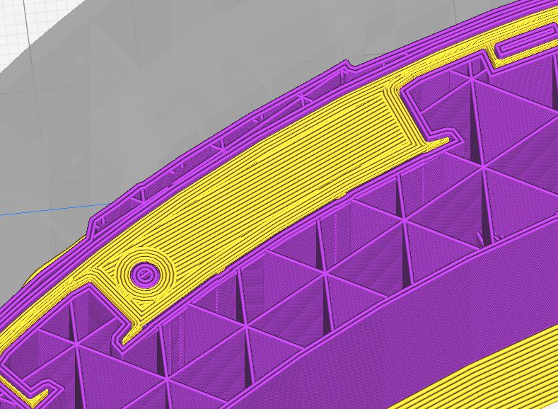

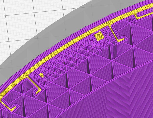

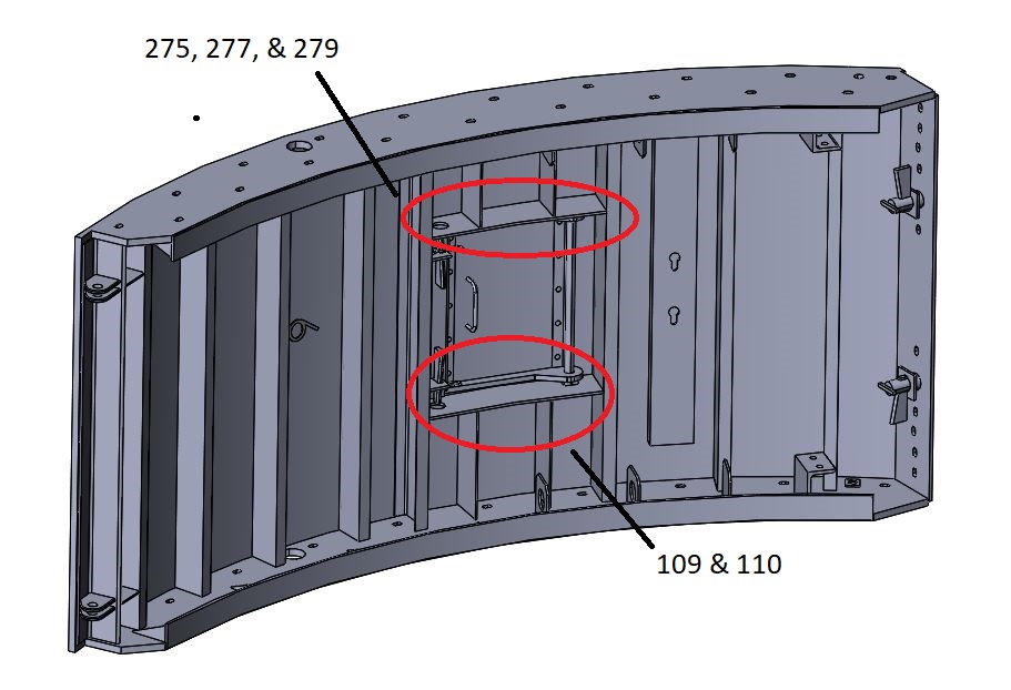

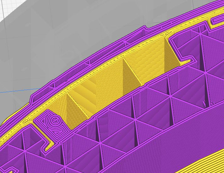

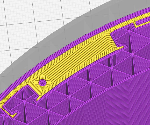

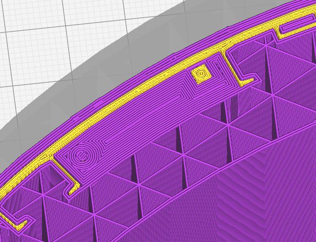

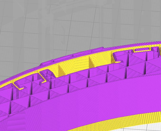

I'm having an issue where the support structure does not print under an overhang but does print under an overhang further up the z direction. I've included some images to help show what I'm trying to explain. The model .jpg shows the areas I'm referring to. The shape and thickness of the overhangs circled in red are the same. No support structure is printed underneath the bottom overhang except, for some reason, the portion of the bottom overhang that has the hole shown in 106, 109, 110. After layer 109, Cura goes right into generating the overhang at layer 110. As you move up the z direction the support structure is printed entirely for the top overhang as shown in the sequence images 275 and 277 which result in the first layer of the overhang 279. The top overhang is fully supported. How can there be no fully generated support structure for the bottom overhang but there is for the top? I've also included the .3mf file for debugging.

Thanks, I will give this a shot. I did find a solution which I still find odd. In my 3D application, I deleted the plate and remodeled it and Cura "recognized" there was a full feature that needed supporting. This is odd though still because the original plate feature was still part off the overall model. I made sure to join all my bodies. I am not a fan of the custom supports plugin for the fact that I can't create custom supports that saves material. For instance, I would like the option to create conical towers from the base to the directly under the top for each small section.
