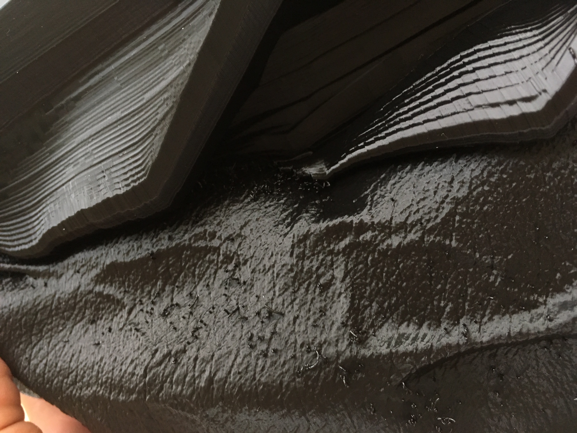

Hello, I would like to ask you for help. I am currently new in 3d printing. That is why I humbly ask you to help.
I am printing Venom model right now and my prints are a little "furry" from bottom side. I am sure this is because of the settings, but I am just a newbie. Using cura, tree supports. It looks like the infill from bottom in cura, which I just discovered.
Any ideas, please?
Thank you, Jan

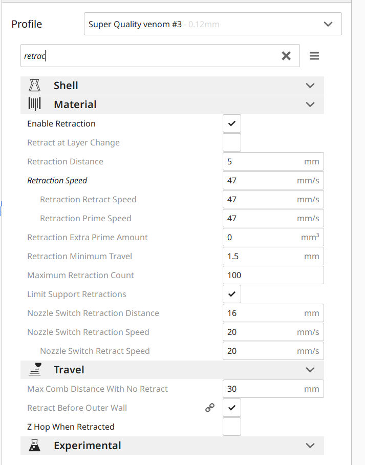

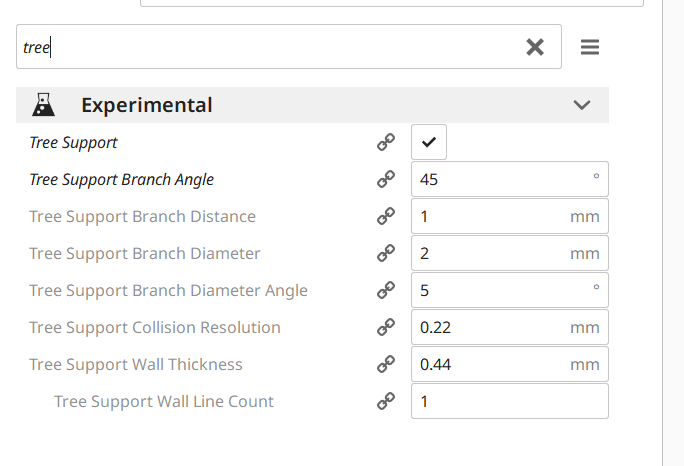

Can not see your retraction settings, would like to see the numbers on for your tree supports.

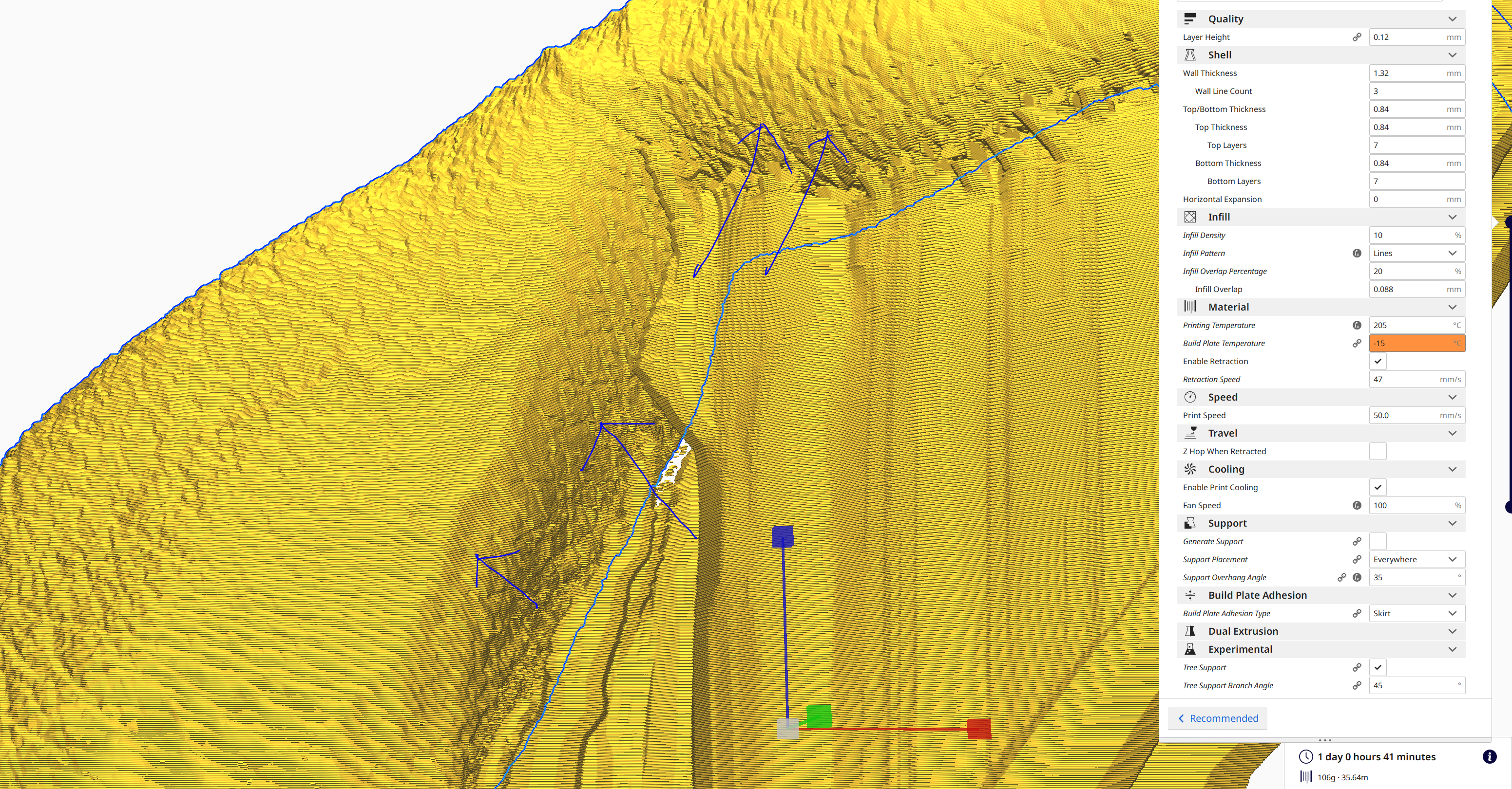

Hello, thanks for reply, I am attaching settings and whole cura profile, which I currently use.
thank you, jan

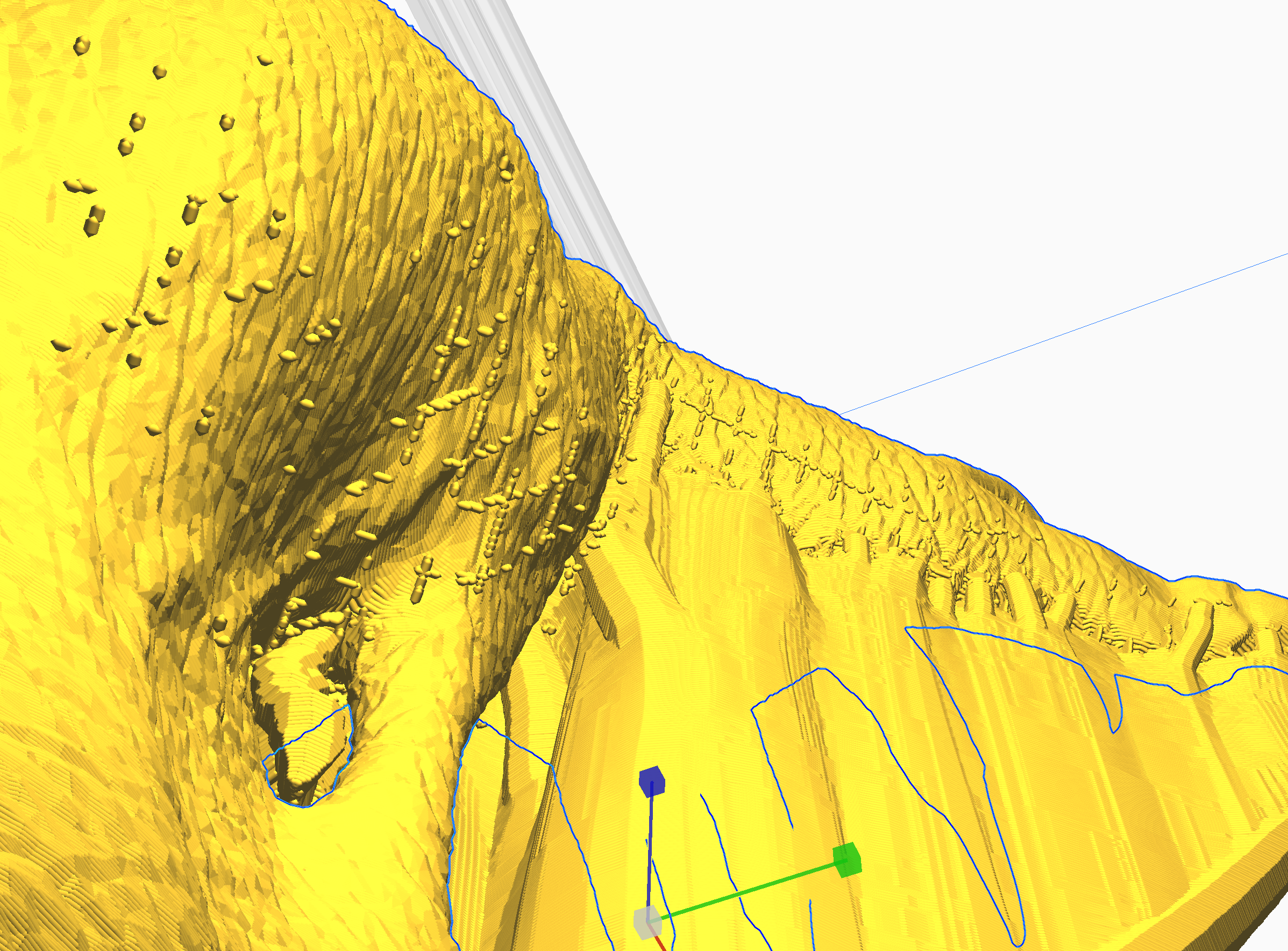

I am trying to grasp the bottom image as it has bumps all over the surface.
Do these bumps coincide with the fuzzes or the tree supports.
jankolar
Posts: 4
Joined: December 27th, 2019, 3:50 pm
3D Printer(s): creality cr10 pro
Re: infill visible in final print?
Post by jankolar »
it doesn`t coincidente with tree supoprts, it is directly on the print itself. from the bottom it looks like an infill pattern XXXXX as you can see
