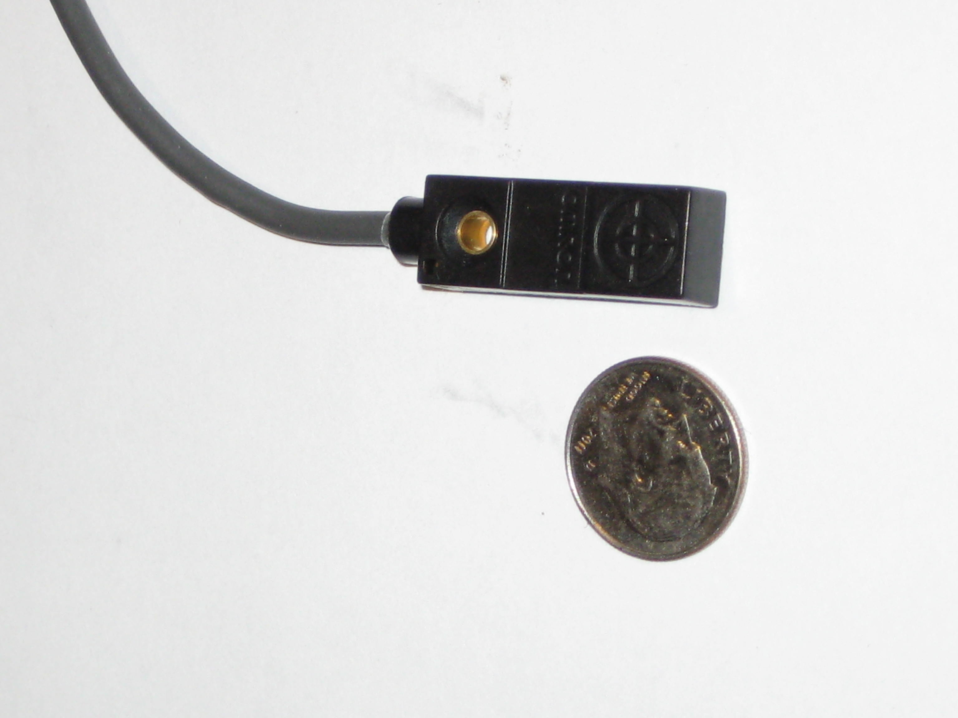

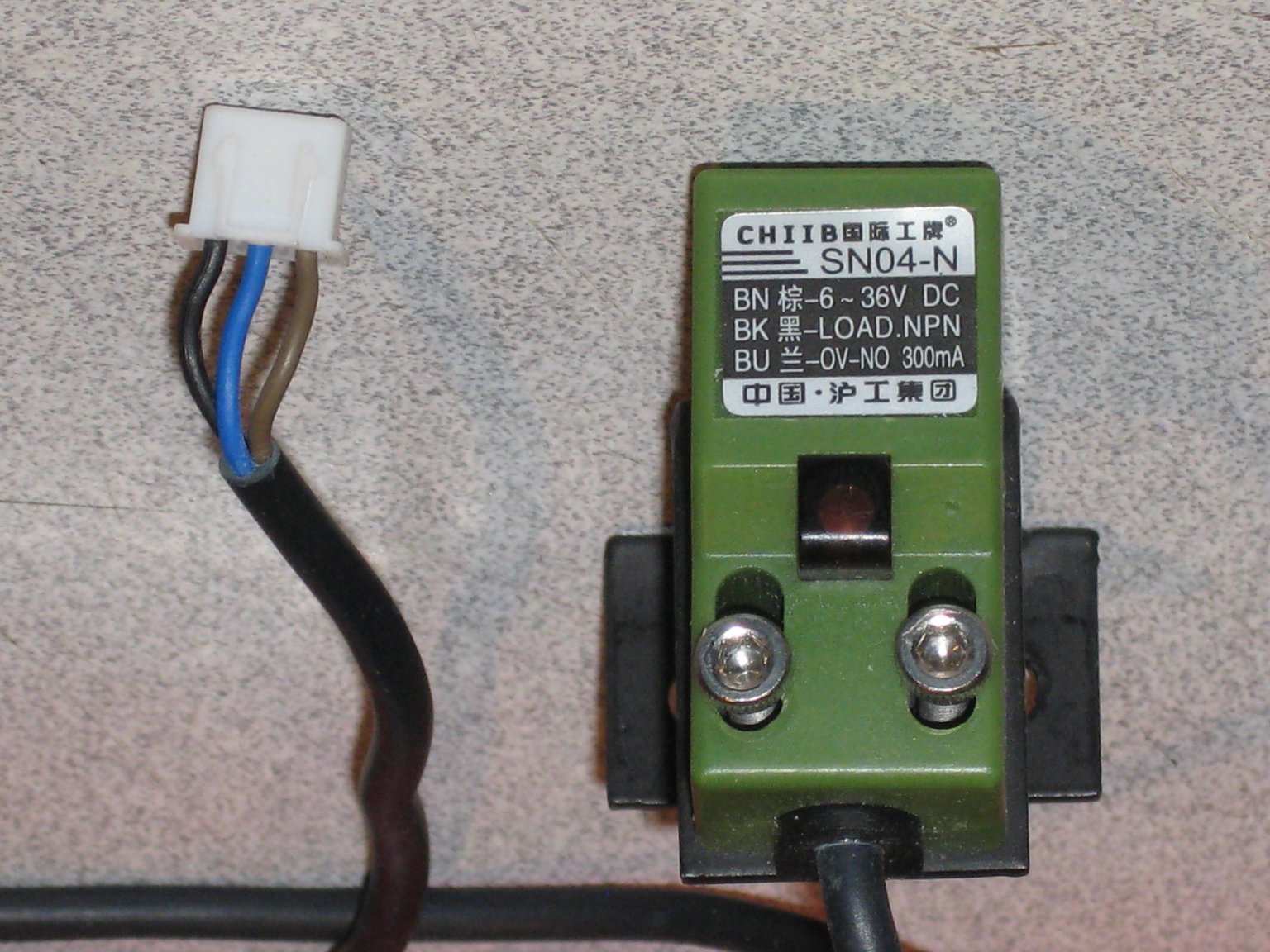

I wired both my Proximity sensors by plugging them directly into a 5volt source.
They are both labeled SN04-N 6-36 volts and Omron TL-W3M 10-30 volts.
In the three years have used the sensors have never had any problems with them operating at 5volts.
This in no way means that they should be or can be operated outside of the specified voltage limits.
