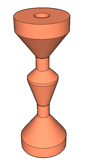

Thank you for the link to the article, but it really didn't address the intent of my original post, i.e. what the relationships between the settings are. It was far too "generic" in it's explanation. I know what "shell" is, as it's pretty obvious, but I don't know what the relationships between the settings involve. Perhaps I should give a more detailed explanation of what I'm looking for, to avoid getting responses that don't address what I've asked.
To that end: If I make a change in Layer Height from a Height of 0.2 and a width of 0.4, to say, a Height of 0.5 and a Width of 0.5 again, with an 0.6 nozzle, what will that do to the finished print? I don't really care a great deal about the "smoothness" or detail in the final product, as it is a fairly general cylindrical shape, with minor variations in diameter. I've attached a photo of one of the parts, as an illustration.
I'm aware of the need for supports, and I'm reasonably sure I have already figured that one out in Cura. My question is, how to understand the relationships between the settings so that I end up with a print that won't take 2 days, 7 hours, 46 minutes and use up 130.31 meters of filament? I hope that makes sense.
Thank you very much for taking the time to respond! I do appreciate it!! :-D
