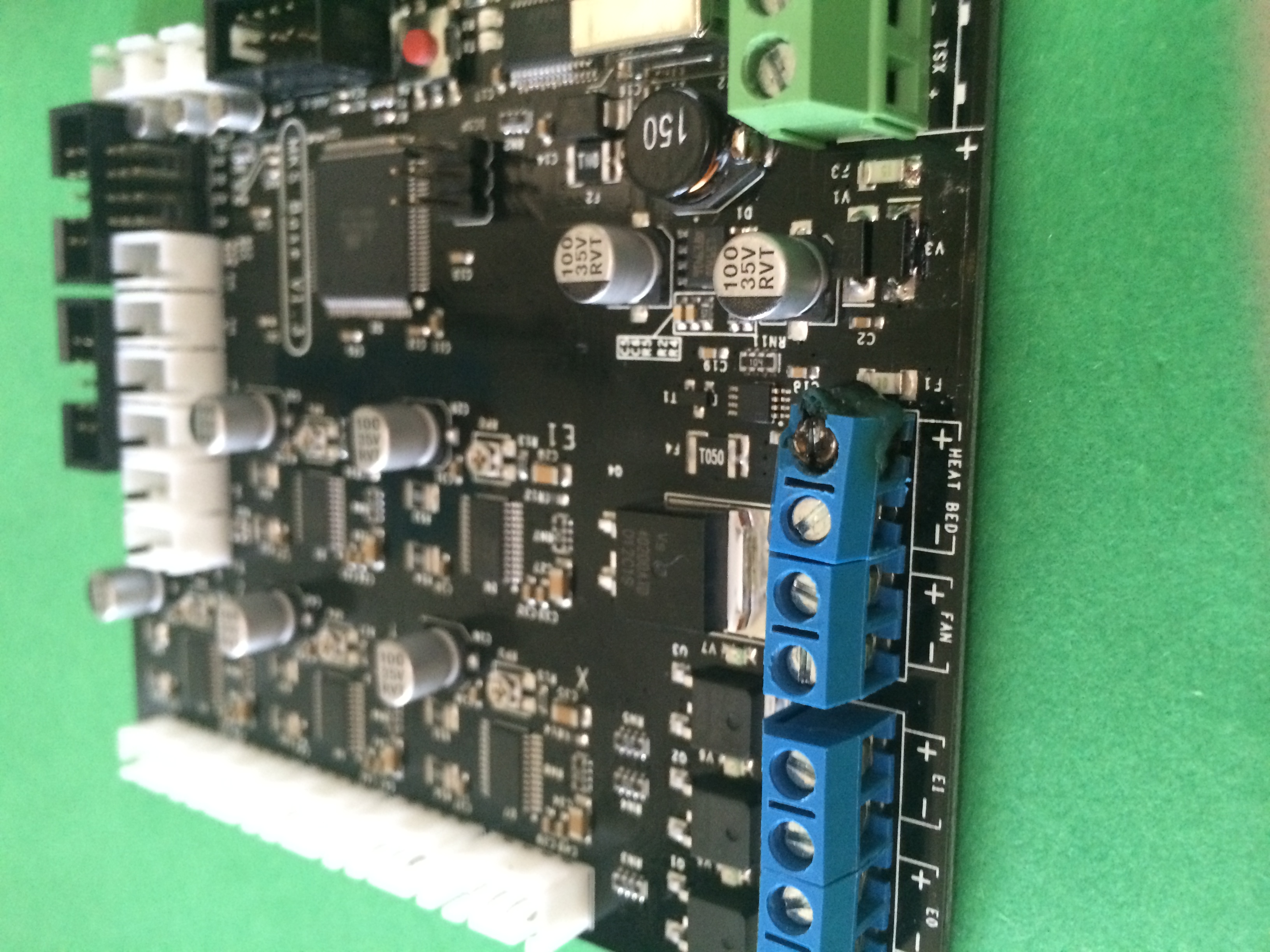

I too noticed that the fan speed dropped whenever the bed heating clicked in on our HIC i3 (acrylic frame model) with the stock power supply and wiring. I also noticed that the wiring from the power supply to the RAMPS board was getting HOT, so it was clear that the wire from the power supply to the RAMPS board was undersized. I swapped out the OEM wiring with some 12 gauge cable, and the overheated on that wire was gone...but another problem developed: the wiring from the RAMPS board to the heated bed was overheating even worse than before, and it actually melted the connectors on the RAMPS board itself!
Looking at the current draw specs for the heated bed, I decided that I wasn't comfortable drawing that much current through the FETs on the RAMPS board or through those wimpy connectors. I purchased a generic automotive control relay rated at 40 amps and drove the control coil of the relay from the RAMPS board heated bed connection; you need to include a reversed diode across the control coil to snubber the voltage spike you get when you switch the coil on and off, there are details on the .net. I then wired the heated bed through the relay contacts directly to the power supply using some more of the 12 gauge cable, and I included an in-line fuse (automotive blade fuse) just for some extra protection.
The result is no more cable overheating, faster hot end warmup, faster heated bed warmup, stable hot end and bed temperatures. One consequence of using the relay is that you can't used PID control of the bed heating, but I don't find that to be necessary. I wouldn't use a relay for the extruder hot end, since it's current draw is pretty small compared to the heated bed. I haven't checked the voltage levels at the board as the heated bed cuts in and out, but I think they are pretty stable. No detectable change in fan speed.
Here's the fried control board:
The board connections were so munged up that I just added some pigtail leads and bullet connectors to that I could attach to the control relay. Still using the original power supply; it seems to handle the load just fine.

Guys, to help prevent melted connectors like this be sure to tin the wire ends with good quality solder before you put them in the connectors and tighten them down. This type of failure is caused by resistance between the connector and wire which generates more heat as current rises. When the copper is exposed it will oxidize and generate resistance between the individual strands of copper. Those connectors are cheap and underrated for the amount of current being drawn so this will give the connection the best chance to survive. Also note that the cheaper copper wire tends to oxidize much faster than quality brands/grades. I even saw a guy's video on YouTube that bought another i3 kit brand and noticed that the connections on the heat bed were not soldered well. He went to re-solder the connections and found that the copper wire was oxidized all the way through as he kept stripping more insulation back and could not be tinned. He said they must have kept the spools in a bucket of water or something. He threw it away and used new wire. When I build my 3DP18 kit tomorrow I plan to do this and also use some DeOxit on the connectors. I dunno if the DeOxit will help in this case but I got a bunch of it and I tend to put it on everything. Hope this helps.
