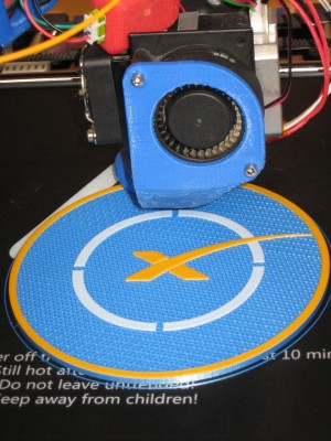

Decided to print a pre-sliced model G-Code from Prusa Printers.
It printed perfectly. Now I need to go through the Modifier meshes tutorial to see how I can do this myself.
Printed On MY Hictop 3D12

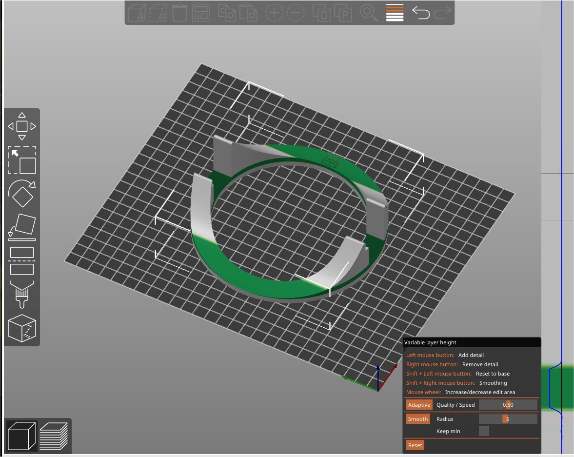

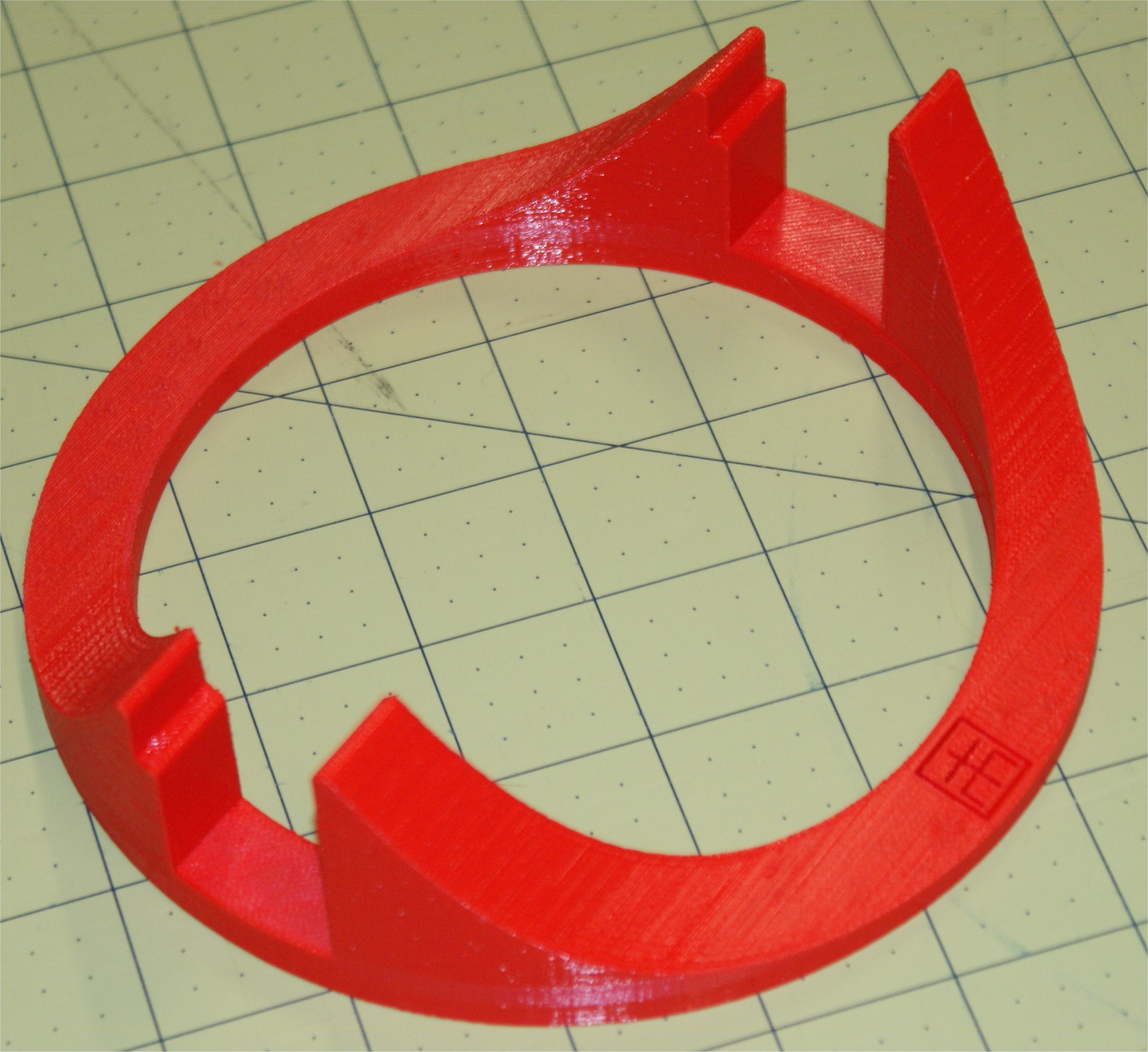

When slicing this Tablet Holder it would require a print time of 7 hours 19minutes to print model.
Slicing with a 0.24mm the print has a stair stepped ledge in the area painted green.
Using PrusaSlicer this area is used as a modifier where I can change the layer height to .06mm in the green area.
Thereby changing the print time to 3 hours 20 minutes. With a print model that looks much smoother and quite nice.
