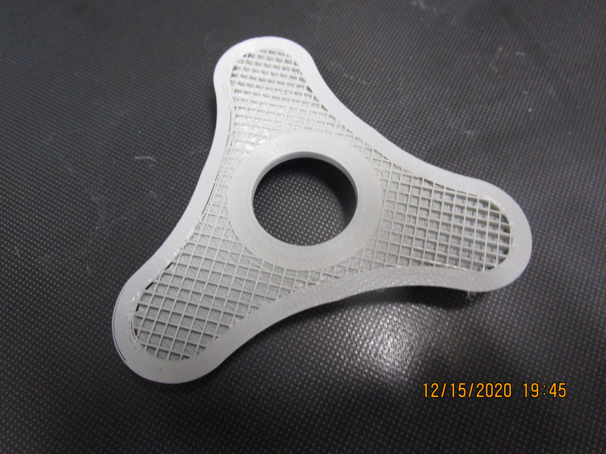

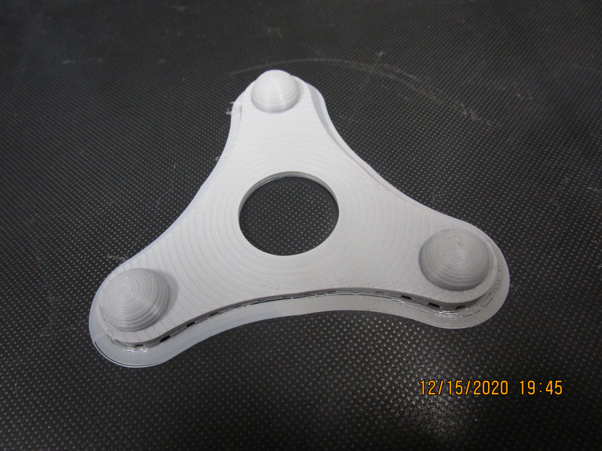

Hello Forum,
I am new to 3D printing but not CNC Mills or CNC routers. I have a new Sovol SV03 that seems to be printing well with PLA.
I want to print a model that does not sit flat on the build bed. I have tried two different set ups in Cura and each time the supports
ruin the bottom of the print. First try I used Tree supports. Second try I used grid supports, not shown. I tried one time to print
in a vertical and that was a disaster. upper 1/3rd was distorted despite having supports.
I have gone over DrVax's videos but he doesn't show the type of challenge I am facing. A flat shallow part that has an small angle
overhang above the build surface. I have set Cara to "Expert" mode so I have access to all the parameter settings. I would like a smooth
bottom surface with the print lines being concentric, not in alternating layers of concentric lines and then perpendicular lines.
Any positive, helpful suggestions will be appreciated.

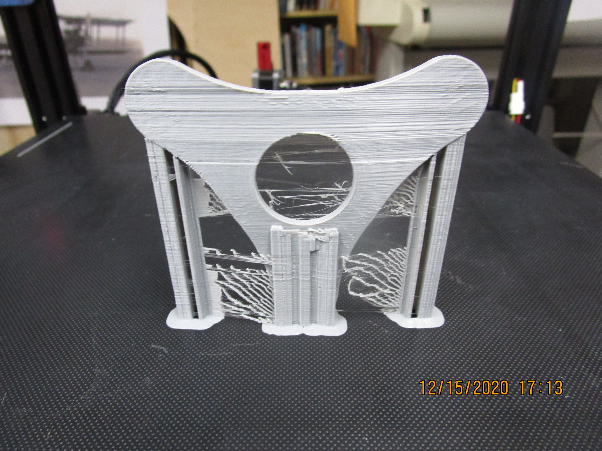

Re: Need Help with Supports
I am looking at your photos and believe you have more problems than the support.

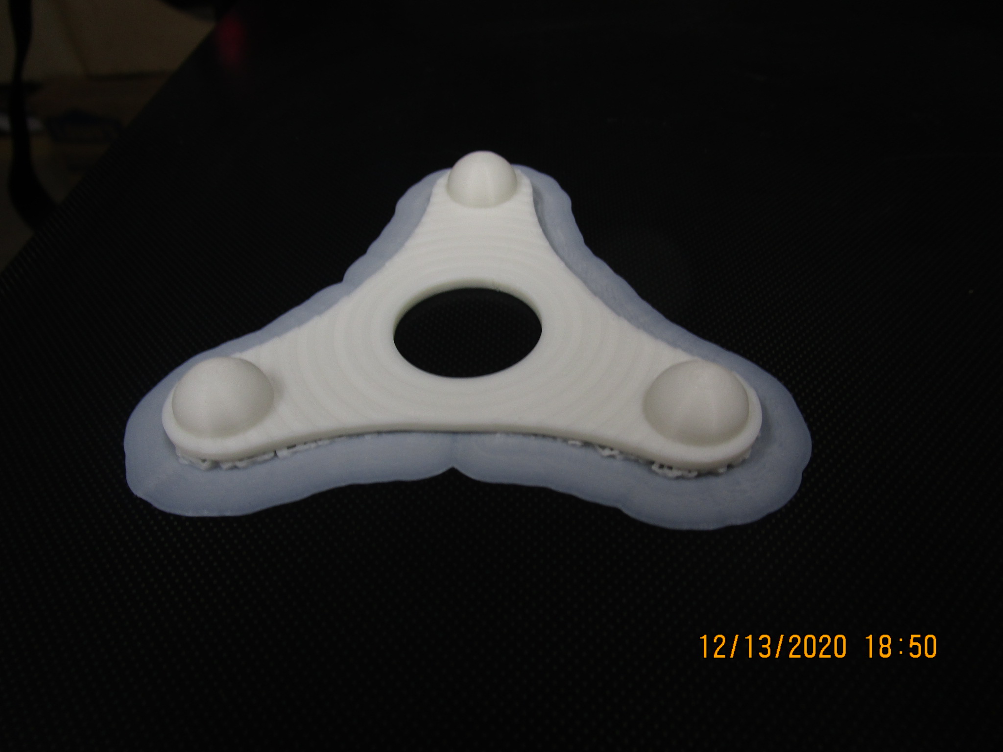

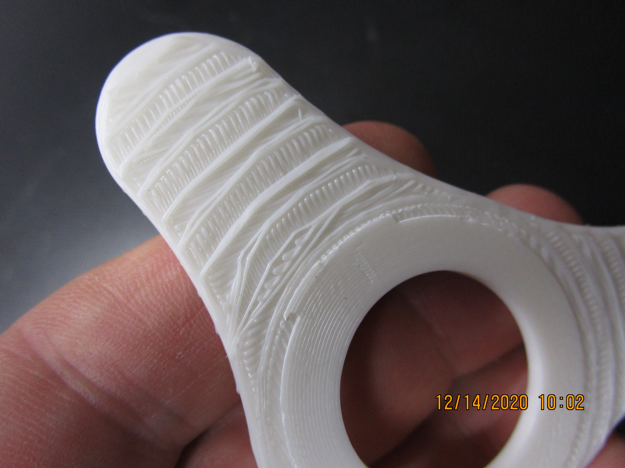

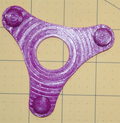

This is my 3rd attempt at this part. Top surface is acceptable "B-" and the bottom where the supports of a different design is terrible.
The print line would be acceptable but for the supports residuals left behind after I carefully removed them. (not shown) I have tried
sanding the bottom and that just causes more problems of removing some of the print lines.

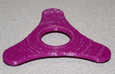

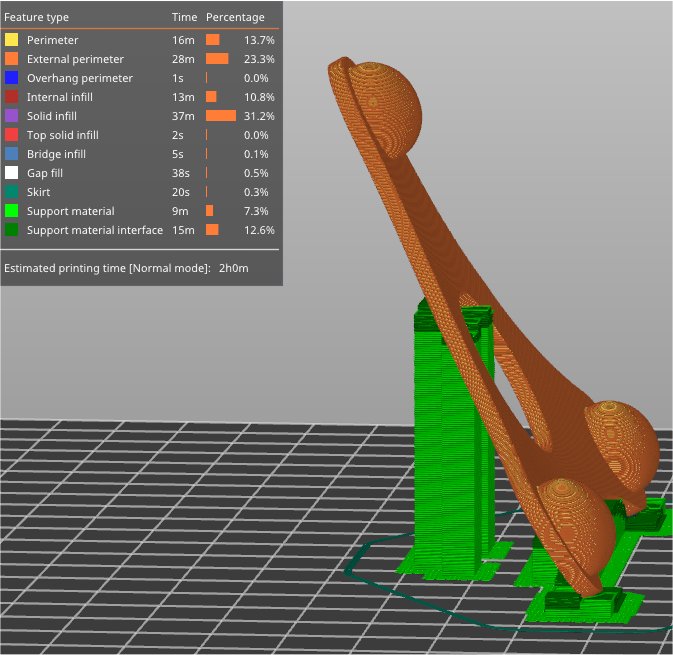

I am looking at your models and it appears that you have not removed the Supports from Dec 16, 2020 post
I sliced with Prusa slicer 2.3.0 beta 4 and came out with this .2 mm layer height.
Models have not been cleaned I only removed the Supports.
The continuous arc on the model is making it difficult to slice without the stair step artifacting on top an bottom surfaces.
Still kind of rough trying again using .12mm layer height. Now to Print this one.
What is this Model purpose.
Prusaslicer video here

Just a few minutes ago I started another Print this time I leaned the Model from a standing vertical position at a 30 degree angle.
I am so sure this will work that I am posting the Prusaslicer 3MF file.
Will try "barbarian units" It works, I have always scaled by 2540 percent.
In Prusaslicer the metric to imperial is automatically asked upon loading a model that appears to in imperial units..
Also tested sliced with Cura 4.8.0 using the same tilt and the estimated print time was 1 hour 37 minutes.
With Skirt and Raft

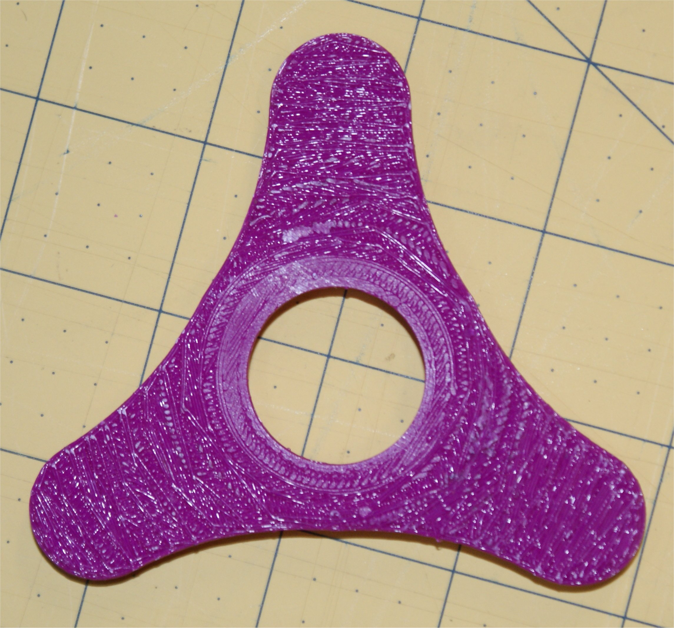

Model finished Printing with near perfect results.
My suggestion is to use your slicer stand the model at an angle of around 30 degrees.
Unless you would like to try Prusaslicer configured for your Printer.

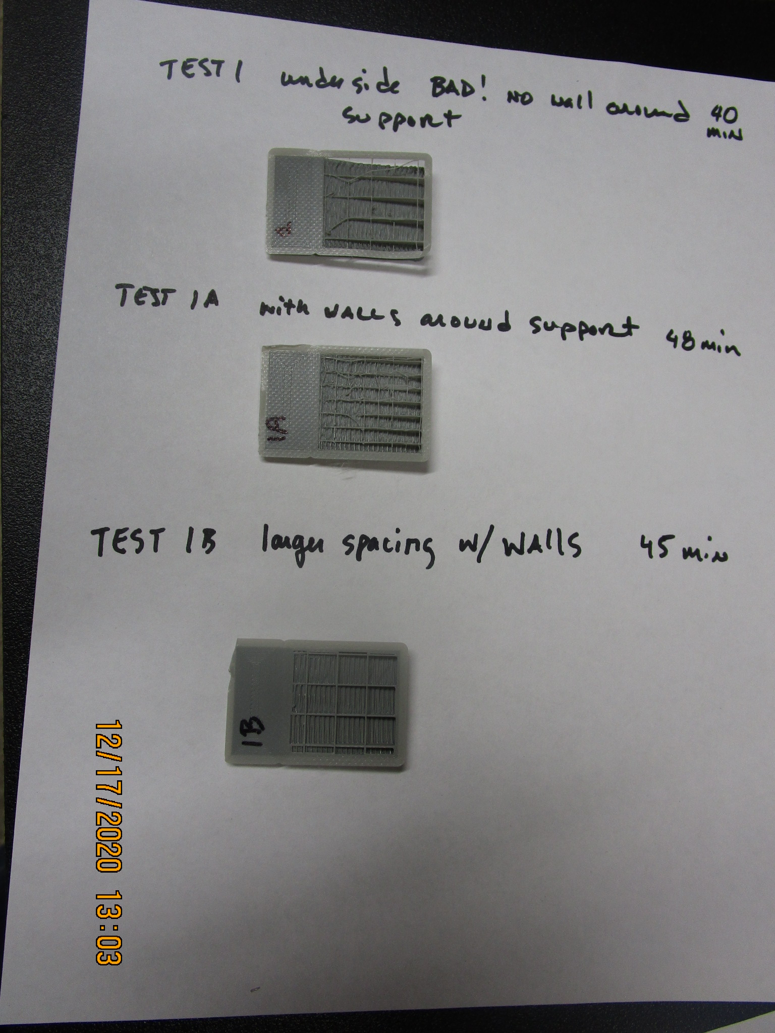

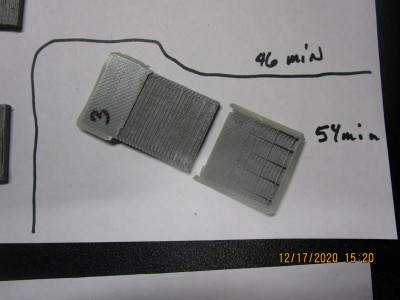

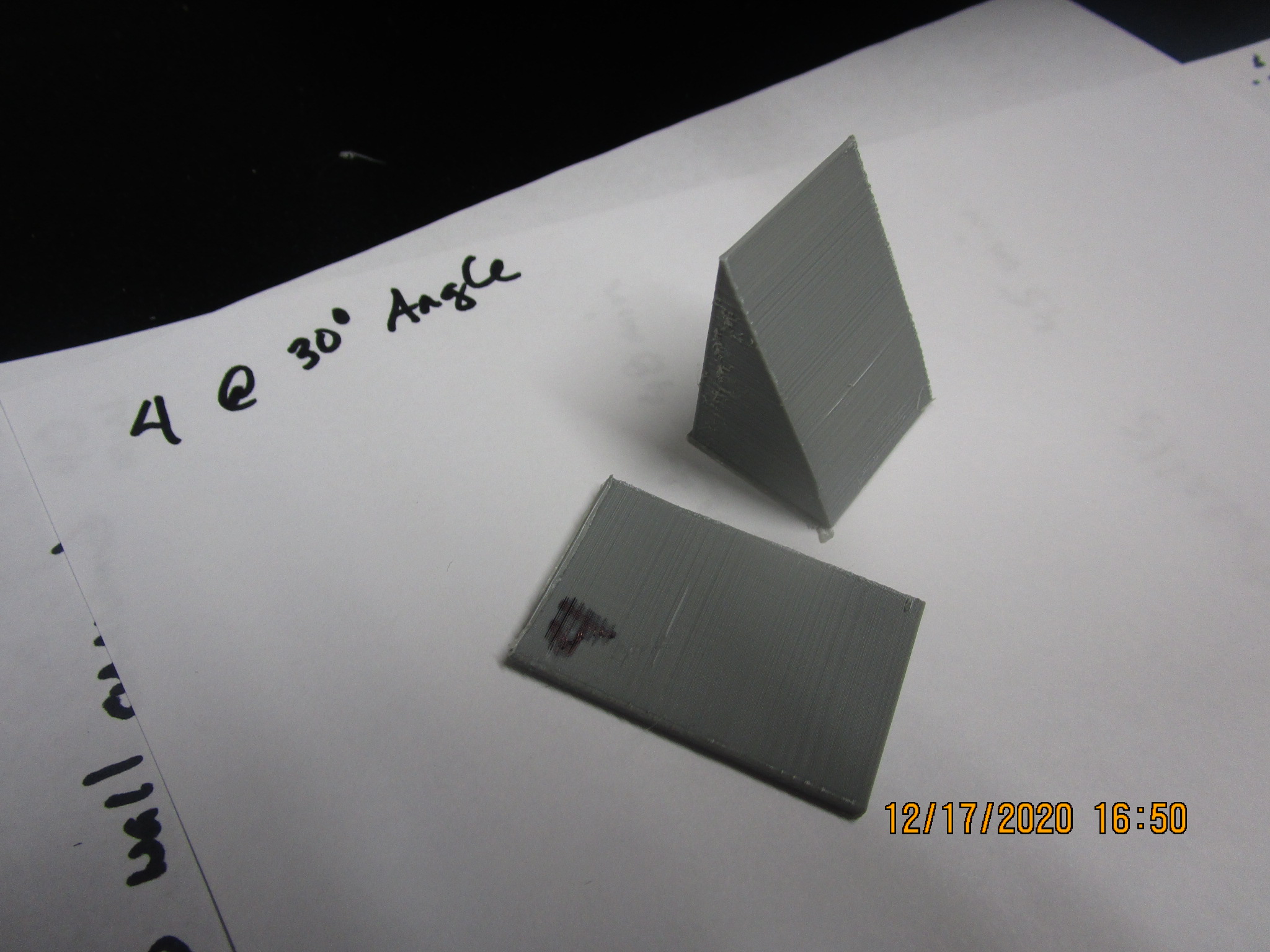

Thanks for the help. I ran 6 tests today with a smaller sectional of my part and all the ones done in a horizontal to the build were bad.
Even used the Roof and Floor setting. Was better. After you suggested it, I tried the same test section at 30 degrees it it came out the best. See pictures for reference. All are showing the underside of the part that I have to have smooth/finished Cismontguy
