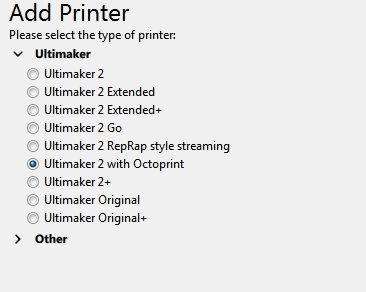

It is in the printer definition. We need nallath to confirm, but my understanding is that for this beta you cannot change it form the UI, so you need to change in the printer definition file, or better make a new one (very easy with the 'inherit' cabability)
Here is my take on this:
I created a new printer file ultimaker2_octoprint.json:
Code: Select all
    "id": "ultimaker2_octoprint",
    "version": 1,
    "name": "Ultimaker 2 with Octoprint",
    "manufacturer": "Ultimaker",
    "author": "Ultimaker",
    "icon": "icon_ultimaker2.png",
    "platform": "ultimaker2_platform.obj",
    "platform_texture": "Ultimaker2backplate.png",
    "file_formats": "text/x-gcode",
    "inherits": "ultimaker2.json",
    "machine_settings": {
        "machine_gcode_flavor": { "default": "RepRap (Marlin/Sprinter)" },
        "machine_start_gcode": {
            "default": "<copy here what you have in Legacy Cura>"
        "machine_end_gcode": {
I don't have an UM2, so I don't know which start/end G-Code you need, but just copy what you have now in Legacy Cura.
All the G-Code needs to be on one line, lines separated by '\n', just like this (from UMO):
Code: Select all
"default": "M104 S0 ;extruder heater off\nM140 S0 ;heated bed heater off (if you have it)\nG91 ;relative positioning\nG1 E-1 F300  ;retract the filament a bit before lifting the nozzle, to release some of the pressure\nG1 Z+0.5 E-5 X-20 Y-20 F9000 ;move Z up a bit and retract filament even more\nG28 X0 Y0 ;move X/Y to min endstops, so the head is out of the way\nM84 ;steppers off\nG90 ;absolute positioning"
Then restart Cura and add a new printer:
Add printer
Add printer
and you are done...
