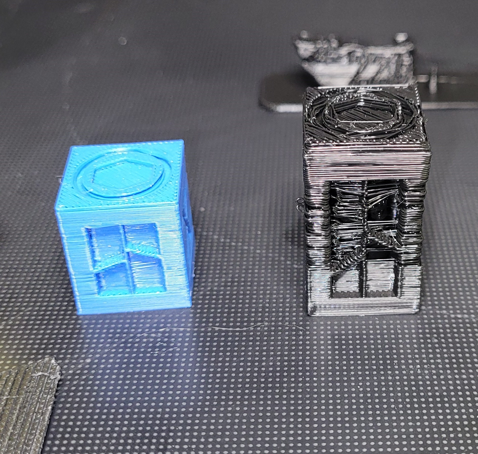

I am having a problem printing more complex models. Seems to be models where the head has to raise / transition / drop. The drop seems to not always happen and the print becomes like "wicker".
Here is an example. The blue block was on the 8 bit board and the black one is afterwards. Note that the finished height seems to indicate that I am adding layers somehow:

I placed one of the blocks and one of the "z towers" in the same print and the tower built fine until what I am presuming is a layer plus without a minus.

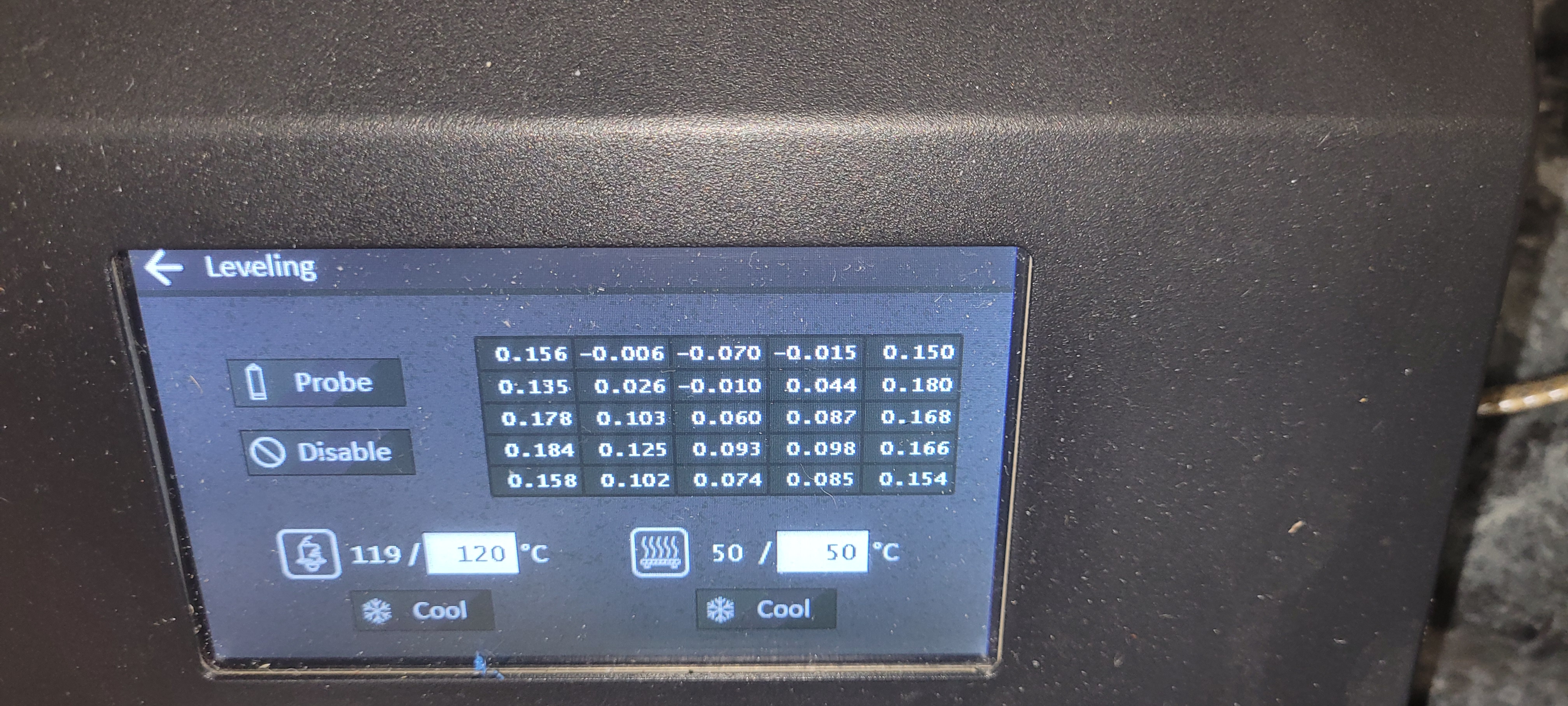

Here is my leveling screen for grins and giggles.

It was the slicing software.
I was slicing using Bambu Studio. I downloaded UltiMaker Cura. Sliced with that and it is printing correctly....
There must be some setting in there that my printer does not like.
