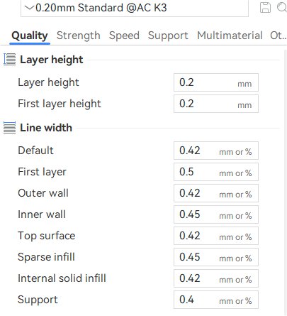

I also note that using Anycubic slicer next that these stock settings suggested could cause Elephant Foot
My Kobra configuration got messed up and this was the only thing I could find to correct it.
I now know could have fine tuned the Z-Offset through the slicer. One day may discover how to fine tune on the printer itself.
How to Fine-Tune Z-Offset on a 3D Printer.
