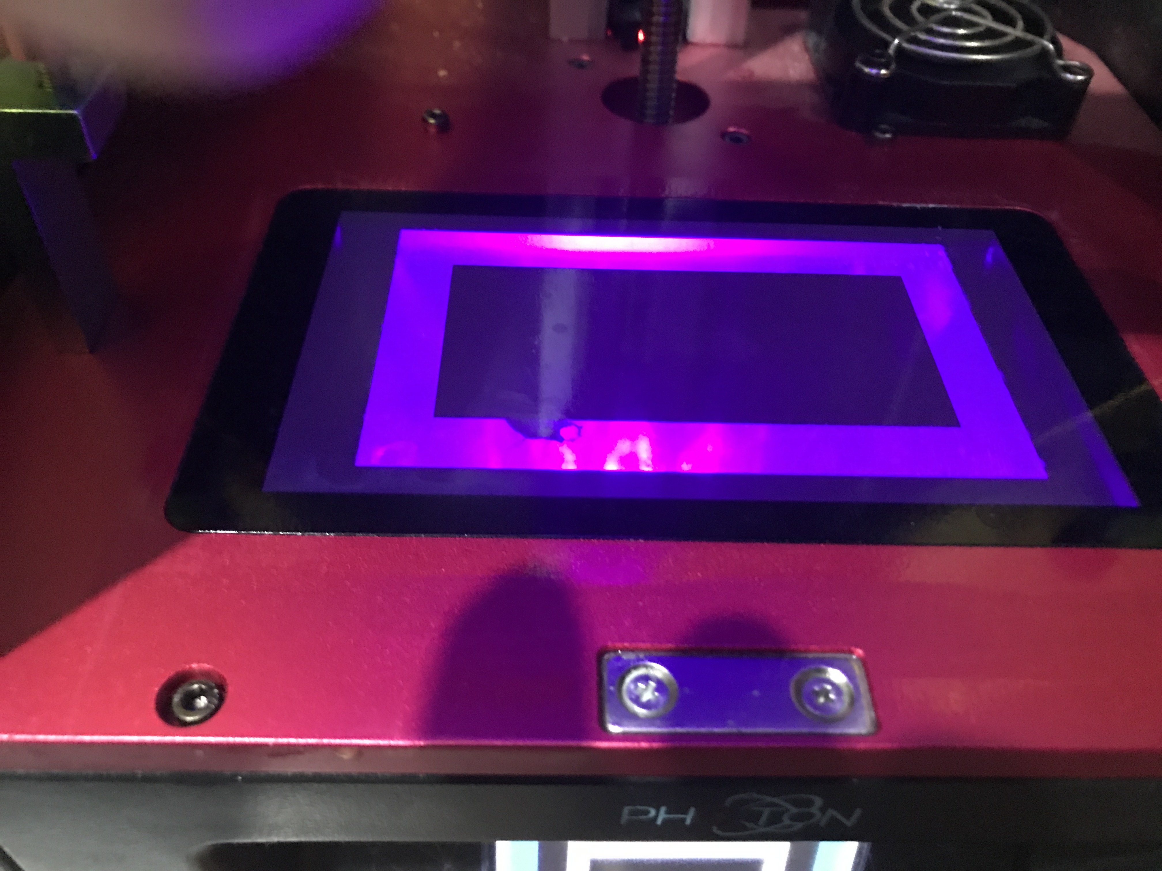

I have an Anycubic Photon.
This is my screen shot taken at an angle. It has a bad area at the front to the left, but still works on smaller prints.
I hope this helps.

To anyone who may read this post in the future the problem was with the LCD.
Managed to replace it and do all the necessary calibrations and it works great now.
