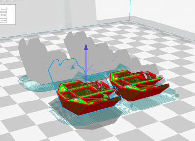

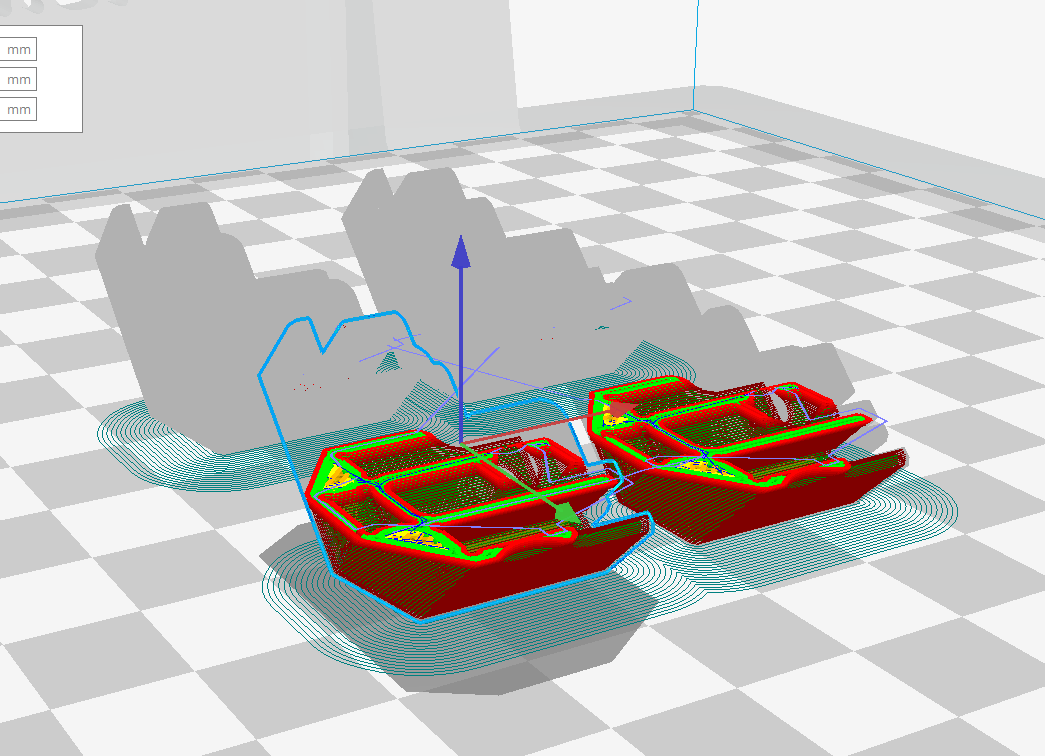

1. When you create a new profile with UMO and select "Have HBK", the Temp for HB settings does not activate. After going to Machine Settings and enabling the HB again, it works. Tried twice.
2. If you group objects, the layer - view produces strange things, see attached picture. top is grouped, bottom is ungrouped. Thanks!
Martin
I am really impressed by the speed improovements, rendering speed of the layers! Great work, well done.
I just tested a few things and had to start fresh (deleted the old cura profiles, settings) as it generated some wierd behaviour with profiles coming from 2.1.2.
Great to see that the machine profile is improved! Especially from UMO Users

Re: 2.3 beta
@martin-bienz
I can't reproduce the layerview issue. On what OS are you doing this? Could you send me your logs as well?
I have been able to reproduce the heated build plate issue. Will put it in the issue tracker.
johan
- Posts: 27
Re: 2.3 beta
@nallath: I think it's an issue with the lack of transparency in OpenGL. Related to the ghosts.
