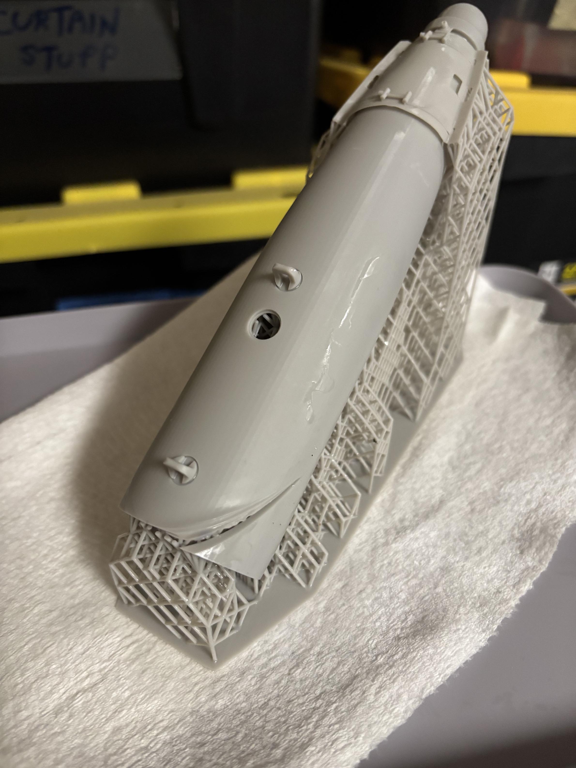

I have tried several times and the print splits toward the build plate. The tube is hollow, so I don't think it's a suction issue. Any idea what might be causing this, appreciate the help.

I'm using Sunlu High Toughness Resin, the printer has a heater and the resin is a constant 76F, calibration indicated a 2.2 second layer exposure was best. In my garage with the door closed and lid down so no breezes.

Could you show a side view, as if you are looking directly at the printer.
I had a problem like this a while ago, I think it was a support problem, they were too thin.

Thanks for the reply, here are some more views

I think the part might be flexing while printing.
Try thicker supports.

in my experience cracking can sometimes be from Lack of Support
