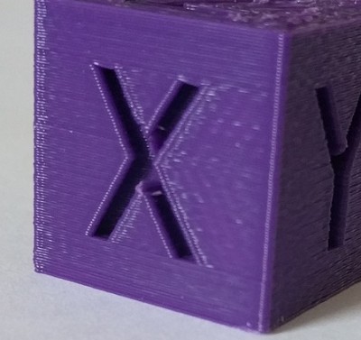

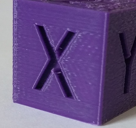

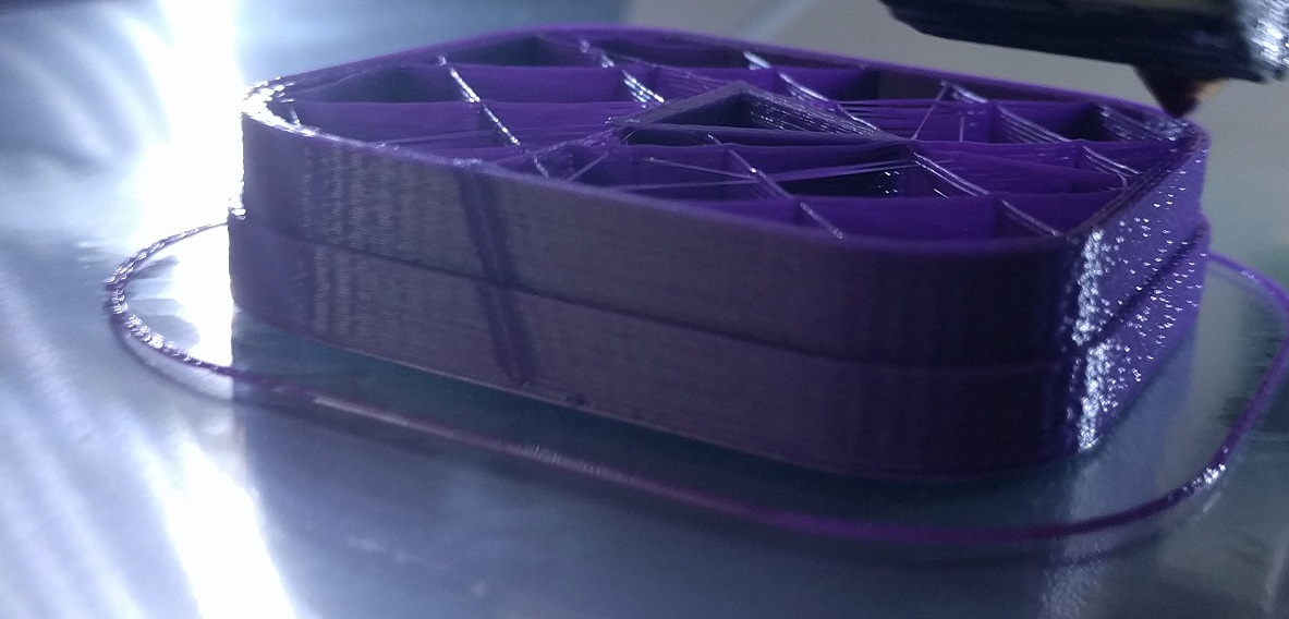

But if i may ask your experience with layer blobs
Since the beginning i have had big blobs (the layer start/end) on layer changes... It was bad at the beginning but came to make my current status and cant seem to get it any lower or less noticeable.
If i print a 20mm test cube, the zits are barely noticeable.. If i print a normal piece, its very noticeable. Let me show u some pics
Currently i have 3.5mm retraction at 60mm/s. Print temp is right on range for filament. Noticeable if i print layers first or layers last...
I know it has to be software related. The .hex file HIC gave me, has very little blobs, but as u know, i really cant open it to check the settings.
If i change the layers to random, it really makes it look bad, as u got zits everywhere rather than linear. If i use craftware, it also has smaller blobs than slicer. But i really like using a host, and not have to be using an SD card all the time.
What else can i change in firmware to make it less noticeable?

I just trying to keep my prints from showing this ugly vertical scar along the layers

I bet if you print at 40-45 mm/sec a lot of those banding lines go away

I have found what i think was the problem. And i am comfident it was the stock hot end .
The heatbreak part of the extruder is too big and too much filament was too soft... I am using an E3Dv6 now and these blobs are gone. Not to mention i did use wipe settings, and retract a bit more and faster now.
