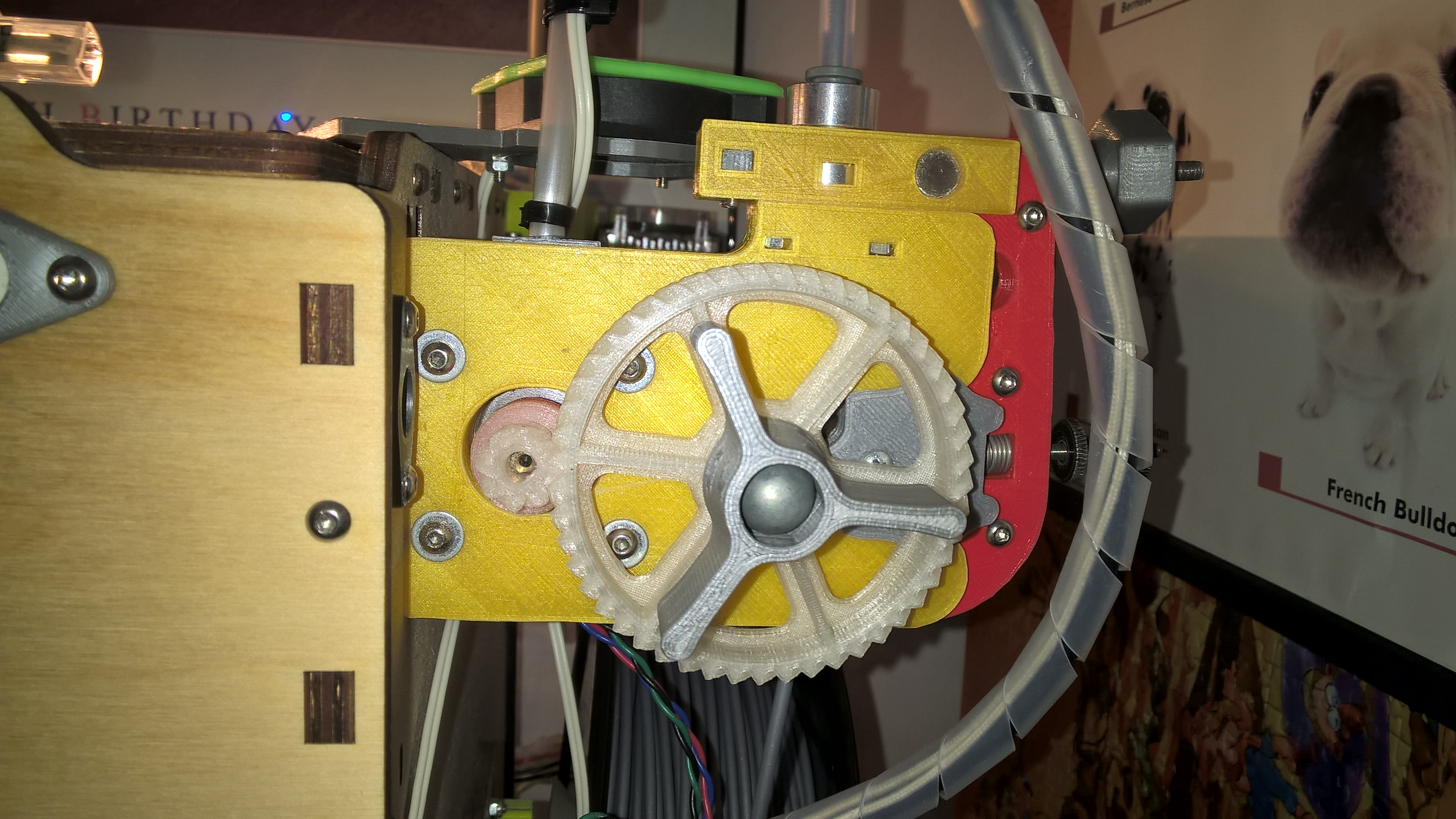

In my strive to improve the performance and reliability of this extruder, I began re-designing it and here's my version of this design: https://www.youmagine.com/designs/modif ... iklesys--2
This is how it looks now: It's now much better as this spring design puts constant pressure on the filament.
Additionally I re-worked the top-mount to use a groove-mount addon for the bowden tube, so it's now really easy to plug in and out.
The groove-mount piece can be bought here: http://e3d-online.com/Mechanical/Bowden ... m-Filament
The Gear Grip design instead can be downloaded here: http://www.thingiverse.com/thing:38311
A benefit of this extruder design is that it now should work flawlessly with both 1,75 mm and 2,85 mm filaments by just swapping the groove-mount adapter and the bowden tube.
This is compatible with the stock gears, but I prefer using this design: http://www.thingiverse.com/thing:40334/#files
These herringbone gears reduced a lot the wobbling and increased the precision of the feeder.

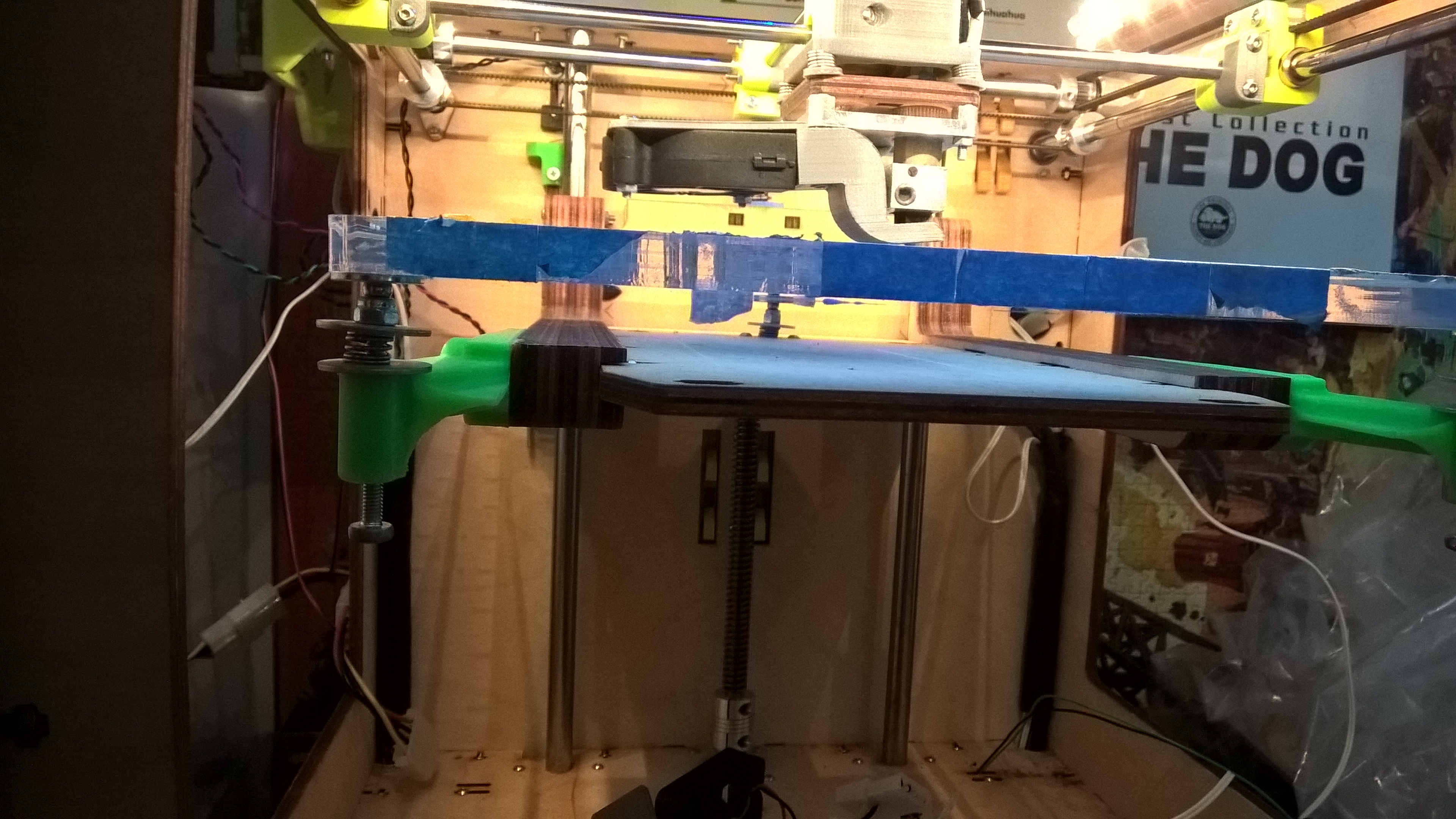

For the bed I went through a series of small improvements.
First I switched to a 3 point leveling system. I still have to switch to a heated bed, but that's still work in progress (waiting for budget).
The bed is held in place by 3 magnetic spheres so it's also easily removable and the Z screw coupler was changed.
The design I used for the 3 points bed levelling system is: http://www.thingiverse.com/thing:84754
Edit: May 2016
Printed also 2x https://www.youmagine.com/designs/weigh ... iginal-bed and fill them with lead weights
I then purchased 1kg of lead for sub belts and cut it in even pieces to fill the weight pockets

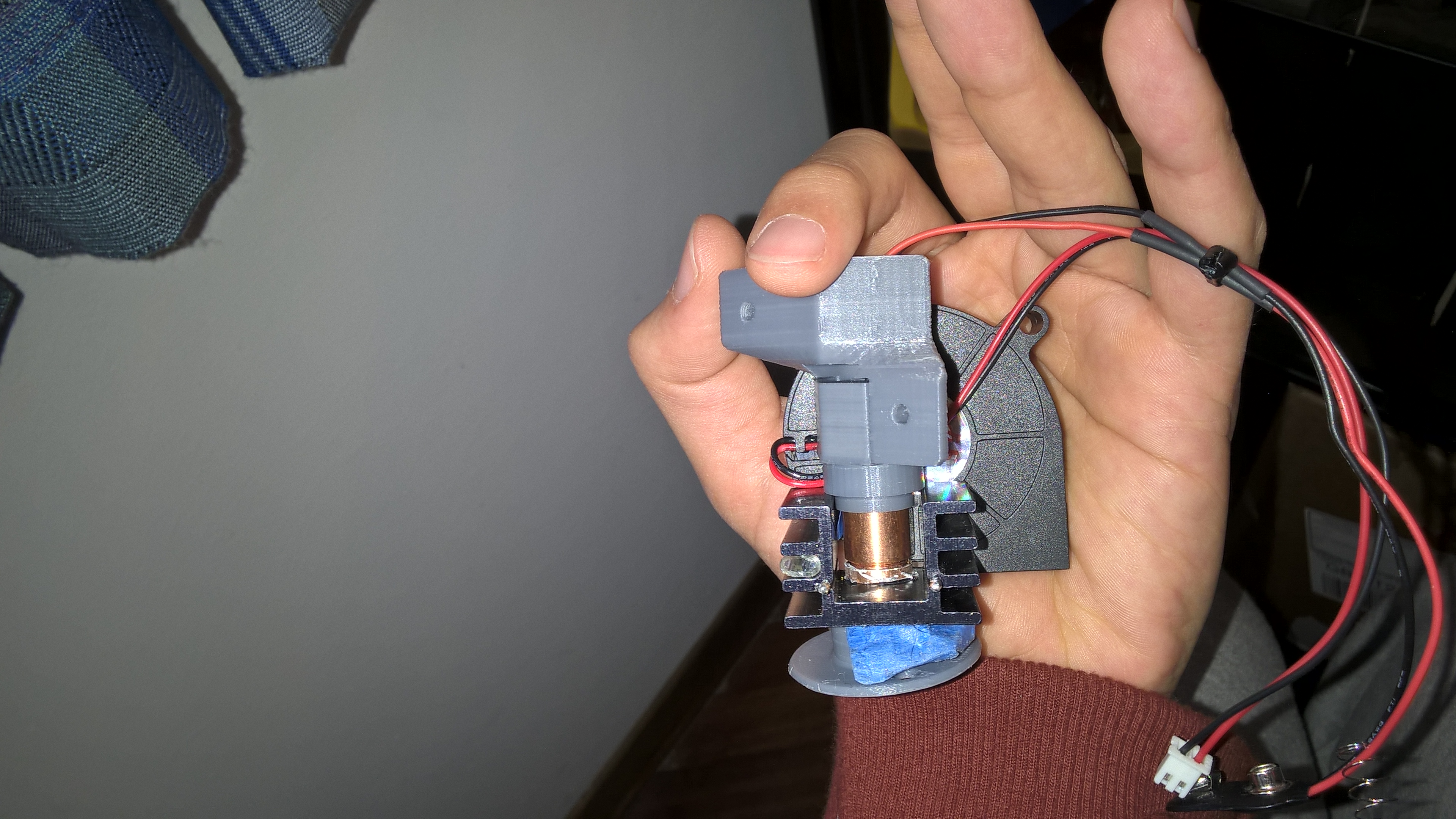

Print Head:

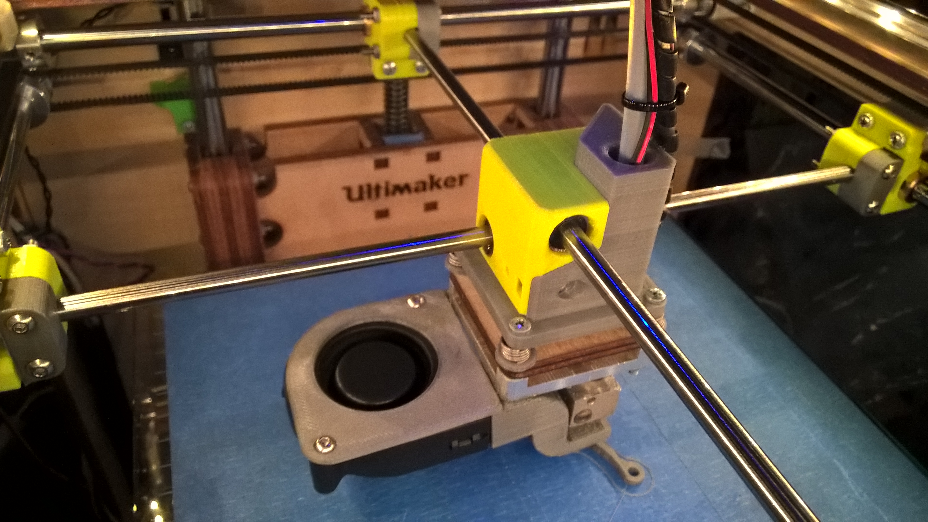

For the print head, I switched to an impeller fan using the design: https://www.youmagine.com/designs/ultim ... er-fan-mod
I then wanted to use a more modular design which allowed me to switch between hot-ends in an easy and quick way, so I decided to use this design for the bushing part: https://www.youmagine.com/designs/uliti ... erlin-ubis
and I designed an adapter which could work with the stock UMO head and make it easily swappable and also faster to disassemble, so I came up with the design for this adapter: https://www.youmagine.com/designs/modul ... ck-hot-end
The other head I wanted to use for now, is the laser.
To mount the laser with the moduler print-head I used this design: https://www.youmagine.com/designs/foehn ... v6-adapter and printed a groove-mount which grips directly on the laser tube.
Now my UMO can quickly switch from 3d printer to laser cutter with just the removal of 2 screws.
Update 13/06/2016
The print head doesn't look any-longer like this.
I now switched to 1.75mm filament using an E3D universal 24v hot end with PT100 upgrade kit.

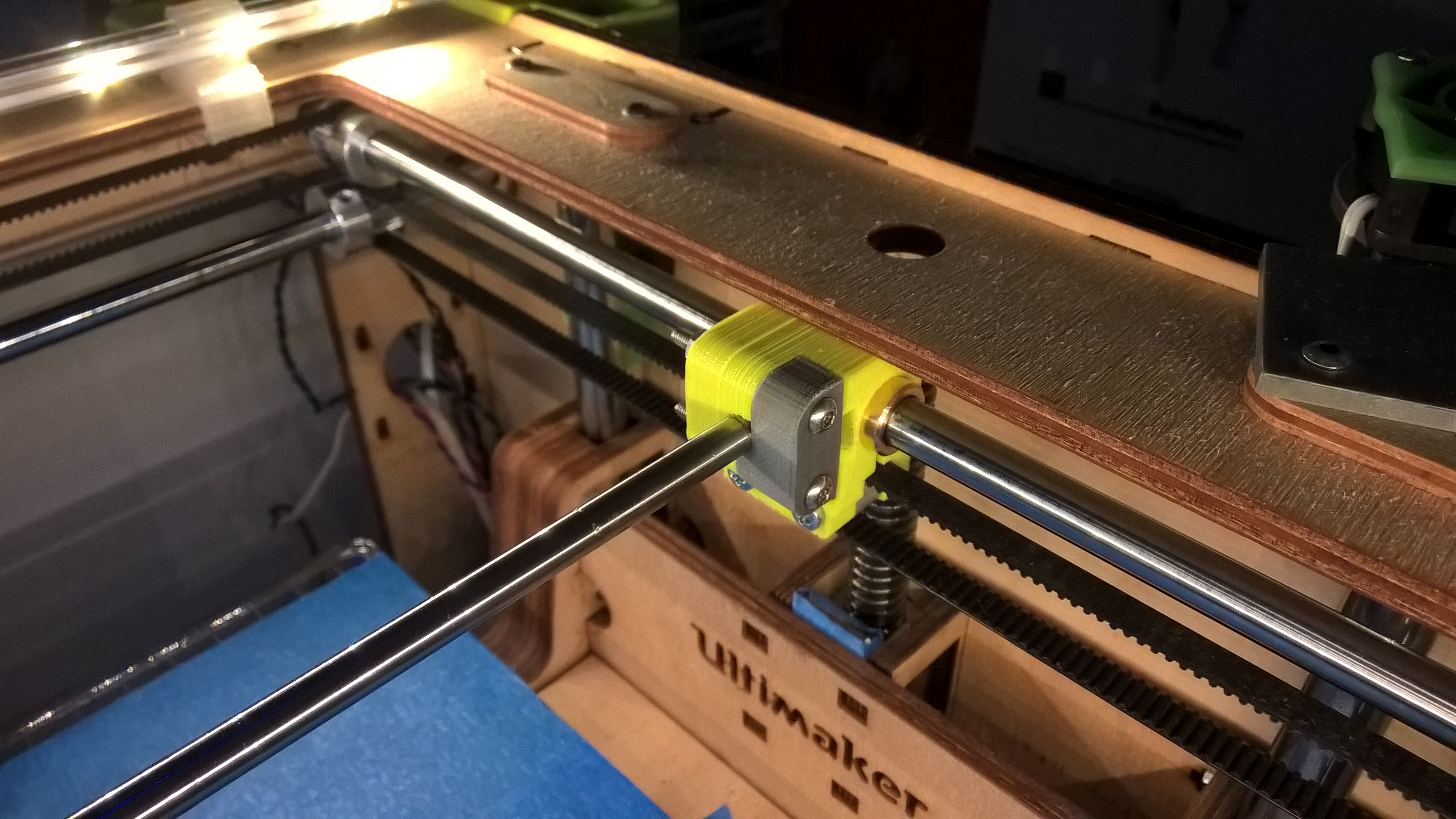

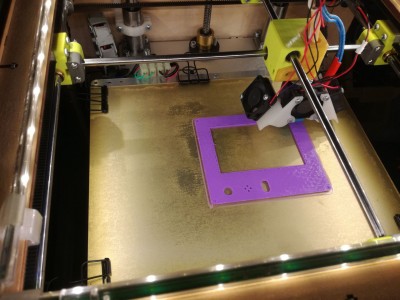

X/Y Axis
The X/Y Axis went through several modifications.

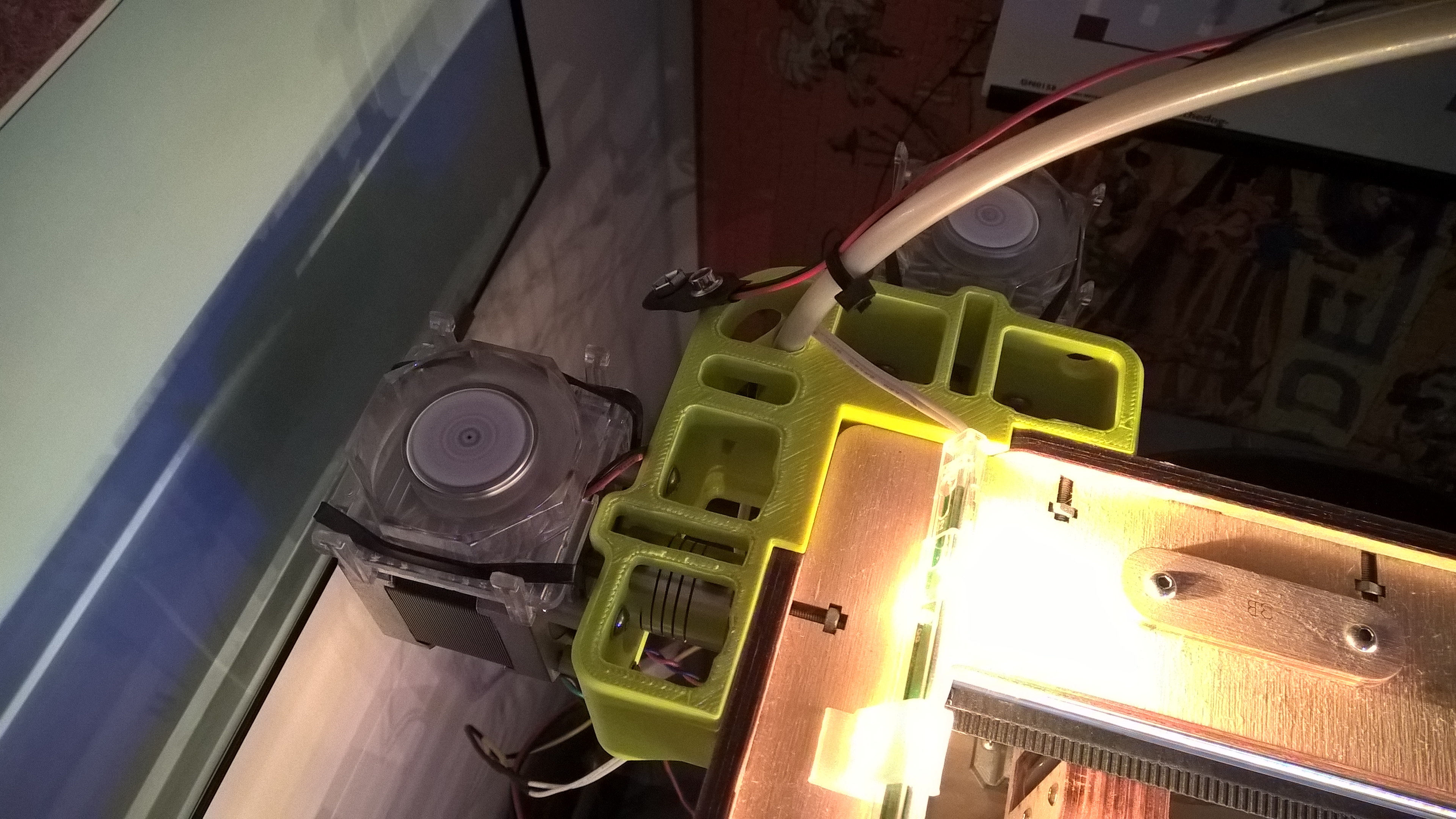

1- The default belts and pulleys have been switched for GT2 Belts/Pulleys
2- Actively cooled direct drive! No more ovals (and the adapter mounts on the back corner instead of the front corner): https://www.youmagine.com/designs/motor ... lternative
The cooling fans are directly attached to the IKEA led stripes.
This direct drive setup doesn't require you to use any additional hardware, but recycles the stock axes of the machine.
This is done thanks to printed bearing adapters which make the axes shift forward, this can be seen also in this picture.
The design for these spacers can be found here: https://www.youmagine.com/designs/beari ... m-original

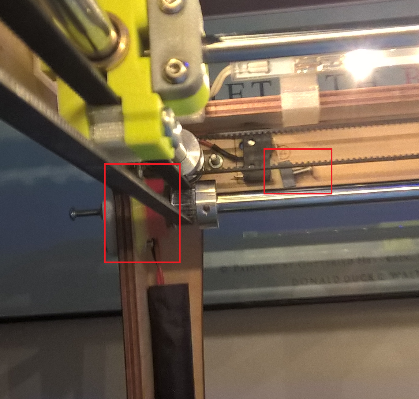

Additionally I printed an end stop-adapter to compensate for the different print-head I currently have mounted.
I highlighted both those adapters in this picture:
To remove the friction between the axes and the end-caps, I've also been using a similar version ( C shaped instead of O shaped) of these rod-spacers: https://www.youmagine.com/designs/ultim ... rod-spacer
3- Twister blocks (modified for graphite bearings) : https://www.youmagine.com/designs/twisterblocks
Those blocks allow to quickly remove the smaller axes without having to mess with the belts and other annoying things.
4- Graphite self-lubricating bearings: http://www.robotdigg.com/product/175/Se ... Bearingthi
Huge thanks to Chopmeister for the twister blocks and the motor corner designs!

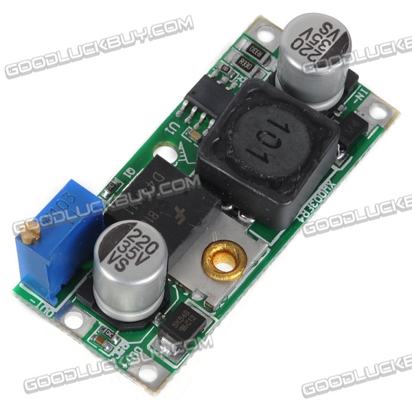

24V capability:
Replaced the LM7812 on the UMO electronics with a DC-DC converter. This allows me to plug anything from 19V to 24V in the PSU socket and the printer will just work (ofc I will need also to have the appropriate heater cartridges and temp sensors or they'll not work properly)

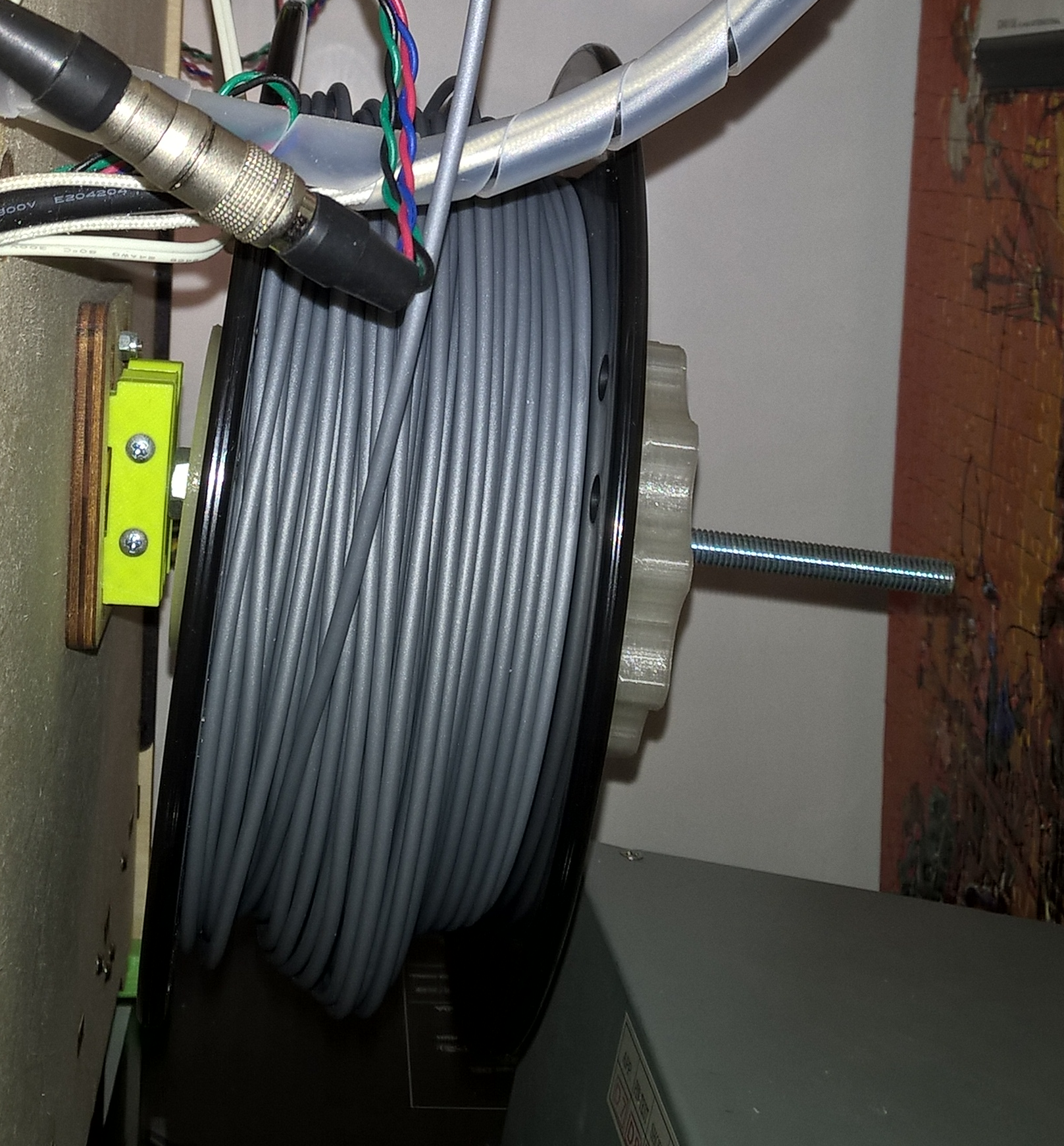

Spool Holder:
As the original spool holder wasn't a great thing, I replaced it with this awesome design: https://www.youmagine.com/designs/low-f ... poolholder
This can be seen here: As this design is only for UM2, I designed and printed myself an adapter so it could be fit on the UMO.
If anyone needs a similar design for the adapter, you can also print the mount from this design: http://www.thingiverse.com/thing:262924
The difference with this design and my design is that this design is made out of 2 pieces and the printing direction is not 100% optimal to give the piece a good mechanical resistance. My design instead is composed of 3 pieces which are printed in different orientations and it helps holding everything in place and can sustain a high amount of weight or mechanical stress.

1- Convert the printer from 19v to 24v. ---DONE
The first step for this operation will be done by replacing the LM7812 on the UMO electronics with a cheap DC-DC converted like the following one: The rest of the electronics works fine at 24V instead of 19V, but it will be required to change the temperature sensor and heater block.
2- Increase the reliability of the Z axis (probably will get the UMO hot-bed)

Update 22/06/2016.
5- Use a PEI printing platform instead of blue tape

Great worklog!
Spoolholder look not parallel to the backside of printer. It gives some benefits, or just a specific of adapter?
- antiklesys
- Posts: 183
Re: Several years worth of UMO hacks
It's just the adapter and the weight of the spool. No advantage, no disadvantage as of now.ivan.akapulko wrote:Great worklog!
Probably it's adding some additional force on the bearings but so far it's still frictionless

Update:
Currently in the works to switch to E3D Universal.
This will also result in me switching from 2,85mm to 1,75mm filament.
For now I will still use the original parts in the heater blocks, by running the printer at 19V, but I will make the first upgrades for a future switch to 12V.
The E3D head will not use run on the stock nozzle, but it will be immediately assembled with one of the Ruby Nozzles from Anders Olsson and the whole gantry block will be changed again. I can't yet share any additional detail regarding the gantry block as it is currently being discussed in a closed project, but I shall keep this thread updated.
