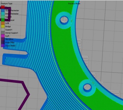

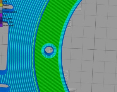

Hmmm. Looked good in preview mode
Perimeters/shells set to 6 6 and 6 as advised by thenpart designer.

Somewhere there is a %overlap so the infill goes further into the outline to help prevent this
Posts: 4077
Re: Hole gaps
Ah yes. What do you usually use for this?

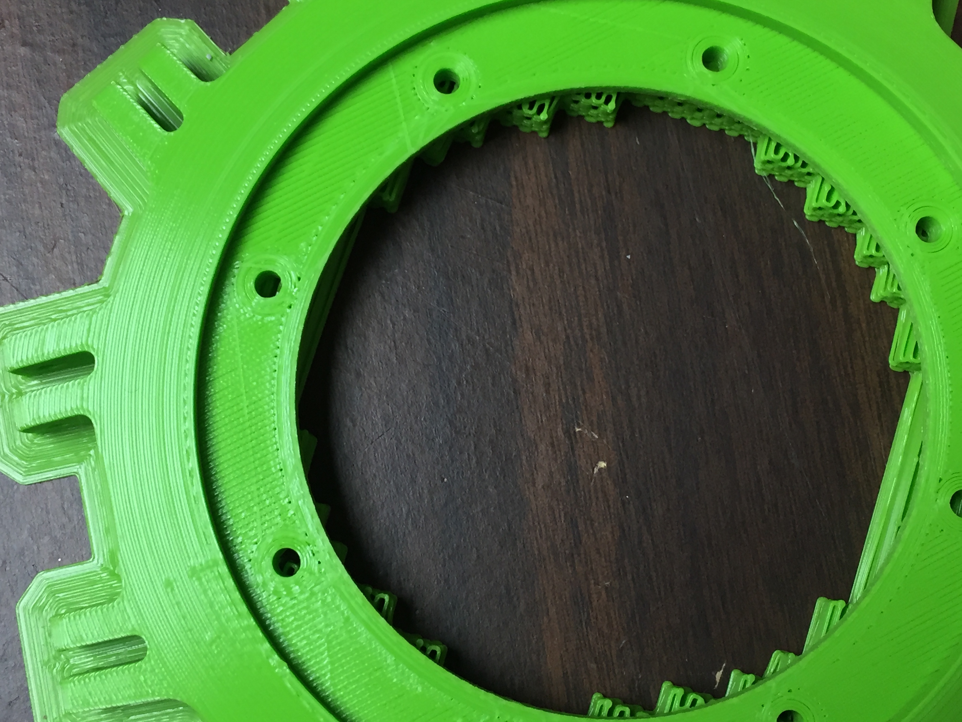

See with the bigger pieces I print, S3D has done well....if there are no holes. Then I run into this issue
If I use Cura, I run into the grinding over the surface...requiring some z-hop....which should really just be part of what Cura does! I'm trying this very print on Cura and from upstairs, I can hear it grind away on the surface. Very aggravating! One slicer won't do holes right, one will but drags across the surface!

Here's what 0.40 nozzle and 30% Outline Overlap did

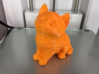

But here's the thing....only an issue on printing items with holes in S3D
Did the kitten print recently and it came out gorgeous!

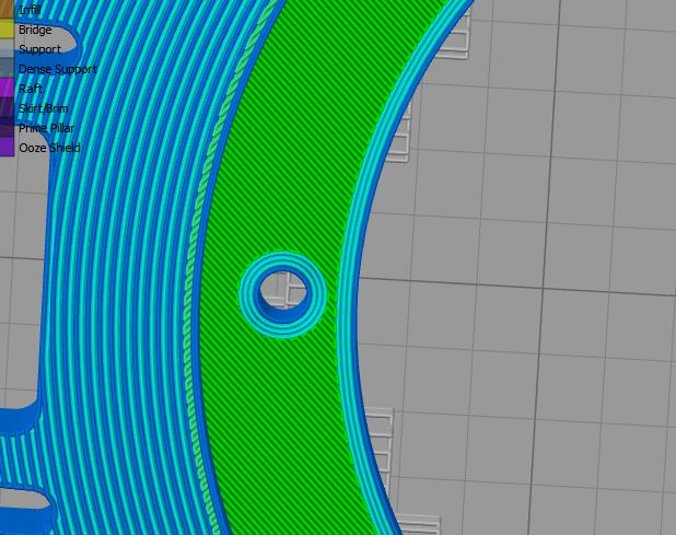

I'm seeing what 50% does in the preview now

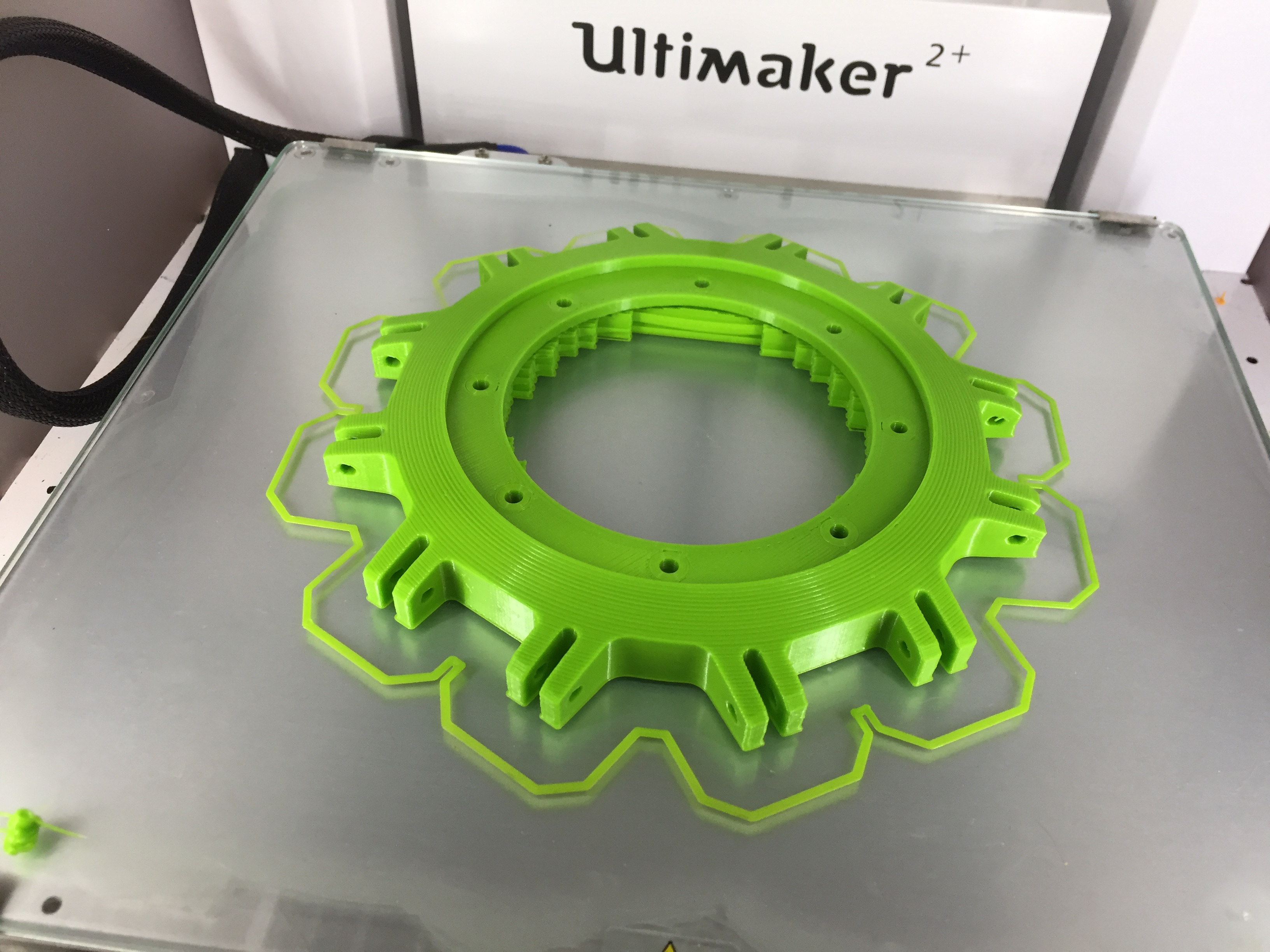

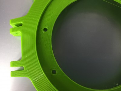

So here's what 50% Outline overlap looks like
I am starting to wonder if I have too many perimeters (The designer has top, bottom outline set to 6...since it's a structural pieces, he advised it for more strength)

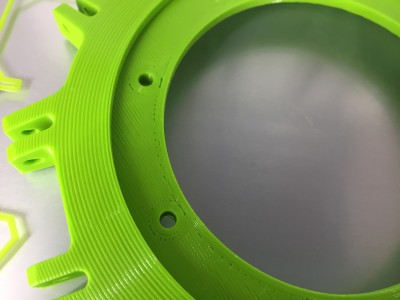

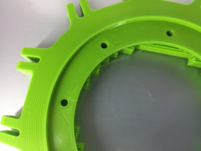

Yeah....it's definitely the perimeters...if I take it down to 4 (from 6) I get this...
