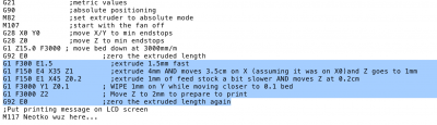

Note that the default (machine) starting sequence it's different on this profile, since I prefer to home the head, then the bed, then move down the bed 15mm, then extrude 9mm of filament to purgue, and then it goes to print.
And the ending gcode it will retract a total of 3mm.
This profile it's ready for 2,85mm users (I use 1.75) so probably the Coasting/wipe, should be higher on others.

A good starting gcode for um2 machines:
https://ultimaker.com/en/community/1607 ... ply-107897
