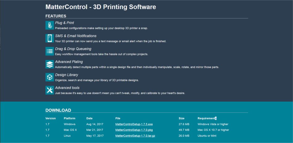

1.7.5 Windows Aug 14, 2017 MatterControlSetup-1.7.5.exe 27.6 MB Windows Vista or higher

It came up as an Automatic Update. You can look see on Matter Control Web Page.
It is on http://www.mattercontrol.com/
