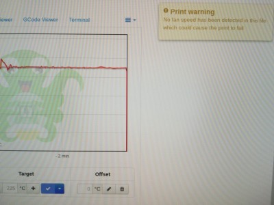

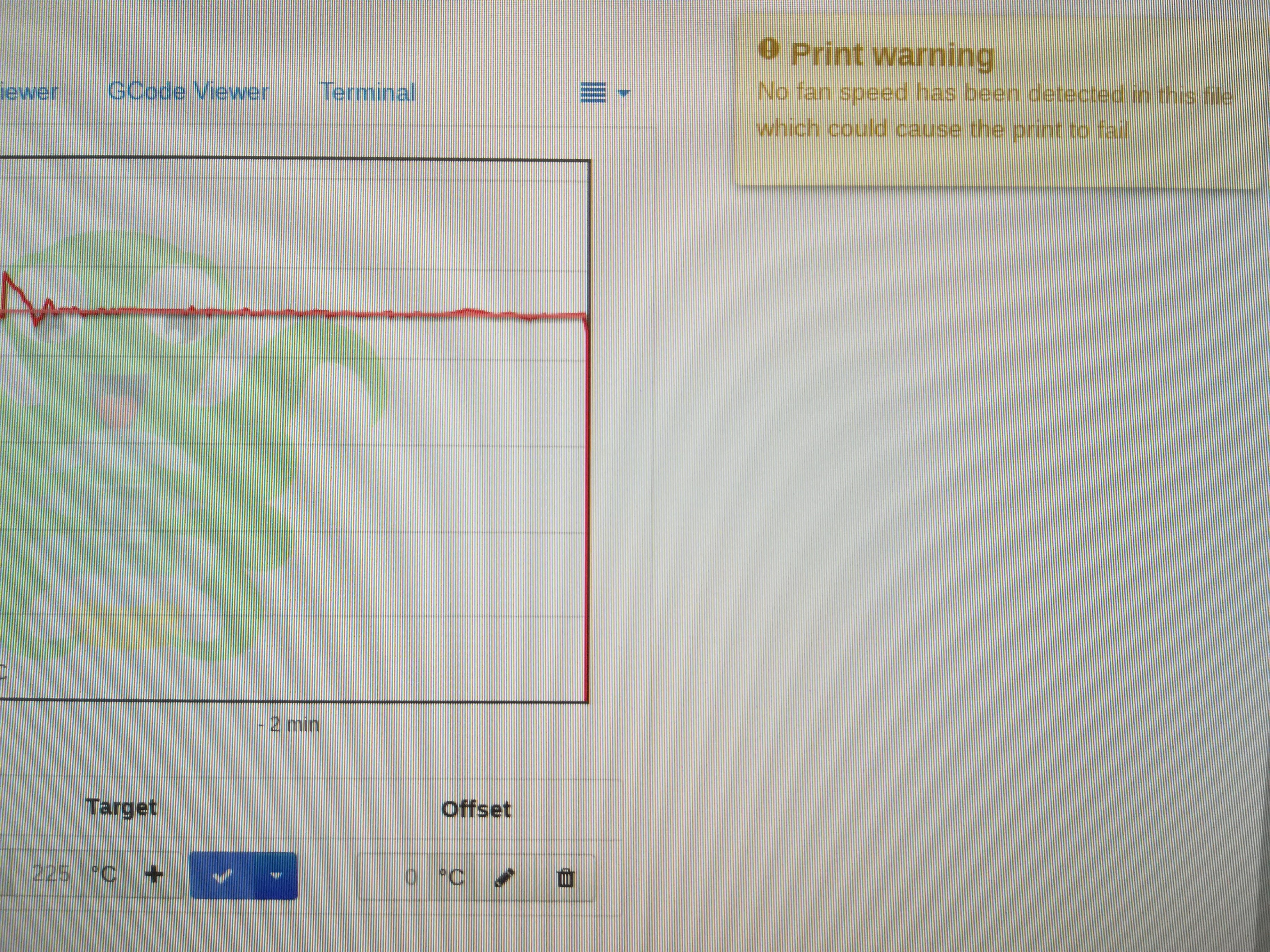

I run Octoprint on a Pi. Cura 15.04 is the slicer. After slicing I get a the following warning "Print warning No fan speed has been detected in this file which could cause the print to fail". I am 100% sure there is a line stating the fan speed. The fan doesn't start either.
Please help

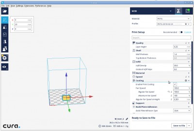

I have also tried to slice outside Octopi in Cura-2.6.2, with settings you can see in the attached file cura.jpg the result is the attached file M_test_2.gcode.
When I try to print that gcode file I recieve the warning about no fan speed.

I think I see the problem. Your screen shot indicates you have an M3D printer. I think this has its own custom fan gcodes. I did a little googling and found this link which includes a profile for Cura 15.04. Try importing that and see if it helps.
I also looked at your gcode, it does accurately turn on the fans after the first layer:
Beyond that, not sure what else to tell you.
