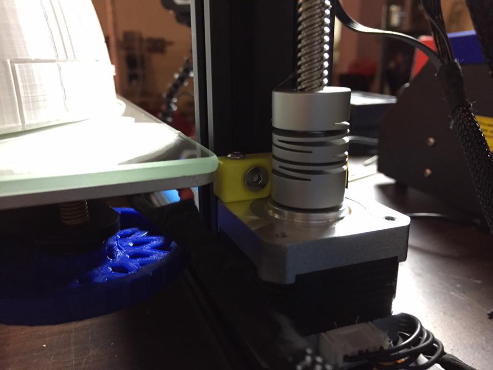

Lot's of people reporting issues with theirs....looks like mine is started to turn into a Slinky too

The remarkable thing is that the printer is doing some amazing prints, but I do need to replace this with something better.
Several others have had this happen and this seems to be the replacement they suggest.
http://a.co/dacDwfT
They also suggest making sure everything is aligned, checking that the z screw lines up with the stepper. Some use a spacer to adjust the motor over a bit. I am not sure if this happens in shipping, from being banged around....or poor quality control.

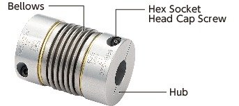

Make your choice - Choosing a Coupler
https://www.nbk1560.com/en-US/products/ ... epage_012/
MBB-C - Bellows-type Flexible Coupling " 1st Choice"
Most coupler's can be found here
https://www.nbk1560.com/en-US/products/ ... fgodMjII5Q

Omg, is someone seriously still doing that :D
It really doesn't take a rocket scientist to tell that using a flexible coupling there is a really bad idea. I'd also recommend an Oldham coupler similar to the one you found there on Amazon. Personally, I'd go with a quality brand product, but these things can be quite expensive (Misumi Oldham couplings cost 15+ EUR, and that's the "cheap" ones with grub screws instead of the clamping design).

I did suggest the MBB-C - Bellows-type Flexible Coupling " 1st Choice"
I agree buying a better replacement part is the way to go.
