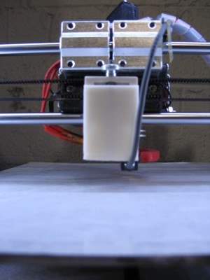

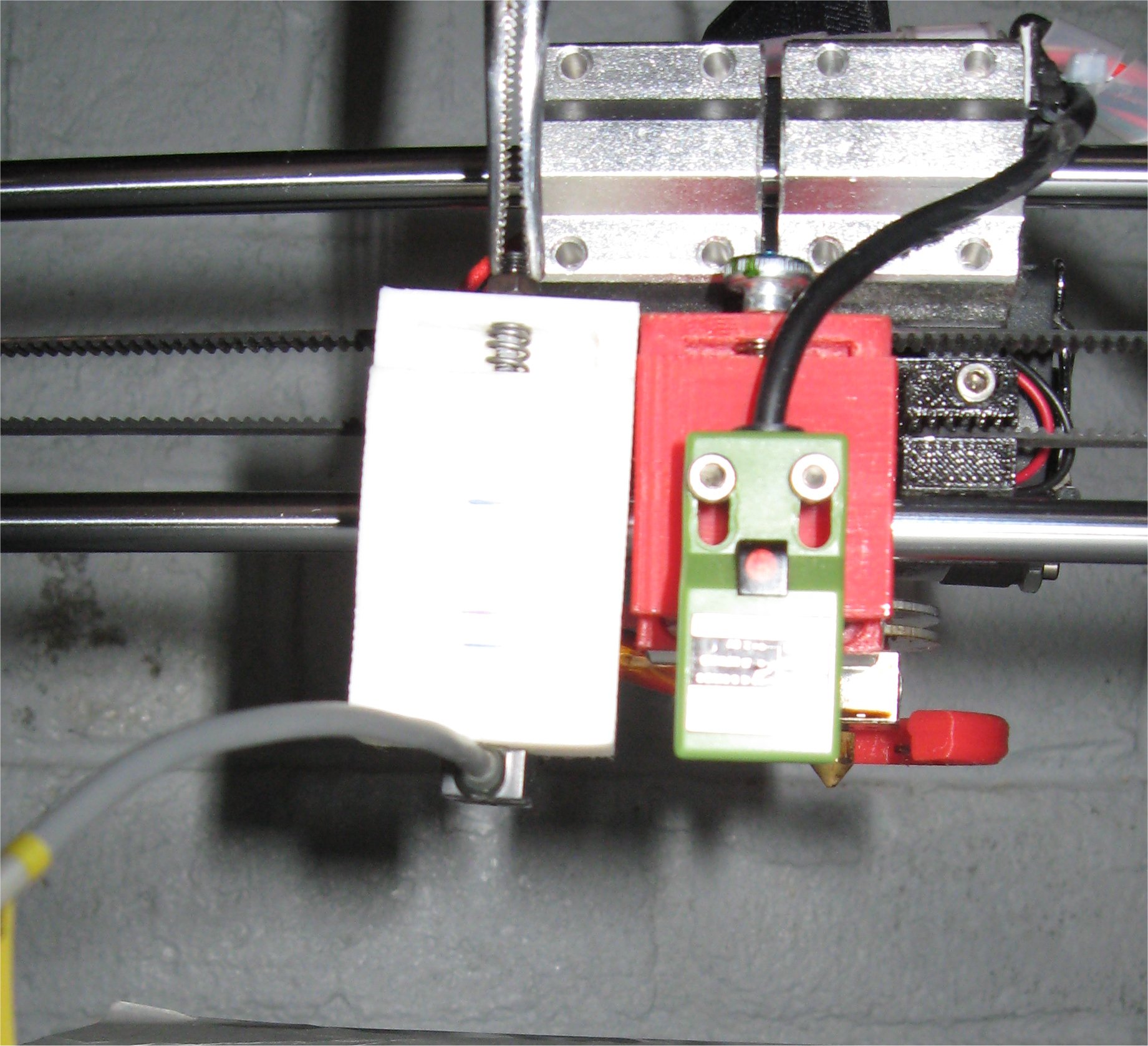

Before I used the Z-Offset under the menu control to set my offset, thought you can use by Specifying Z offset in Marlin firmware.
An adjusted the Proximity sensor height manually a real pain.
if you need to set a Z offset
Reset the existing Z-offset to zero M851 Z0 then
Z-offset (set by M851 Z-x.xx is needed to set the offset between the nozzle and the sensor trigger point (to the bed).
After I got good prints, my first model was an adjustable Z-Offset mount for the 3DP11/12.
spring loaded thumb screw mount
Though somehow could not figure out exactly how he got the screw and spring part to work, so I ran the screw in from the bottom
placing the spring inside below the thumb nut.
Will take it apart an post pictures if you need me to.
viewtopic.php?f=51&t=1768&p=16163&hilit ... unt#p16163

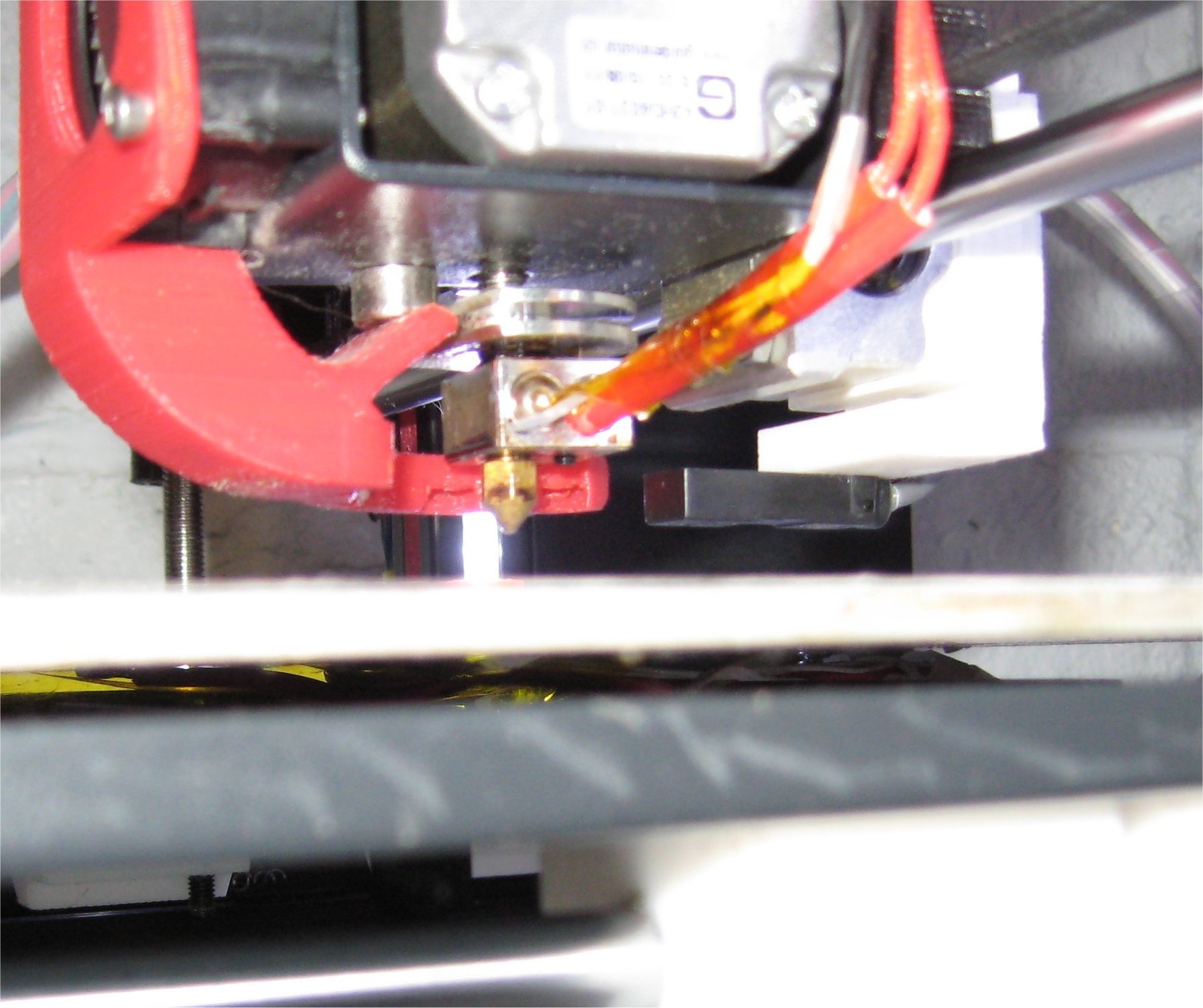

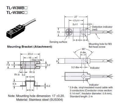

In link above have a picture where changed the SN04 sensor to a TL-W3MC2 you look in the Image on the white Mount you can see the spring.
The newer White mount allowed me to get the sensor with 20mm of the nozzle.
Oh!! Also added a Heat Shield as seen in image above. With a new duct work to cool the throat.

I started using this TL-W3MC2 because could mount it 20mm directly behind the nozzle.

There is nothing wrong with the Stock SN04-N Proximity sensor. Just 3D Print a manual thumb screw mount for the Sensor.
I hated it also that is the only reason I changed to the TL-W3MC2, you may not like this setup either though.
Note moved the Sensor to the side to be directly behind the nozzle.
An the Thumb screw adjustment for fast calibration.

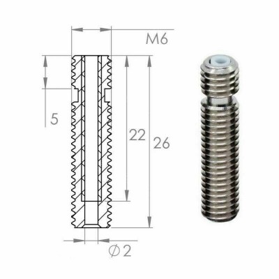

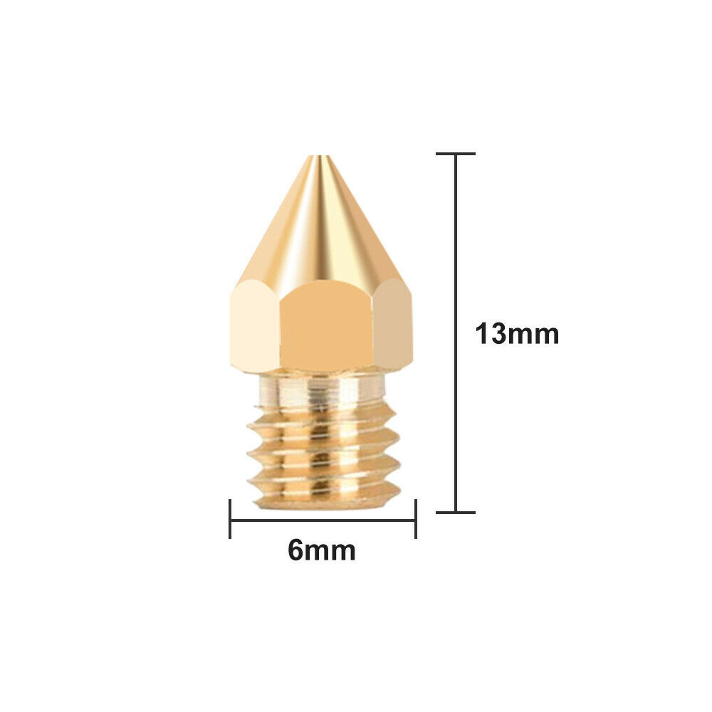

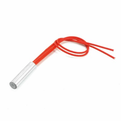

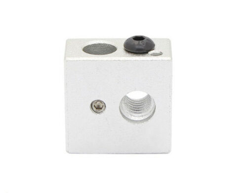

Do you have any of these consumables for your Hictop 3D Printer.
Throats, Nozzles, Heaters, heat blocks and Thermisters
Heater Block.jpg (8.64 KiB) Viewed 25085 times
Ellou
Posts: 21
Joined: July 23rd, 2020, 2:20 pm
3D Printer(s): Hictop 3DP-12
Re: Hictop 3dp-12 help
Post by Ellou »
Throats, nozzles, and heat blocks yes.
