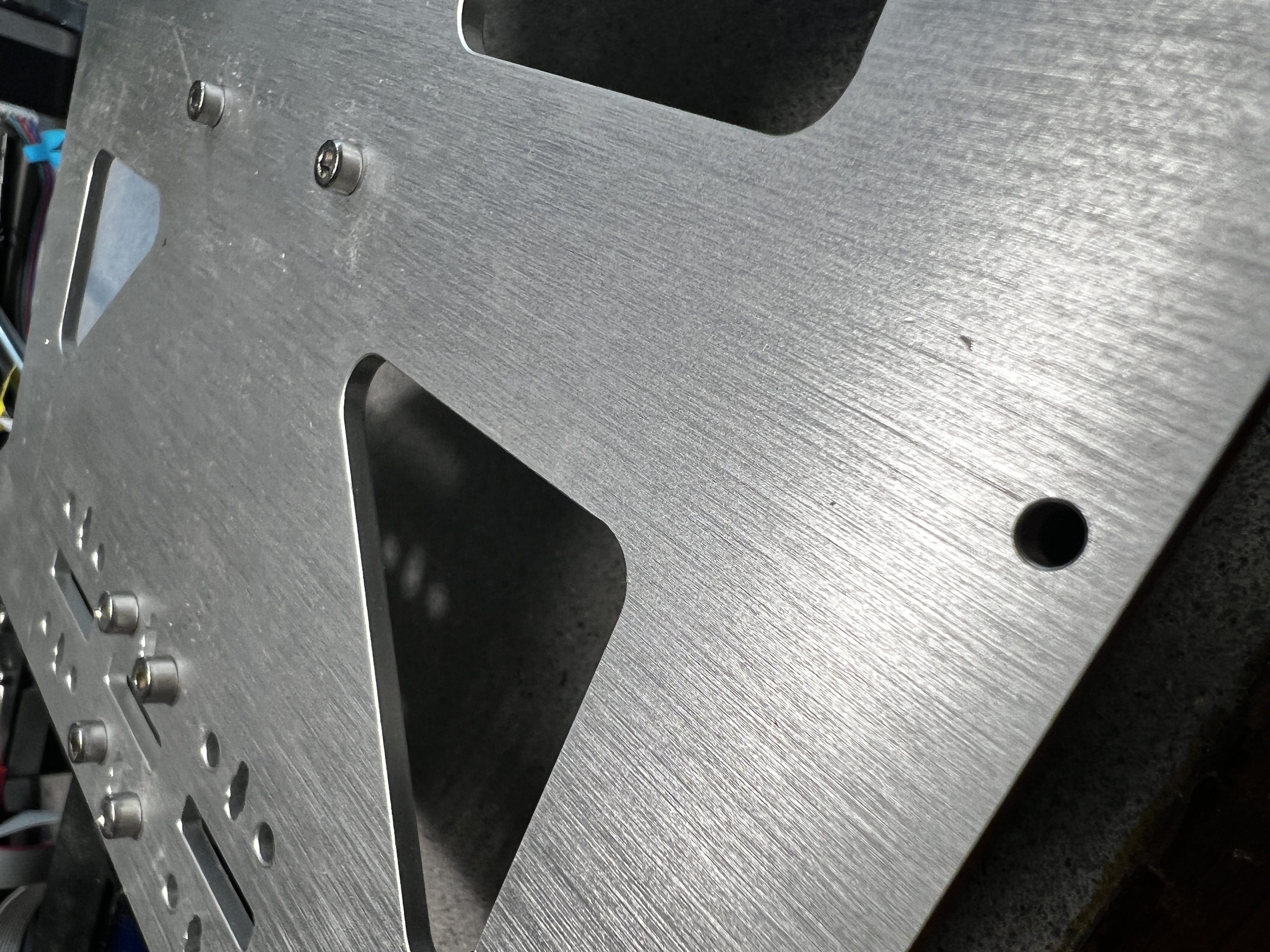

My list of things to change:
1 - Change bearing blocks back to 3 - Done.
2 - Install upgraded base plate - Done.
3 - Install a BL Touch to replace proximity sensor. - Pending.
4 - Install PEI sheet on bed after BLTouch install - Pending.
5 - Change firmware to make new configuration work.
The learning curve for editing the config will be large. Health issues kept me thinking of other things.

I have been using 4 Bearing on all three of my Hictop Printers with no problems, wonder why you are having problems?
Would like to see your upgraded Base plate, please post more information.

I will take a picture of it before I put the bed back on. The 4 bearings made me pretty salty. It just never printed anything good after I changed them. I have been testing everything as it sits and it appears that my proximity sensor is not stopping the nozzle. I am not sure if it's the board or the heavily modified firmware I created a couple of years ago. I am probably going to stick the stock firmware back on and make sure the printer is functioning before putting the BLTouch on. It arrived today and the mounts are all printed. It's been sitting so long that the hot end smoked some dust off of itself. XD
